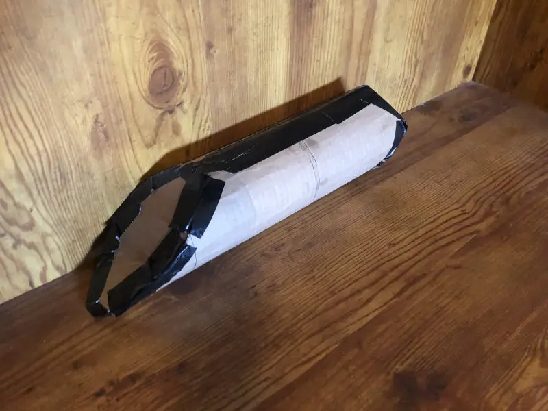

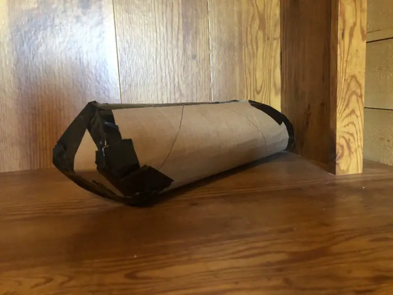

Mocked up a gas tank out of cardboard last night. Still researching whether to use a sealer or a plastic insert.

I use POR15 sealer on all of my gas tanks. Good thing about it is it’s impervious to Ethanol. I restore old hit&miss gas engines as well and I’ve used it on every thing from galvanized metal, copper, cast iron, brass, aluminum and plain sheet metal. 3 part process, wash, etch and seal.

Have you used KREEM? I see a lot of people have used that one.

Nope, never have. A friend of mine introduced me to POR15 years ago and we’ve both had nothing but great results with it, so I never felt the need to try anything else. Feel free to use any of them, but I would get recommendations from people who have used them as to their results.

I wondered about a plastic tank encased with a metal cover. Unless old gas gummed up nothing inside bad as plastic does not create metal flakes. The coating stuff maybe easier though.
I agree, a tank sealer is the best route to go. With a trap door on the tank a plastic insert would work. This tank is going to be simplistic and a cylinder. This is my first try, and it may take up to 2 or 3 tries but I want to make it look somewhat realistic.
