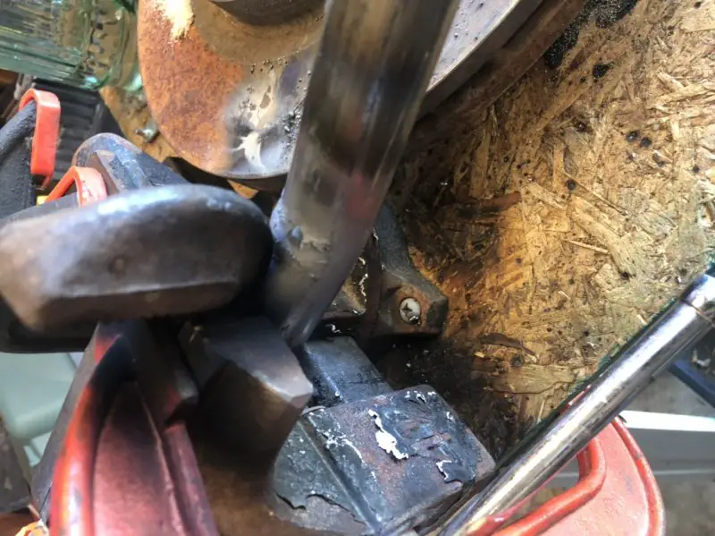

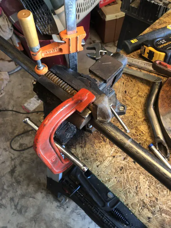

Got my chromoly tube!!!

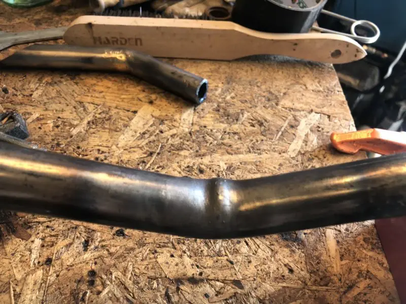

Lol ok very primitive and I still got 2 small creases. Not sure whether to work with this piece or try to bend another. Have enough pipe for another try if I like.
