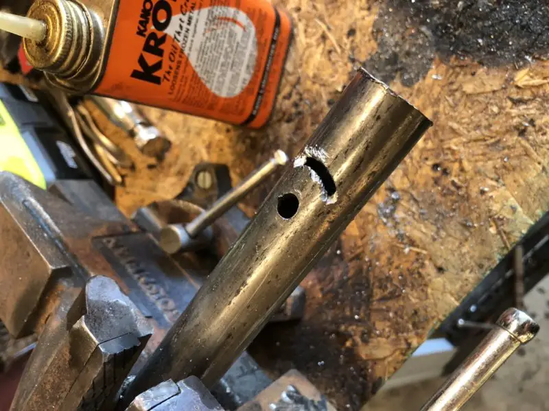

My problem was I was drilling angles and a quarter inch pilot bit was still trying to cut through the bottom of the tube as one side of the hole saw started making contact with the tube. That’s what snapped a couple of pilot bits on my hole saw.
And I agree I quit applying so much pressure and let the drill do a little bit more work for me.

You are correct in the angles and using the hole saw. The o my saving grace is the Pilot joke once drilled keeps things alighted fairly well.
Hate to say this but my drill press is in storage as well. I notched these with a hand drill. Crazy but it worked...

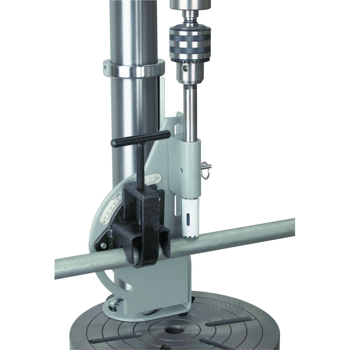

You might try using one of these. I've borrowed a friends and It will hold tubing firmly at an angle. If no one has mentioned it cutting oil is a must to get easy cuts.
Steve.

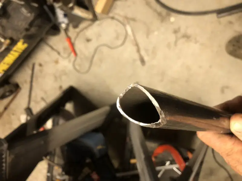

Well I happened to pass by a local mom and pop HW store today and bought another hole saw. Let’s just say these angles I am trying notch now will have to be done differently than a hole saw. The first two were not that severe. When I tried to go 45° the bit just couldn’t take it.
So between my angle grinder and a cutting wheel for it, it’s gonna have to get done that way.
Here’s as far as I got before the hole saw started failing. I was probably pushing to much. Live and learn

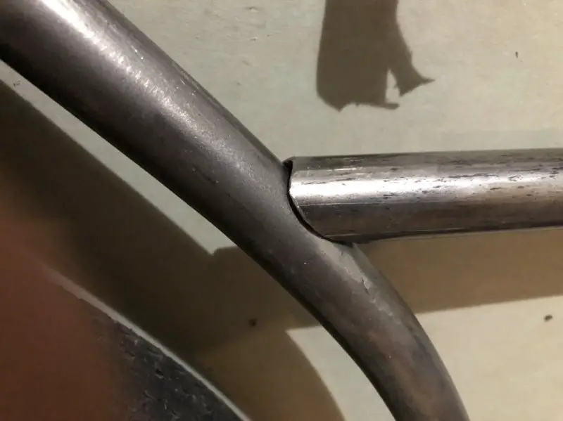

So I made a little more progress tonight and notched one side of the bottom tube. Came out pretty decent, a little more cleanup and we will be good. And as I already said, it’s Sheetrock weekend so the bike will have to wait til possibly Sunday evening for more progress.
Here’s what I did tonight.
