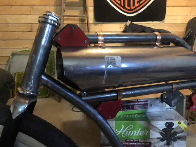

Progress!!!

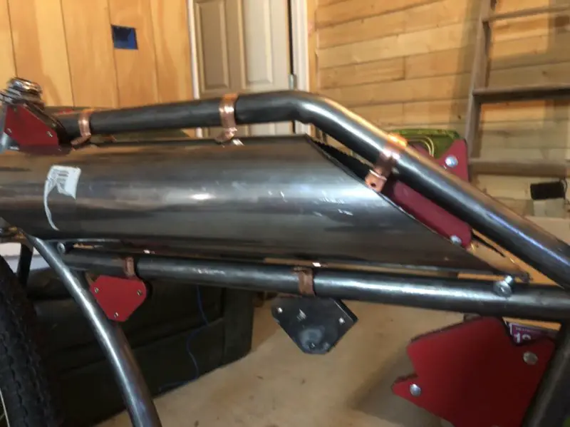

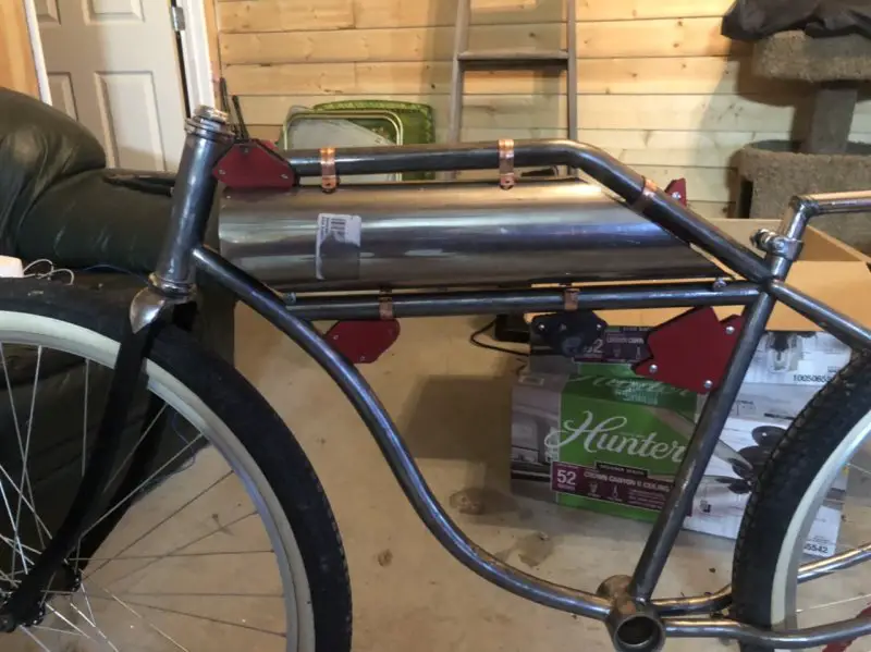

Probably need to cut the back angle on the tank just a light bit more...
Held together with magnets lol
Gaps are slightly larger since I noticed the bottom pipe slipper a bit before I grabbed a picture
Very nicely done. Gas tanks are not easy to do. The bike will be a stand alone classic.
Thanks so much, but I’m only part of the way on the tank. I will be practicing my welding and finding the sweet spot on the power. Have some left over exhaust pipe to practice with.

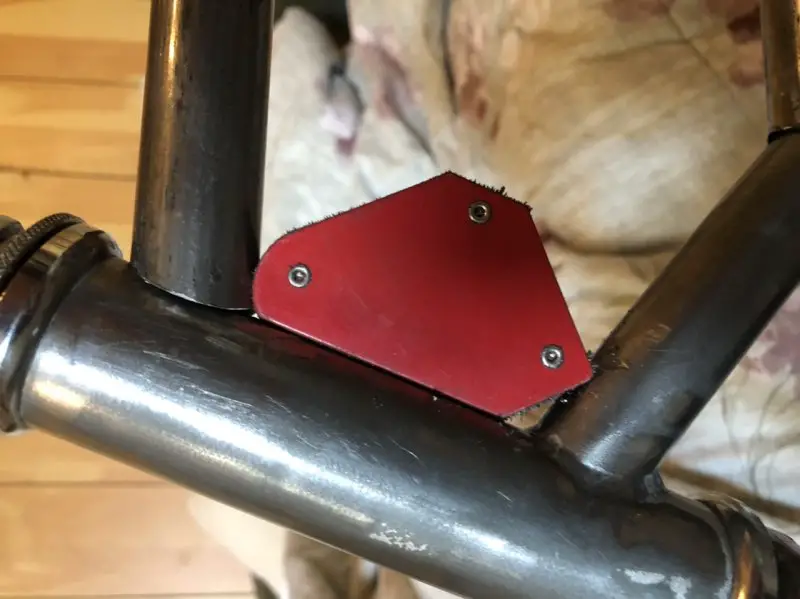

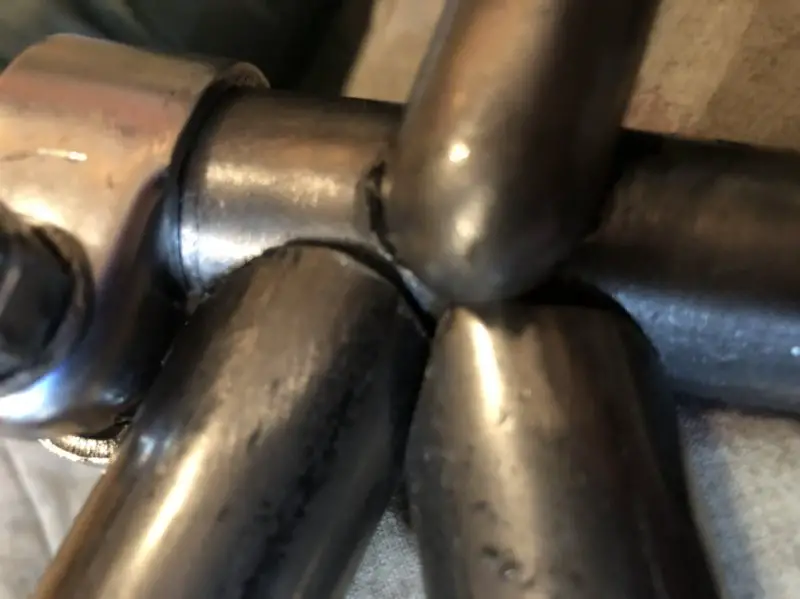

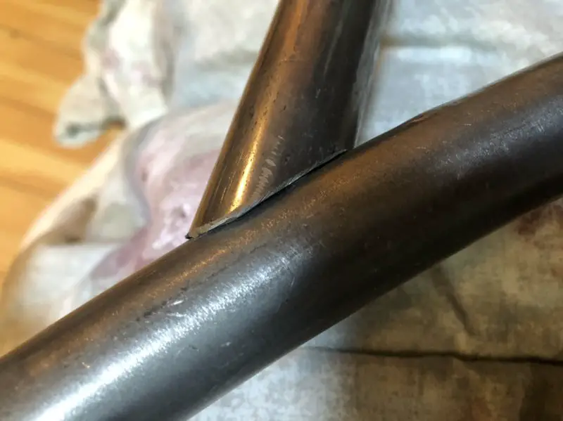

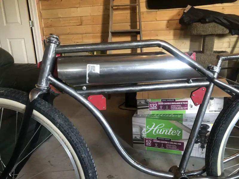

Used my angle grinder to get closer tolerances on my notching. I’m ready to begin brazing except for the new forks. Upon closer inspection they are 1/2” taller than what is on it. I will wait for the forks before beginning the brazing.
On a side note, I also picked up some 16 ga sheet metal to use on the ends of the gas tank. Tank/pipe is 14 ga. Anyway, welding practice is coming along. Not pretty in places but that’s what practice is for.
This site rotates some of my picS, don’t know why

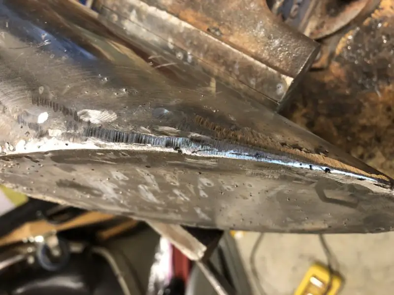

So welding doesn’t look great but the grinder can fix most of that. Do have some pin holes, can see them when I hold it up to the light. Gonna continue the practice and see if I can seal most of them.
Here’s a little practice piece

After 2 welding sessions and 2 grinding sessions I can still see 6 pin holes with a bright light. Welding session 3 coming up.
this is my practice piece but I’m starting to get it.
