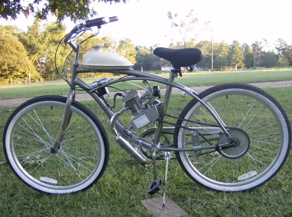

  12. Al.Fisherman
    Al.Fisherman New Member
    Joined:
    Sep 9, 2009
    Messages:
    1,966
    Likes Received:
    There is no requirement for a chain tensioner if you can get both chains within tolerances.
    This is not mine (I built it) but the same frame and set up.....
    [​IMG]
    There were issues with the chain hitting the frame where the tensioner is mounted. We have since modified the tensioner mount.
