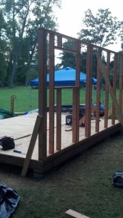

Got a wall up. Well just the framing. Was kind of an accident. I just wanted to put it upright then beat it as the plates were so twisted hit one end, the other end would pop out. But got it leveled & plumb so just left it up and braced. Was heavy enough with out the 4 sheets of siding. Gonna get the side 12' wall up tomorrow. But supposed to storm here for the next couple of days, yay. But want that wall up to help secure.

Tried to scan and post the wall plans. No second 2x4 top plates or reinforcements on top or below windows. The trusses only top the studs on the rear wall and are all over the place on the front. Gonna add 2nd top plate 2x4s, reinforce the windows.

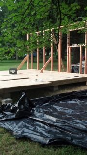

Will post a pic of finished framed walls.
Not putting on the siding until walls are up. Prolly should have. they are pretty heavy. Hold one side and nail the other......
i hope you are squaring it and strapping it diagonally at least.
the walls get tough to square if you start nailing the walls together.
Dan TJ is right, I like to square the wall then nail on one sheet at the corner. This way the wall is not that much heavier.
Hmmm, just squared em. Put em up and checked levels.

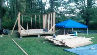

Fun day yesterday. 4 jobs and really like new design.
Excellent progress! Thank you for sharing the picture.
Looking at the rear wall and right wall I am surprised to not see windows. Getting cross ventilation through the room sure would help with cooling on hot days, unless you are going to have air conditioning in it.
Say now, that blue shade canopy is awfully short. You actually fit underneath it without ducking your head?
