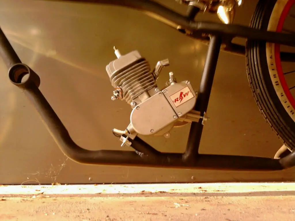

Hey flybytaco, your chain tensioner on the OCC is backwards, you are attempting to pull the chain off the rear sprocket. Should be pushing up on the bottom.
Just a thought, good luck with it.
John
its on the bottom so the chain doesnt hit the frame and it worked just fine the bike is built and already sold it for 8 bucks thanks tho

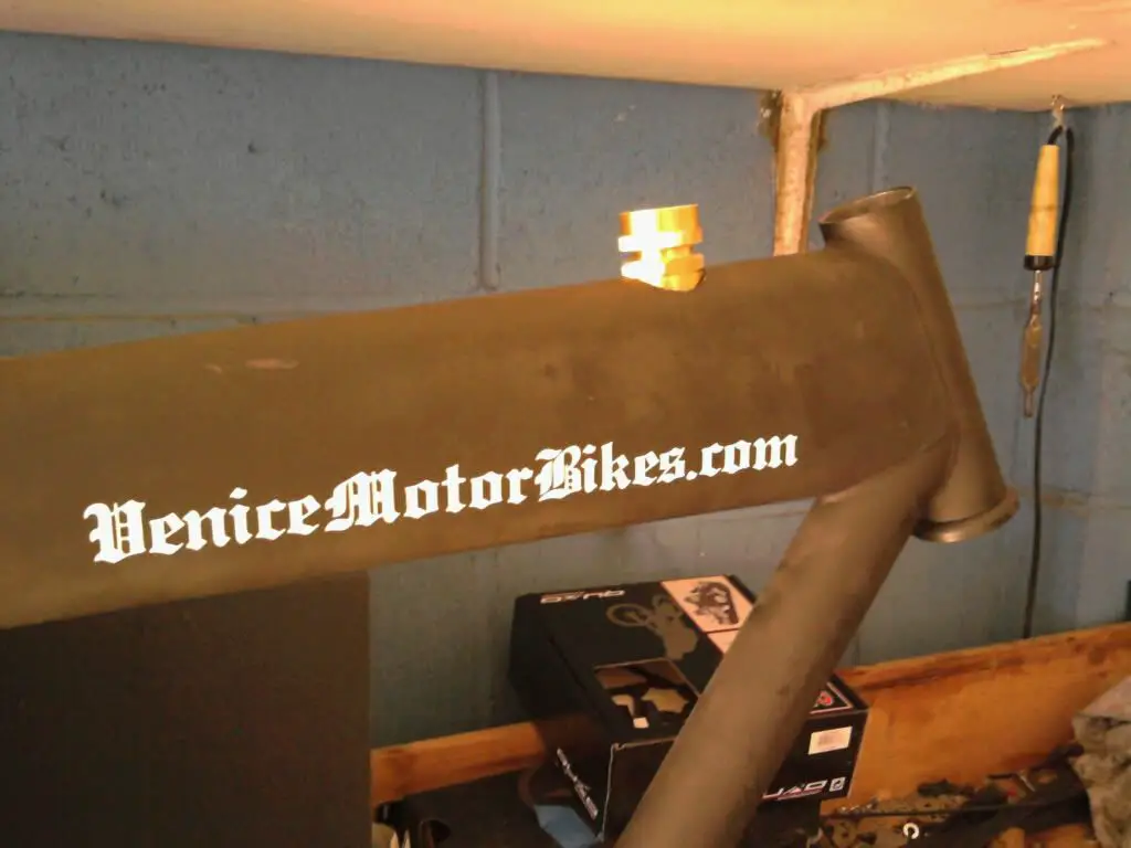

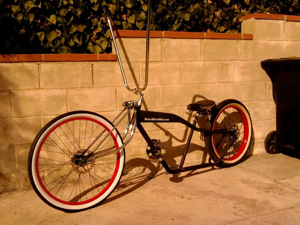

heres a pic of my brit style tag, pics not to good, looks better in real life.

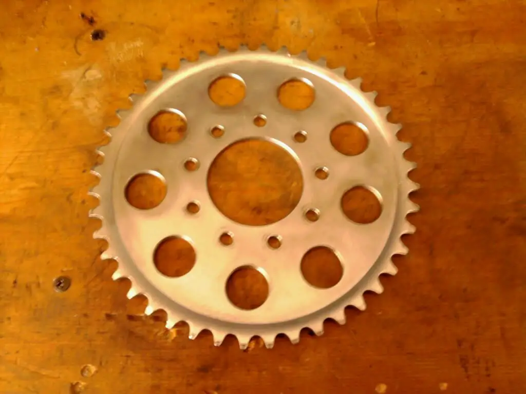

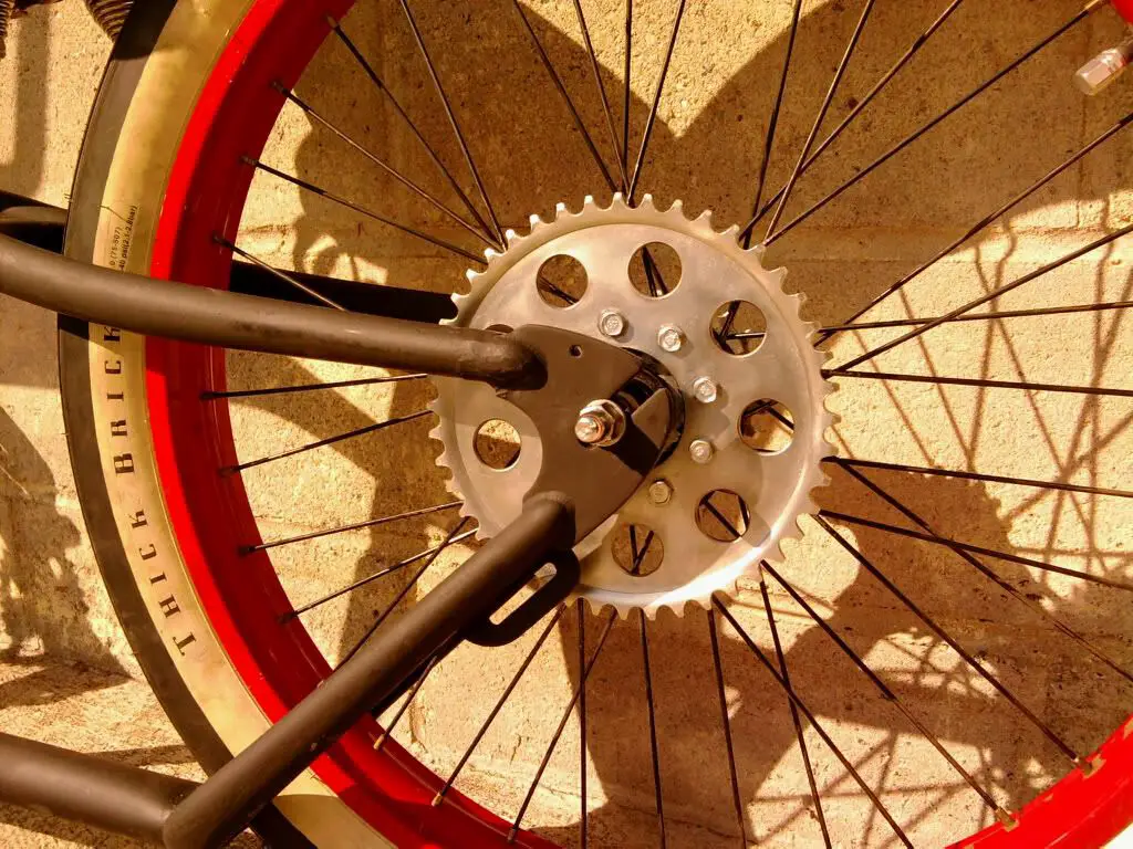

I finally got my sprocket done, now I can start figuring out how far I need to offset the engine mounts...
Much thanks to Jeff (culvercityclassic) for machining the sprocket for me!!
Also, here's another pic I took today... I'll work on the new seat tube & engine mounts tomorrow.

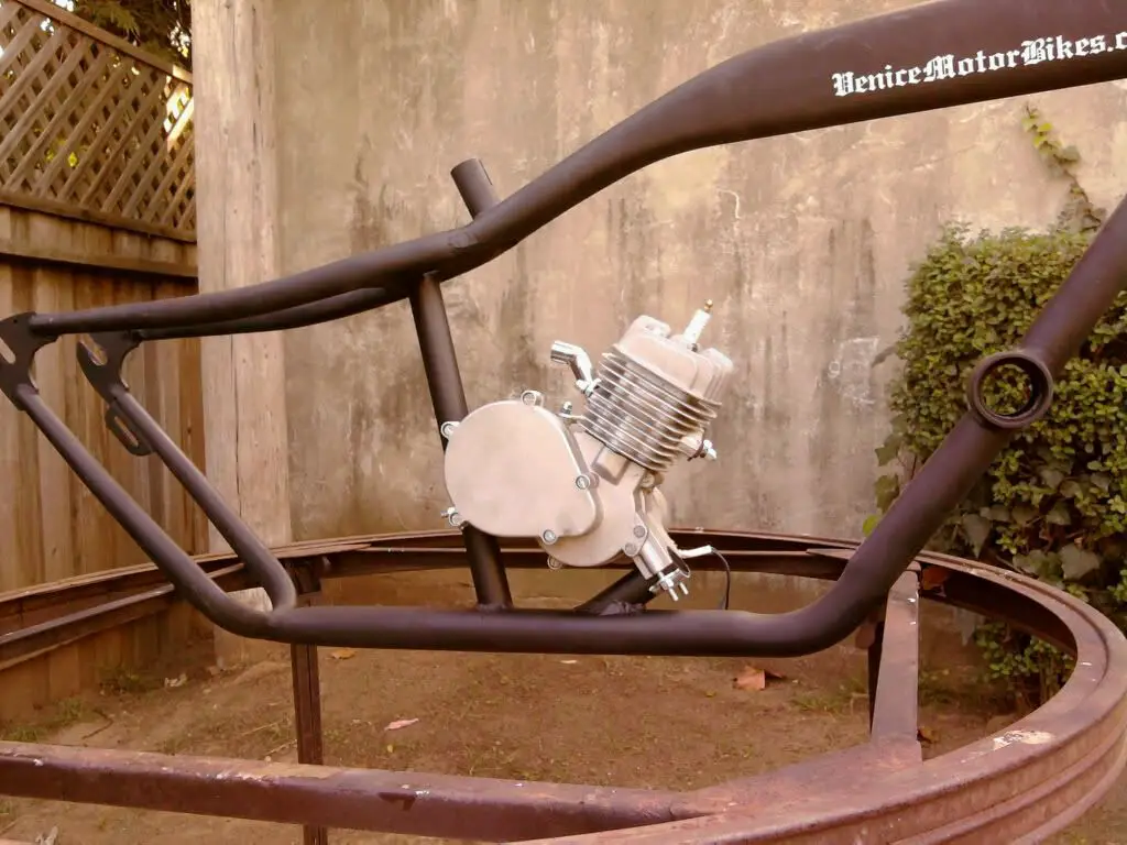

I went out today & disassembled the bike to start on the engine mounts & in-frame gas tank... I bought a bunch of stuff for it, but I didn't get much actual work done!
Tomorrow, I'll try to get some welding done!
Here's some pics of todays progress...
I cut out the seat post tube & made a new one a few inches back & also welded on a front mount.
Both mounts were offset 9/16" for tire clearance.
Where are all the other builders??? Why aren't they posting anything??? :-{
Here are the only tools I used to modify the whole frame... A $70 mig welder & a grinder!!

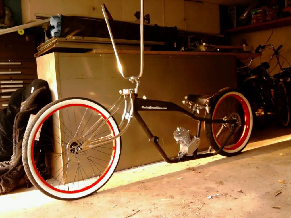

heres the color for the bike, still have to clear coat it yet. should have it done in a few days, hope it's not snowing by then so i can ride it.
