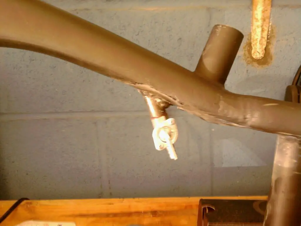

I finally finished the in frame gas tank today...
To tell everyone how I did it, I sealed all the holes in the frame with JB Weld, then used JB to attatch the filler cap, & MIG welded the outlet tube to the frame & sealed it all with Kream tank liner.
Now all that's left to do is smooth all the MIG welds on the frame, repaint it & start the final build!!
