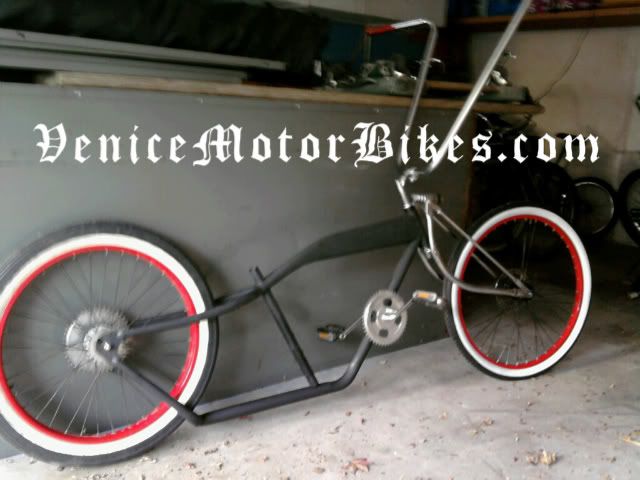

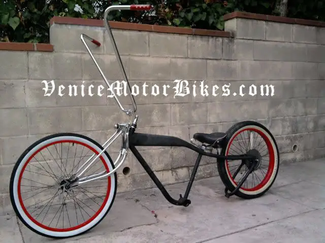

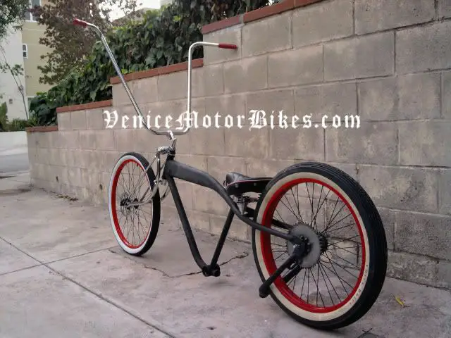

Hey V.B. I worked on my exhaust today. Built it out of some old cut up handle bars. It tucked up there pretty sweet, with an 1/8" to spare.

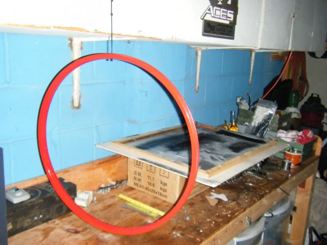

I got a few things done today. I took apart the front wheel & painted it to match the rear one.
I started to make the front disc mount & I went out & found the correct size steel tube to rebuild the lower half of the frame.

What is the height of those bars? Those may be the tallest I have ever seen.
John

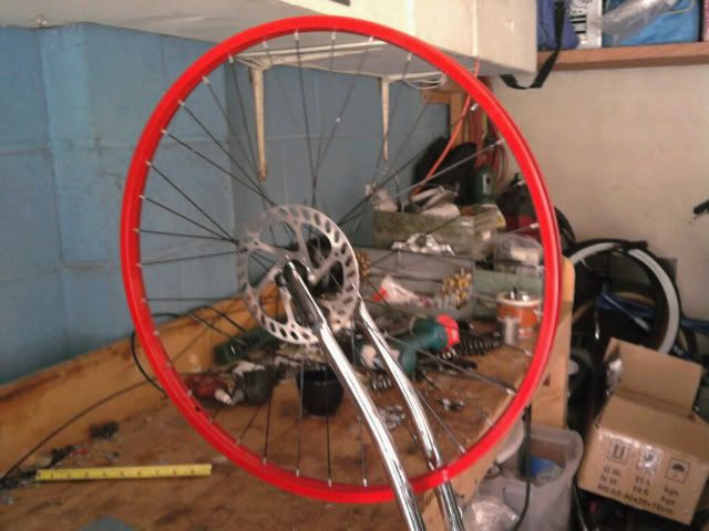

Here's another pic...
Here I have the front wheel & spokes painted & ready to put back together with the disc brake hub.

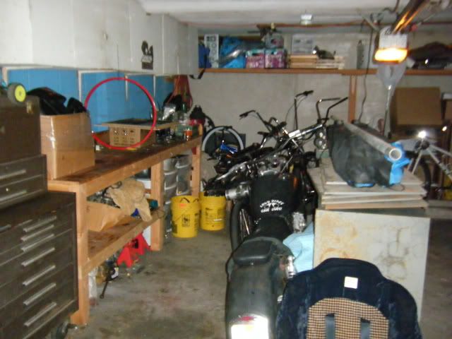

Here's my little work space. (the right side belongs to my neighbor.)

Here's todays update...
Here's the front wheel all trued up and ready to go!
Here I put the wheel on & rolled it out for some quick pics... I sure wish the other builders in this build off would post some real pics!! :-{

O.K. After seeing that wheel I am going to have to give it a try. That is the one thing I haven't done is lace up a wheel. V.B. What size is that back tire? That's looks wider than the one I am using.

Also... to answer John's question, the rear tire is a 24X3.0

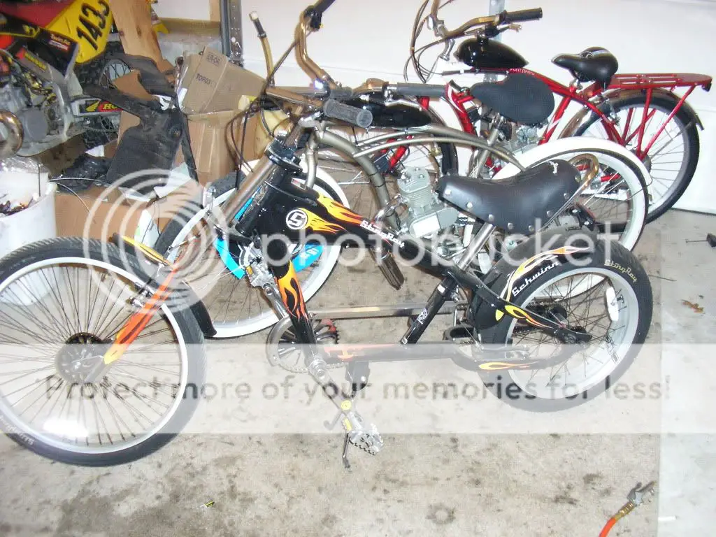

This is a picture of the bikes being test fitted.
utf-8BSU1HMDA2ODkuanBn.jpg picture by 247jude - Photobucket
Ok this is where I am currently, just test fit then the cut and welding begins
utf-8BSU1HMDA3MDEuanBn.jpg picture by 247jude - Photobucket

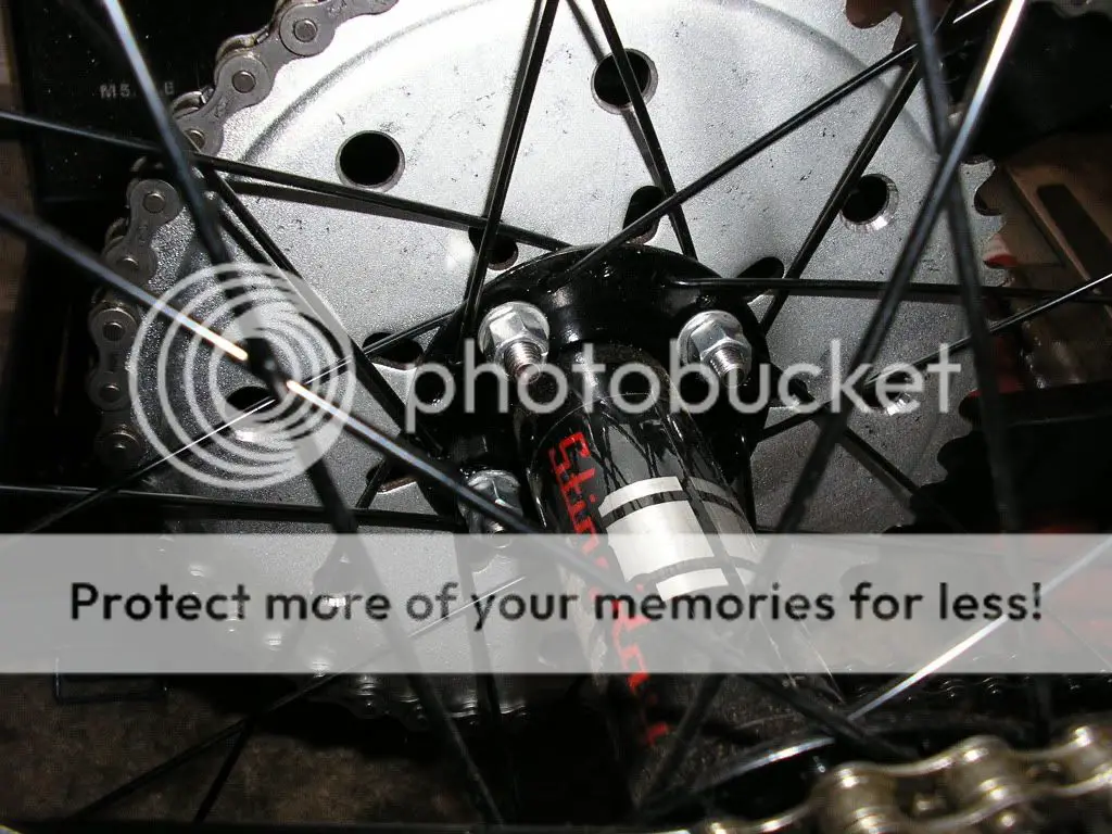

Nothing major to report today... I sealed up all the holes in the frame with JB weld so I can seal the top tube with gas tank liner. I also started prepping the rear wheel & drive sprocket to be mounted. (the sprocket needs to be offset to clear the wide rear tire.)

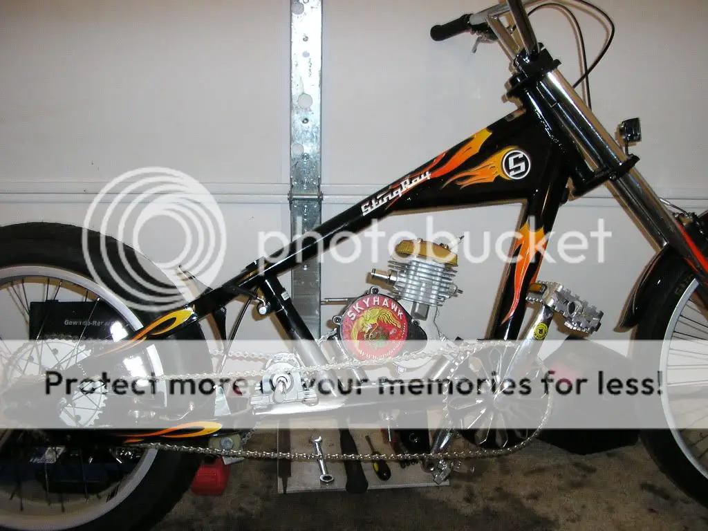

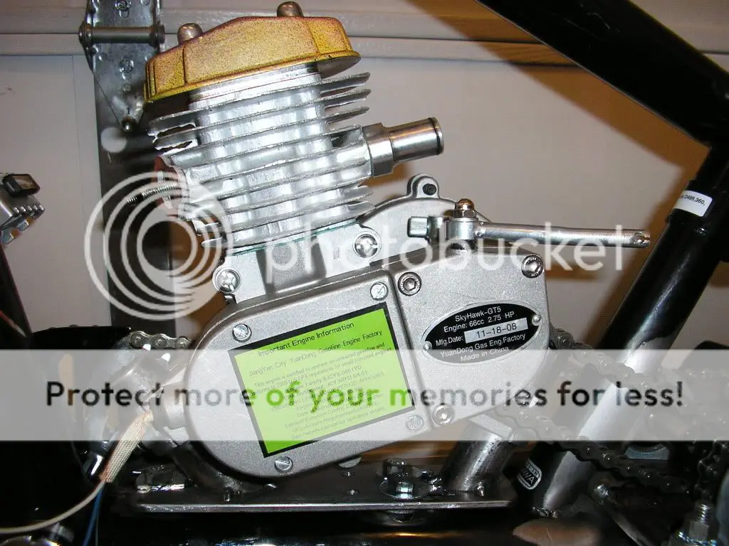

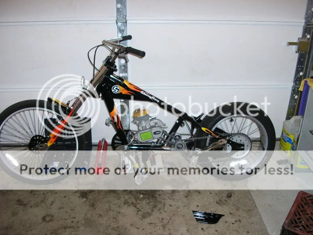

love it cam!! I see you are in a body shop? ok so I spoke to fairracing31 and told him I was entering my new stingray chopper so here it is. I know it's not toatally original but it's been 15 hr days 2 days in a row for my fabricating and its all home made minus the kit and the jackshaft parts but I engineered it all lol
the motor is a gt5 with pk slant head billet intake and gen 4 pk muffler

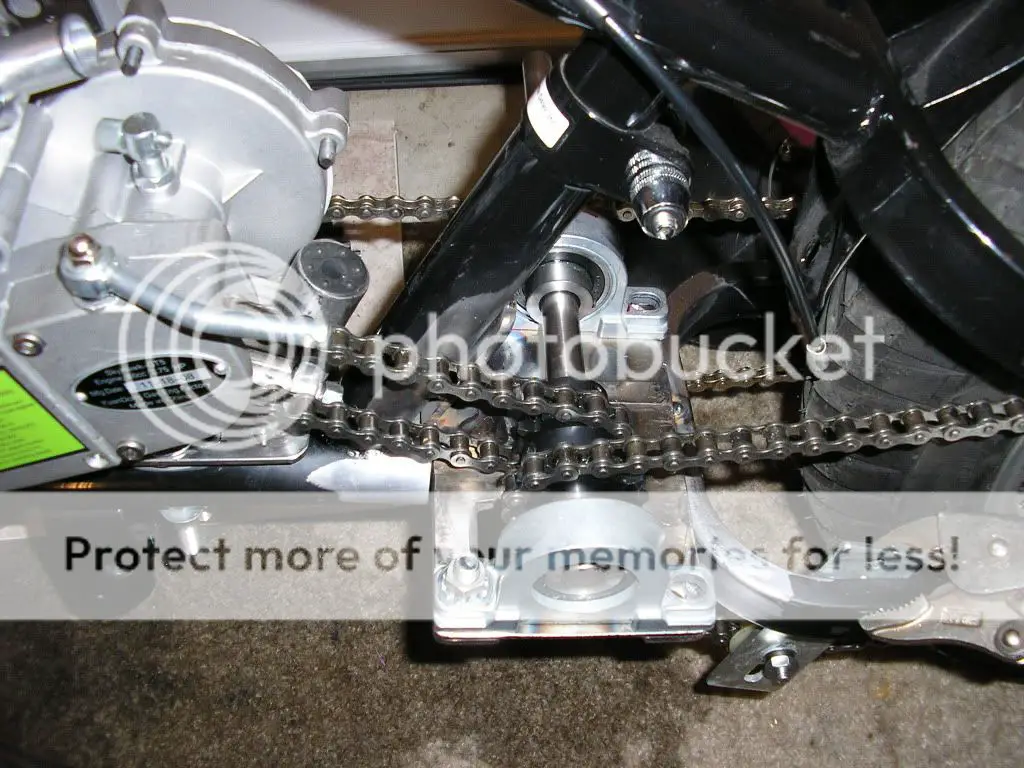

here is a shot of the jack
and a side shot more to follow.
this is how I mount the sprocket
