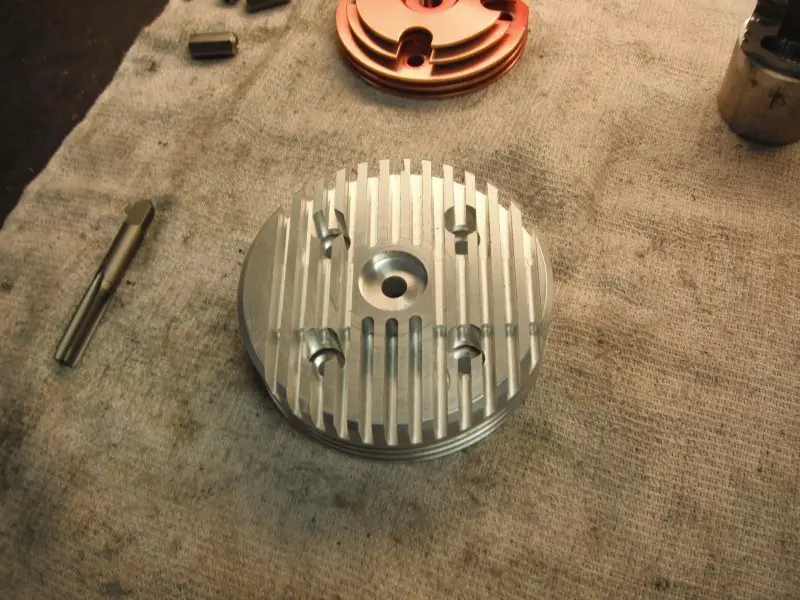

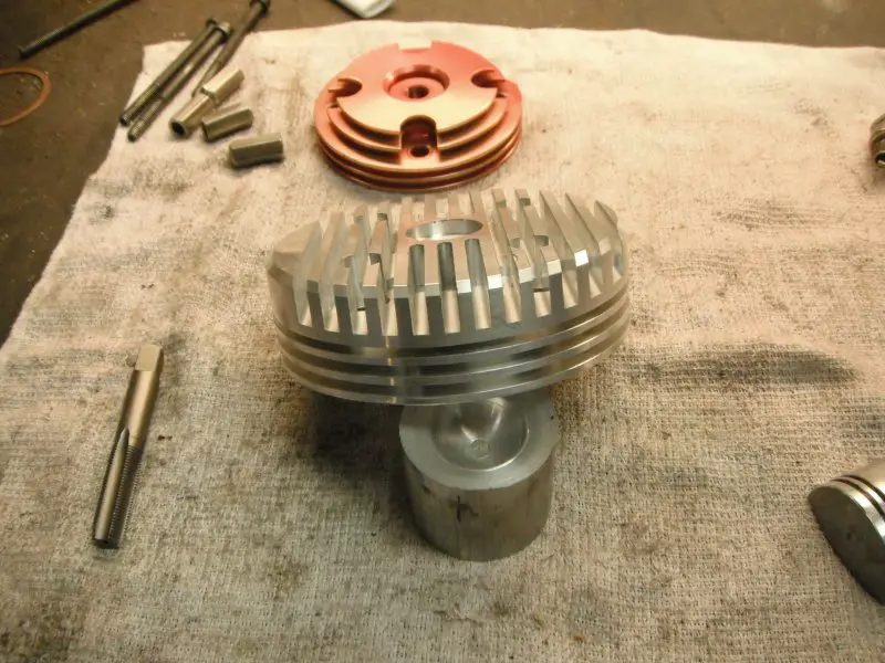

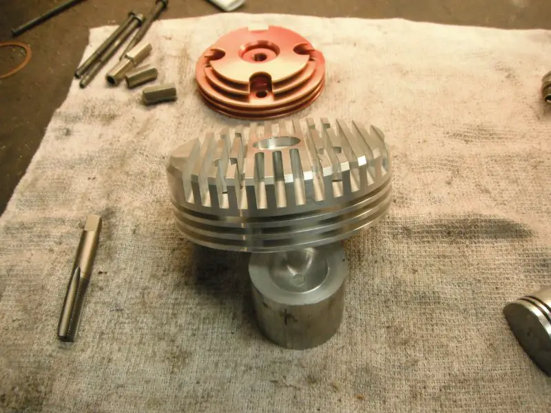

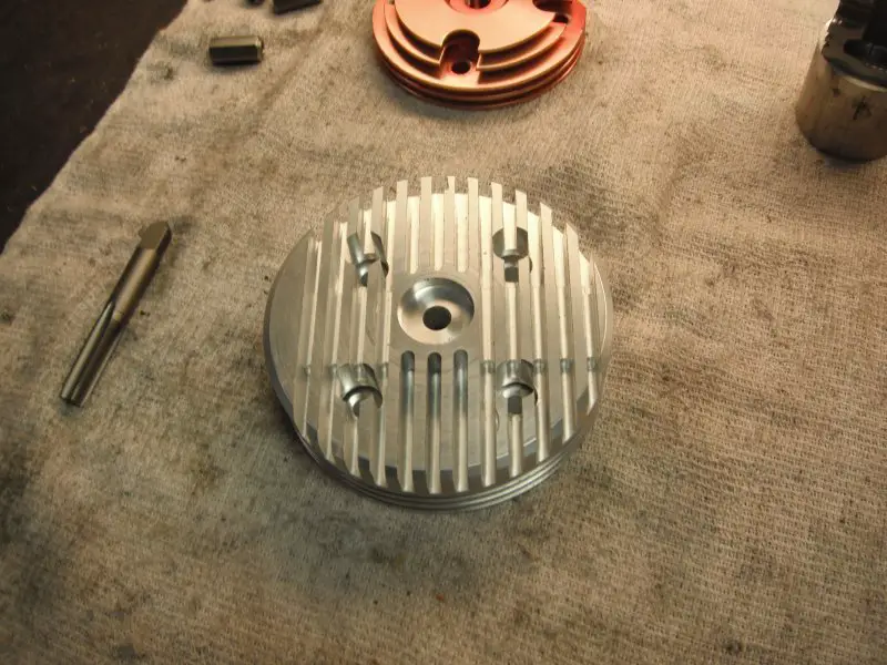

I've been nibblin' away at this cylinder head. 10 thou at a time and it ain't all that bad. I get into a zone I call being "One with the Machine" and the time just flies by. What I have to be real careful of is getting zoned out and cutting too far!
But I do have some issues to still work out.
One is it's missing a slot. I couldn't reach it! The Y axis bottomed out before I could get there. I'm gonna have to clean all the aluminum snow off the mill and remount the mill vise to get that one.
At .140 wide the fins are too thick too.
The fins on that head in the background are .090. The cast fins on the cylinder are only .050. So I'm calling this just a rough cut. It still needs some trimming.

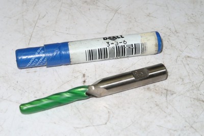

Something I figured out along the way is the .155 endmill I used is way too long. It has a 1' reach and I only need a half! I'll betcha a shorter cutter would've got me a lot closer to the .030 cuts Tony was talking about ...
