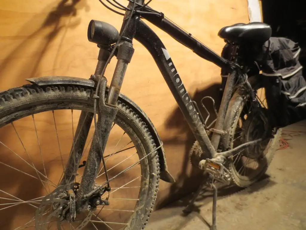

To a point, true - however I wished to illustrate the reasoning for having fenders rather than another post without & as the ebike gets the most of the sloppy abuse, those where the dirtiest pics I had... of bicycles... that I could post on the forum...

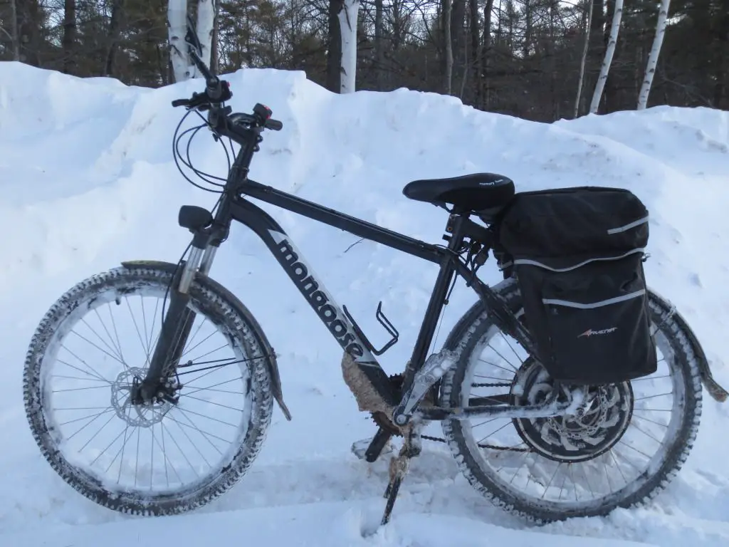

I run both front and rear fenders with factory braces but have reinforced them with stainless rods as well as fitted nilock nuts with a rubber washer to prevent vibration , seems to have done the job quite well , I see the reasoning behind doing this though as within the first week 3 of my fastenings on my rear fender had come loose and fallen off ,I didn't even notice they had done this until I pulled up home and my wife pointed it out to me
