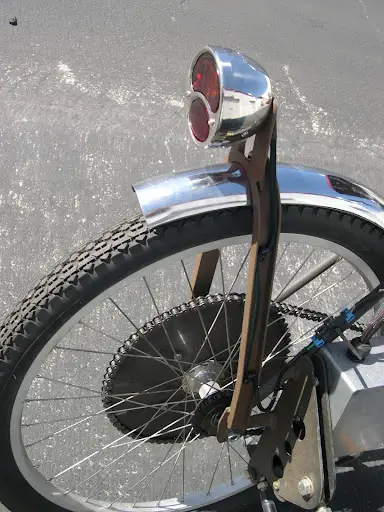

After Bairdco's tale of woe, I just went for the overkill fender brace
Hot rolled channel bent cold.

The rear fender was laying in the street thirty feet behind where me and the bike came to rest. See photo. Obviously it was the culprit.
Some post crash forensics revealed that: 1. The rear fender came loose and rotated around the rear tire which instead of rubber against the road I slid on the steel fender. 2. My knee broke the clutch lever off at the handlebar mount. There isn't s scratch on the lever so it didn't hit the pavement. My knee hit it and broke it and that's how my bone got cracked. 3. My helmet, a full face, DOT motorcycle type never touched the ground. It shows no sign of impact or scraping the asphalt.
Lesss than 24 hours and 6 miles prior to this happening I had spent some time going over this bike and checking for anything loose. I checked axle nuts, disc brake rotor and caliper mounts, engine mounts and....fender mounts and fasteners. 6 miles!
The rear fender mounted at three points. Two on the frame and the rear brace. The brace fasteners actually pulled through the steel fender as well as one of the frame fasteners. One frame fasteners is missing. Apparently it came loose, fell out and allowed the fender to swing sideways into the tire or maybe the chain and be pulled forward until it rotated under the rear tire.
