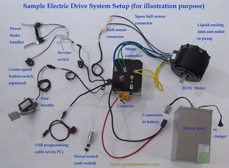

I also don't have any kind of instruction manual on wiring all the components together. It came with nothing. All I have is this low res pic.

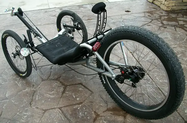

I will raise you one. Once I went over to large Marge Rims. The down hill stunt rims at 3 inch wide. Then got 24x3.0 tires on them.
Quote. regardless of the mechanical suspension, with 12 or 14 PSI of air in the tires has much the same effect.
You don't have 7 inches of suspension travel and run 14 to 20 psi!! Down side to my wheels tire changing is a chore that approaches on learning a new skill lol. Won't lie that part just sucks. Up side those beads will never slip on a Large Marge like this one.
Have to agree with you tho. There is nothing more plush to grab pavement and such with then a bigger tire. Road bike pencle size tires would be very bumpy. I draw the line at 2.7 size tires now just don't like the stiff ride and handling in a smaller tire any time I can help it.
For the record the hard tail bike I had that put the hurts to me was like 1.9 or so size tire max. Done with that'un forever!
