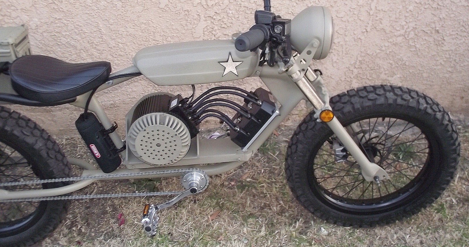

I was referring to close up side views of my bike while it is stopped at a light. It's a very busy looking bike viewed from either side of it.

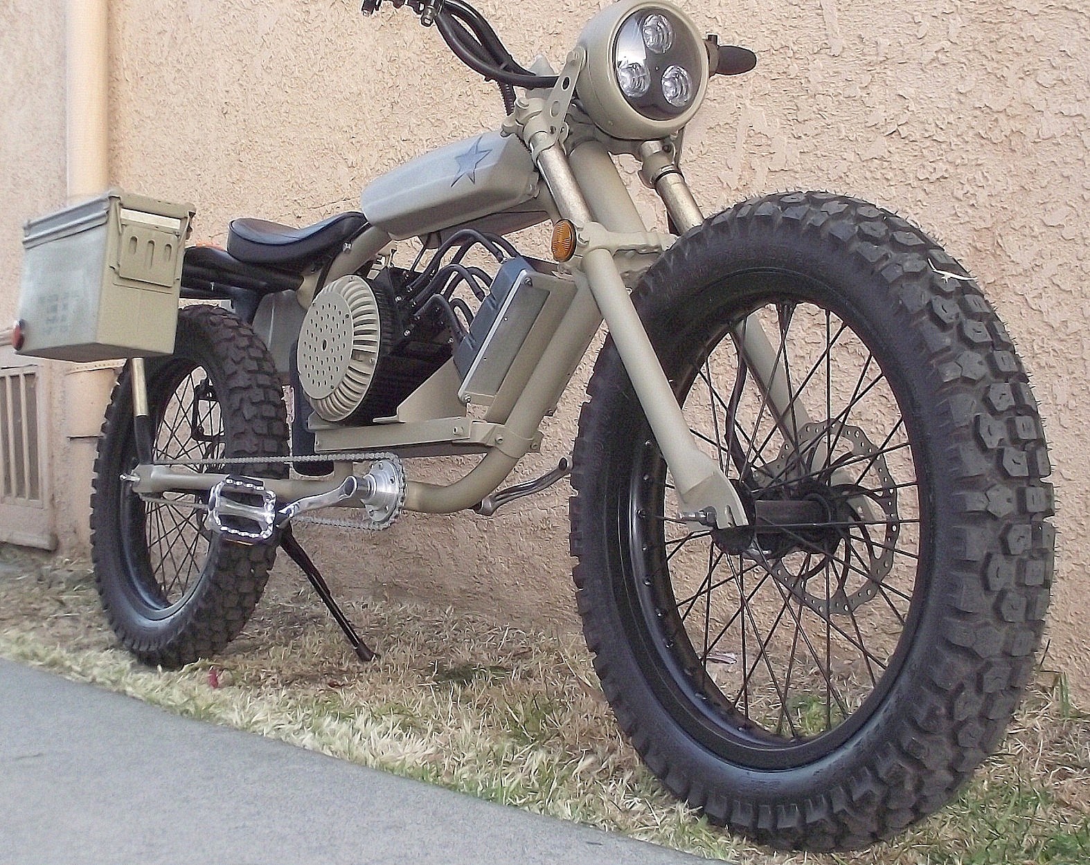

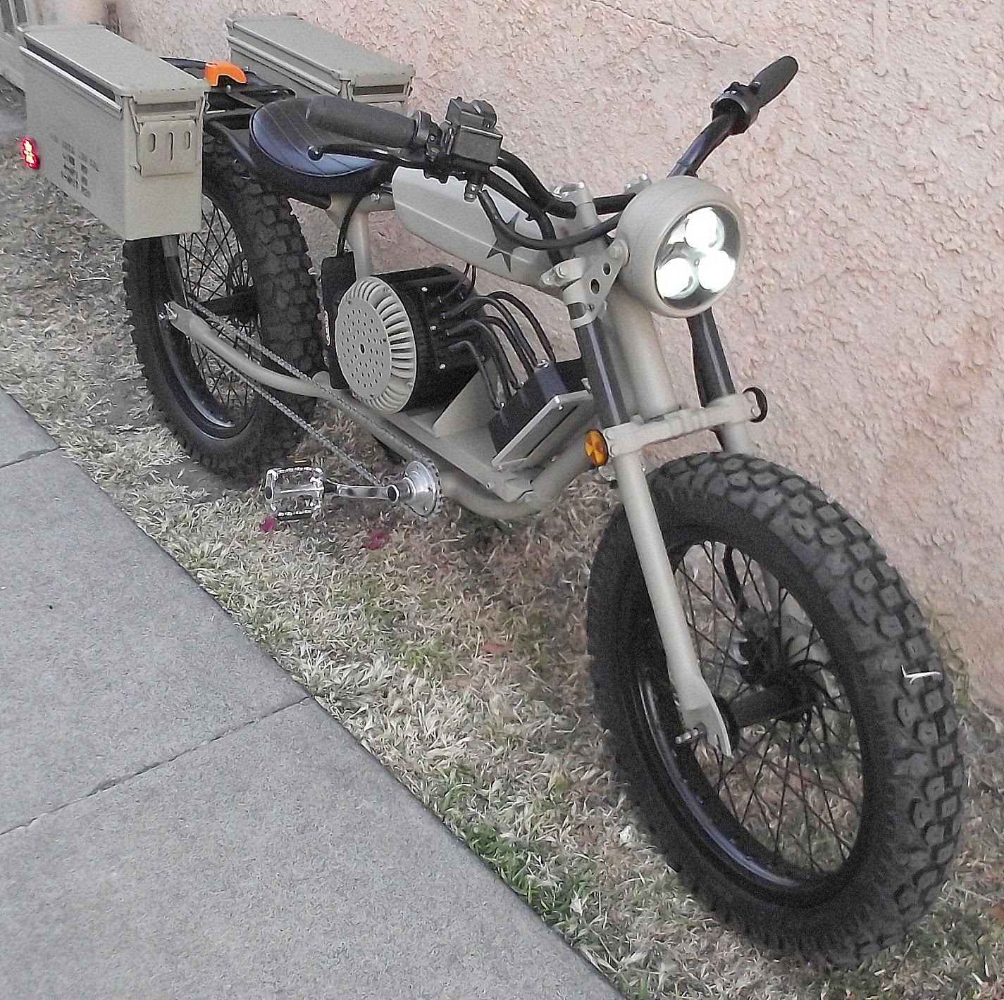

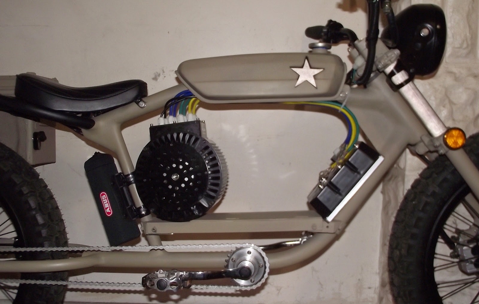

I'm gonna sheath all those colored cables in black and run them straight up and straight over, hidden under the gas tank that now has a purpose, thus eliminating the need to shorten those cables and re-crimp connectors back on to those cable. It's just not something I feel like doing. Clean and innocent looking is my goal. laff
Cost as shown (tax + shipping - my labor): $2600
Dropped Factory Max Phase Current from 300A to 200A and Max RPM from 7000 to 5000 in the controller. Motor efficiency just continues to nose dive beyond the settings I saved. I also increased Max Phase Currrent from 1 minute to 2 minutes.

The difference between Warp Speed and it's Constant Speed is the difference between 200A and 150A. 150A at lets say 84V (fully charged battery) is 12,600 Watts which is 17 HORSEPOWER (Maximum Continuous Rating). 20 HP for 2 minutes. Minimum HP before the batteries Low-Voltage Cutoff is 12.9 HP. Do you really need to go faster than 13 to 17 HP that the motor can constantly propel you at? I'm guessing that I won't. My balls haven't quite hardened to "Steel" status just yet.
Pretty awesome. Think it will hit 70?

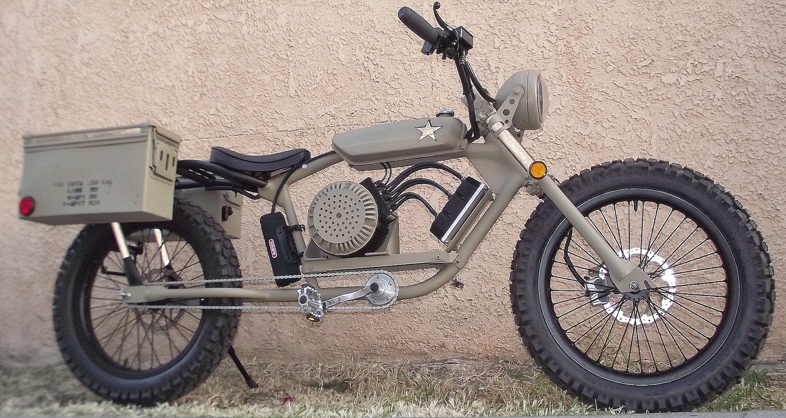

I'm gonna be disappointed if it doesn't do at least 70 MPH with that kind of force at the wheel. To say the least. I just need to nail down the right drive (motor) sprocket. The rear is a 72 Tooth, at the motor is 14. I have no idea what the right gear ratio is at the moment, but I'm gonna find out soon enough.
At 5000 RPM, I'm showing 75 MPH with a 72 tooth rear 14 tooth front and 80 MPH with a 15 tooth, 85 MPH with a 16 tooth....... based on 2 separate calcs I found online. 95 MPH at 6000 RPM (max motor RPM) with a 15 Tooth sprocket. Searing electric motor heat will be the ultimate decider in all the above so who knows, except that I'm gonna have to contain that heat somehow. That much I do know.

I think you'll find the limiting factor for how fast you'll want to go will be the ridged frame more than your motor. Your bike looks like it'll make a better long range cruiser than a racer. IMO your top speed will be around 30-40 mph depending on how tough your booty is,
No I'm only talking about how fast "I" want to go. I'm in no rush to get anywhere. I'm only care about the bikes top speed top speed on a flat smooth surface like say the 405 freeway for instance. This bike will set the new standard not only in the speed and 0 to 60 MPH acceleration category but also the range category. There's a new Sheriff in town, it's rotating at 6000 RPM and it's not taking crap from any other e-bike or gas bike for that matter. LOL

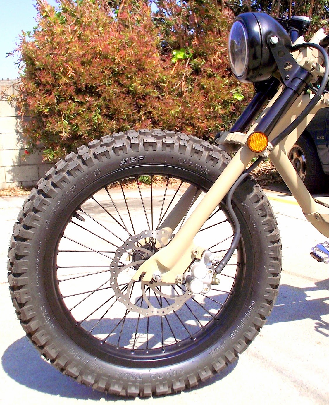

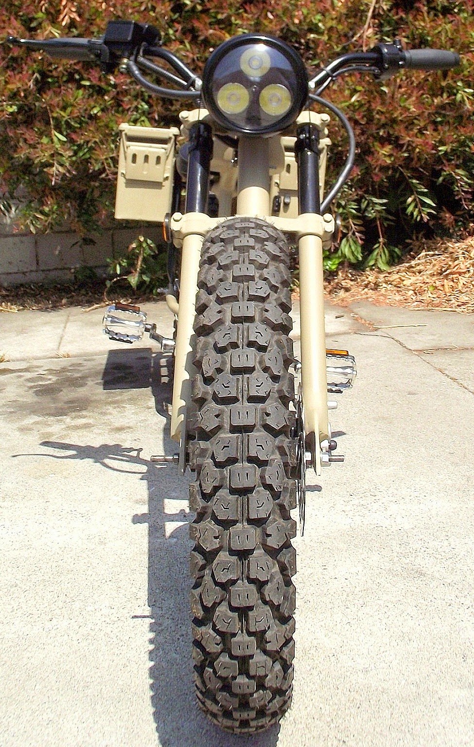

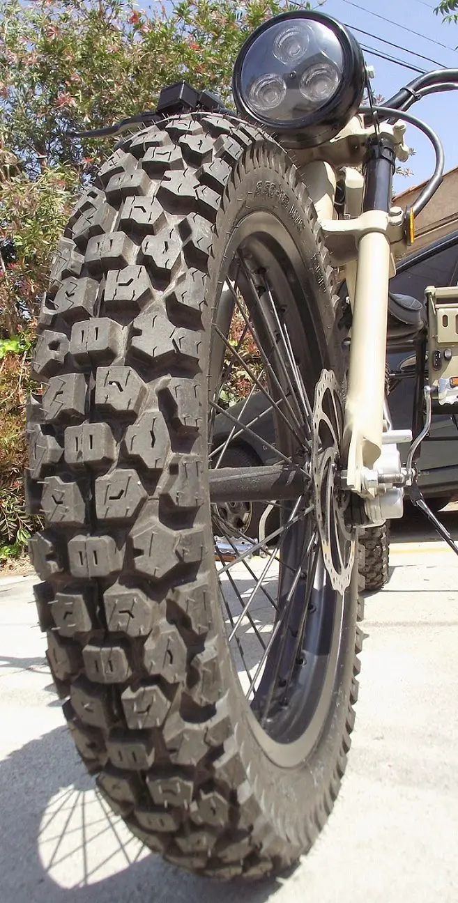

I will happily take 60Ah of battery range over a rear suspension......any day of the week. Seats can be suspended and front shocks will come later. My 4" wide knobby tires are like riding in a Cadillac, even with no suspension whatsoever. Bikes do not ride rough because they have no suspension. They ride is rough because of the conditions of the road they're traveling on.

Thanks man. I hope it all works out. I already got a #40 chain but it may not be strong enough. I hope it is, but i just don't know yet. I'm waiting on a 72T sprocket, a mounting plate for the controller and a 1/4" steel plate to hold that motor in place.
The batteries is all the only thing that remains unordered. They need to be automotive grade or I'll be messing with R/C Turingy's from HobbyKing. HobbyKing will actually cost a lot more money per Ah. I'm not looking forward to that order at all, regardless of which I choose.
No those aren't 6 spark plug wires that you're looking at officer. This is not the droid you're looking for officer. LOL
