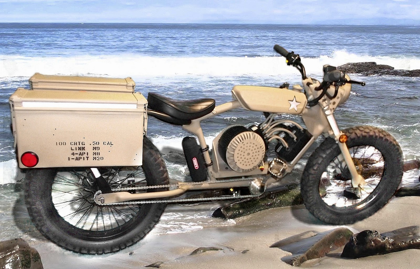

72V 100A 60Ah 4.3kWh 10s24p 200lbs.....

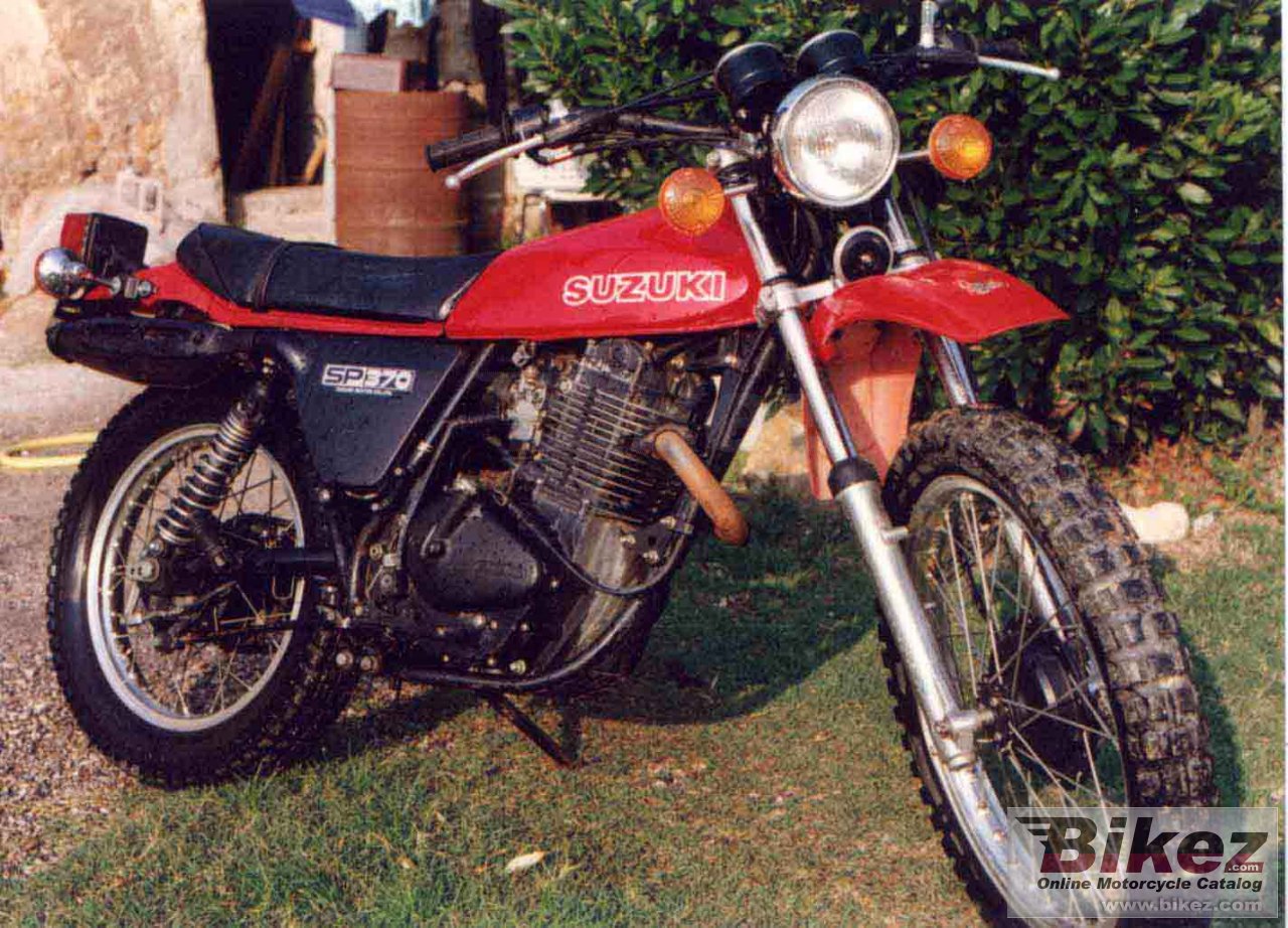

The triple tree crown I have now is from a 1978 Suzuki SP370 and it is exactly 5.5" wide with suspension-less tubes installed. I'm guessing I have to go much larger in size cause 370cc bike is just not big enough. The Suzuki A100 can't possibly be bigger than a Suzuki SP370.

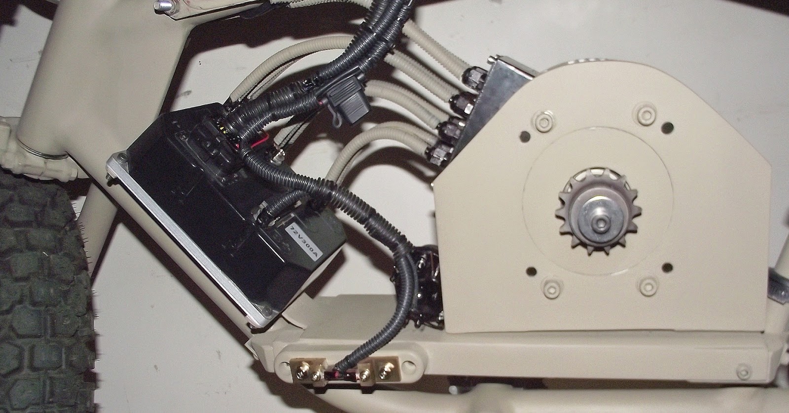

One 300A Shunt (bottom center) is now in place to prevent the Cycle Analyst from bursting into flames when I hit the gas. There is nothing more to connect, electrically, other than the main 2 battery cables coming from the ammo cans. That shunt was the last thing I needed to install up front. It will get sealed in Silicone at some point.
The Cycle Analyst is also connected and mounted dead center on the handlebars.
I would consider moving it from the side, to the top. I looks a little exposed in case of a tip over.
It would be exposed if not for the bikes pedal and/or crank which both stick out further than the shunt does.
That shunt has to hump that controller as close as it can get because the battery cables connect to both ends of the shunt and one end goes to the controller.
Those cables a 1/2" thick and I'm trying to hide them from view. As crazy as that sounds. LOL
I have to agree with bikenut. I'm constantly leaning my bike against walls or galvanized poles that can temporarily keep my bike upright. The last thing you want to do is weld your bike to a pole or damage the terminals. Also my bike has tipped over a few times already so I know from experience. :)
Actually it's only one electrode (-) that is attached on both ends of the shunt. The positive cable is buried in the top tube (to prevent unauthorized welding events from occuring).
The last time I tried to weld with only 1 electrode, it was actually quite unremarkable. laff
Actually if the bike falls over the ammo cans protude the most followed very closely by the handlebars, even canted at their maximum angle, then the bike pedals and crank arms make up the last line of defense.
I can confidently say that it's physically impossible for that exposed shunt to make contact with anything if the bike falls over.
