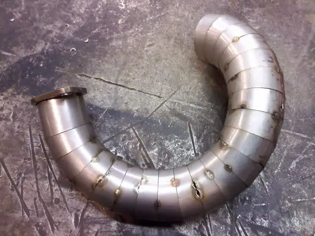

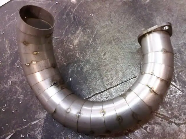

heres what i did this afternoon. this is my lead in pipe which has a continuous 2deg taper. 21 pieces so far

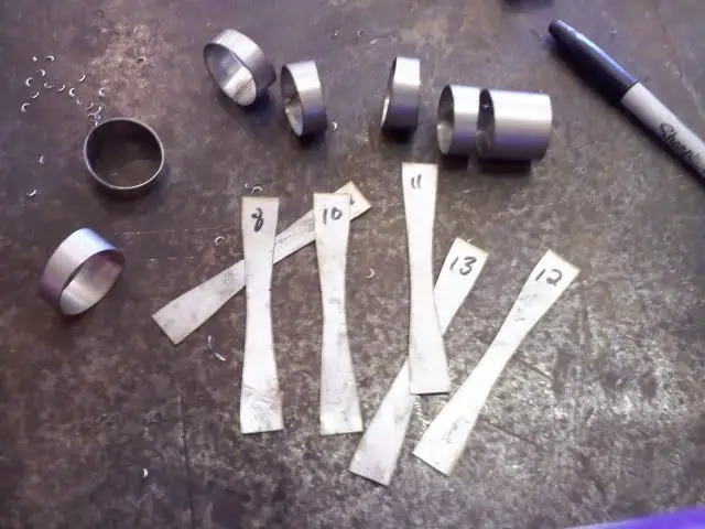

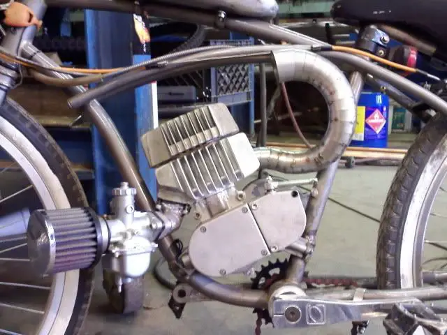

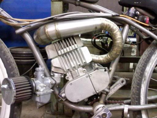

i got a little excited yesterday when i was assembling my cones and ended up having to work backwards a little. anyways, the first 21 cones are all a 2deg taper starting at 1.125 and ending up at 1.5 . the last three cones are the beginning of the 6deg taper, which will continue foreward and make a 180deg bend around the spark plug and run backwards along the right side of the bike. as far as the chamber and the baffle cone is concerned, a have absolutely no idea how i will fit it all in there.

Looks to me like you could pop youre tacks apart at the 9th 10th or 11th joint from the top on youre picture and spin the top piece 180 or there abouts and get an s shape with slightly up level or slightly down angles....pretty sure 180 out of the port another 180 around the head is 360 in bends and a NO NO ...at least in HVAC work... just an opinion....and thanks for the info on the tapered cone layout prog. 18+ yrs a sheetmetalworker..... so i could lay them out.... but why with this program!!!
why didnt you just make it a basic tuned pipe without the curves?? you know straight out the back? (with the exception of the seattube) i think it would look pretty tight with a stinger pointing out the back )
Foureasy,
That's a great engine... but the fins are facing upwards, should'nt it be sideways? or you're planning to water cool it?
