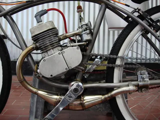

ah! i didnt envision it a a long taper cone my mucho ap-oligo to you mofrere
that pipe is going to work great i think. is it set up for midrange top end?
looks like it is gonna be friggin shweet (make sure you put a nice stinger on the end of that and run it mufflerless of course, wouldnt want to lose any power on that monster!

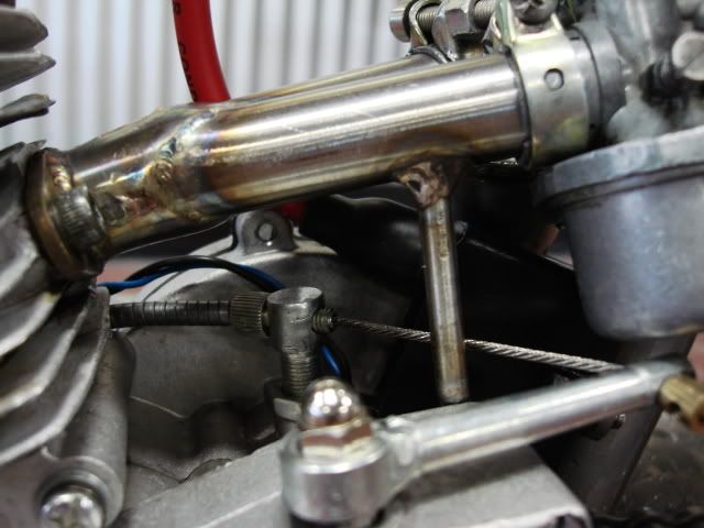

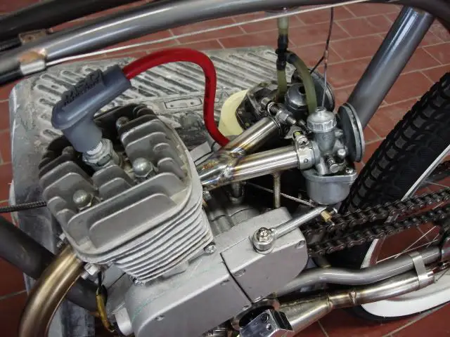

on a side note, i never even clued in to the fins untill it was mentioned, you could run into an issue there, perhaps you can ratrod up an air catch and direct it down?
Vertical fins cool better for slow moving engines, especially at idle. Horizontal cools better for fast moving engines.

Was the spacer under the jug just to space it up some, or is it an adapter? 40mph doesn't seem too difficult, but this motor is sure to run for a lot longer than most.
