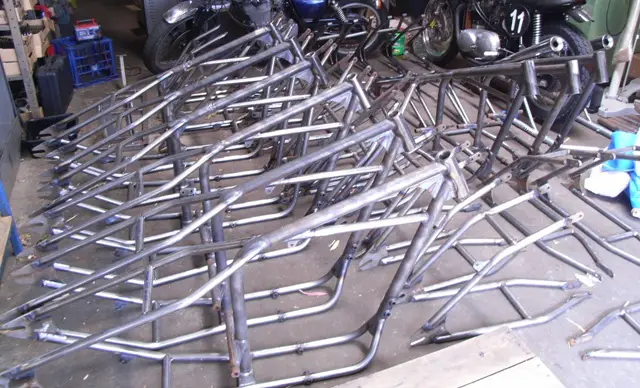

standard hardtail frame
to license it for road use as an antique vehicle you would need a frame with a valid vin and title. build the bike to look like the year/make of that vin

In saying that those frames Ibedayank showed do look very nice, if i could get something like that cheap enough over here id consider it.
