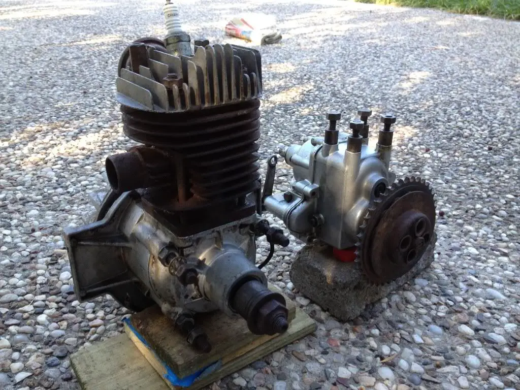

Well i just bought a gearbox, paid waaaaaaaaaaaaay more then i wanted, the box cost me more then twice the engine did, and i still have to find a clutch, but it should be up to the job
http://www.ebay.com.au/itm/250996463228?ssPageName=STRK:MEWNX:IT&_trksid=p3984.m1497.l2649

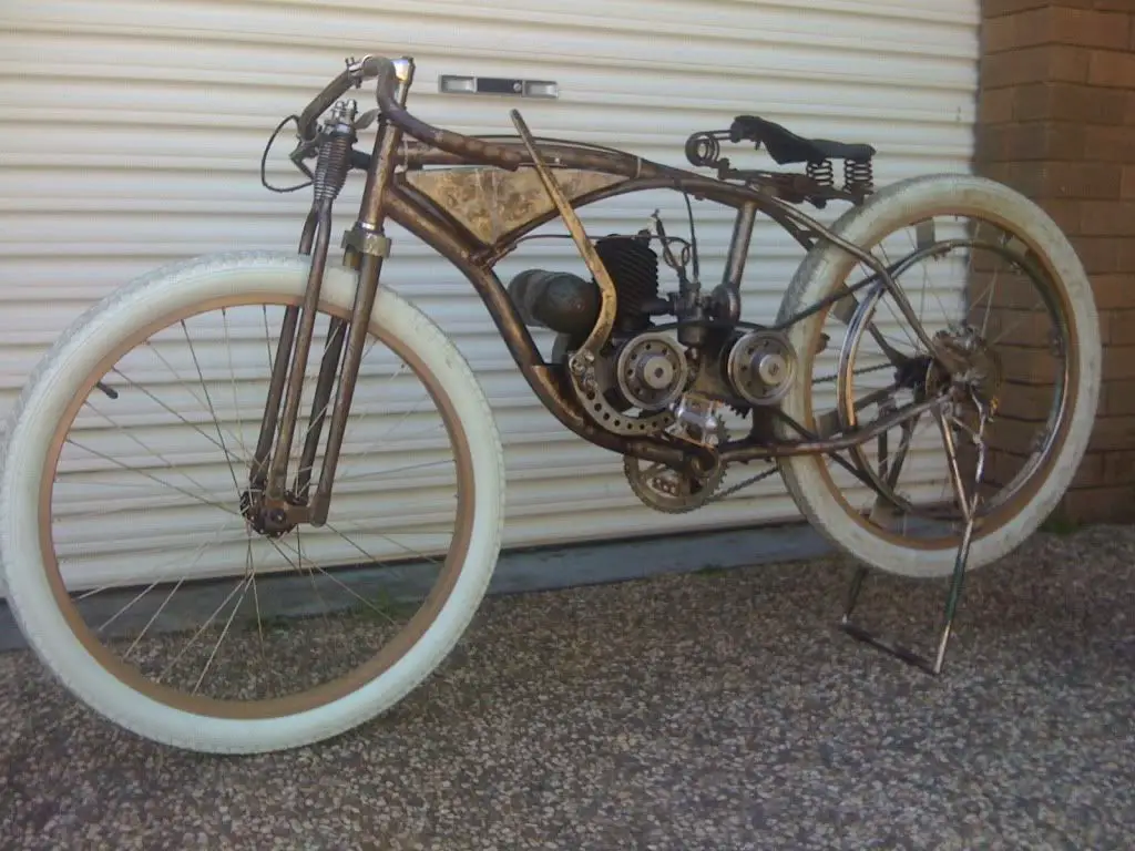

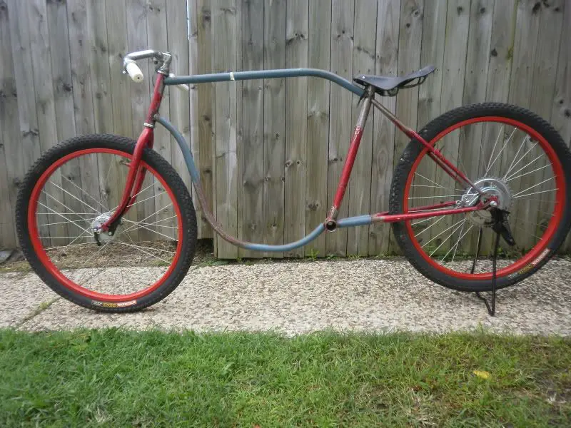

This build is going to be a long one, and probably a fair chunk of cash (to me anyway), and im getting the itch to get building but dont want to jump the gun on this build, i wanna do it right. So im gathering parts for my 160cc Victa, ive bought a piston set, electronic ignition and gasket set, i will use it with that small Albion box. Im deciding on whether to use it to replace the 66cc chinagirl in my first Kroon build or put it in the Indian build i never went ahead with. I may play with this build while doing the BSA
The Kroon, i would add an inframe tank
The Indian, i need to redo that downtube as i dont like it, needs to follow the wheel more and be tighter on the droploop bit.... this was my first ever attempt at using a pipe bender
