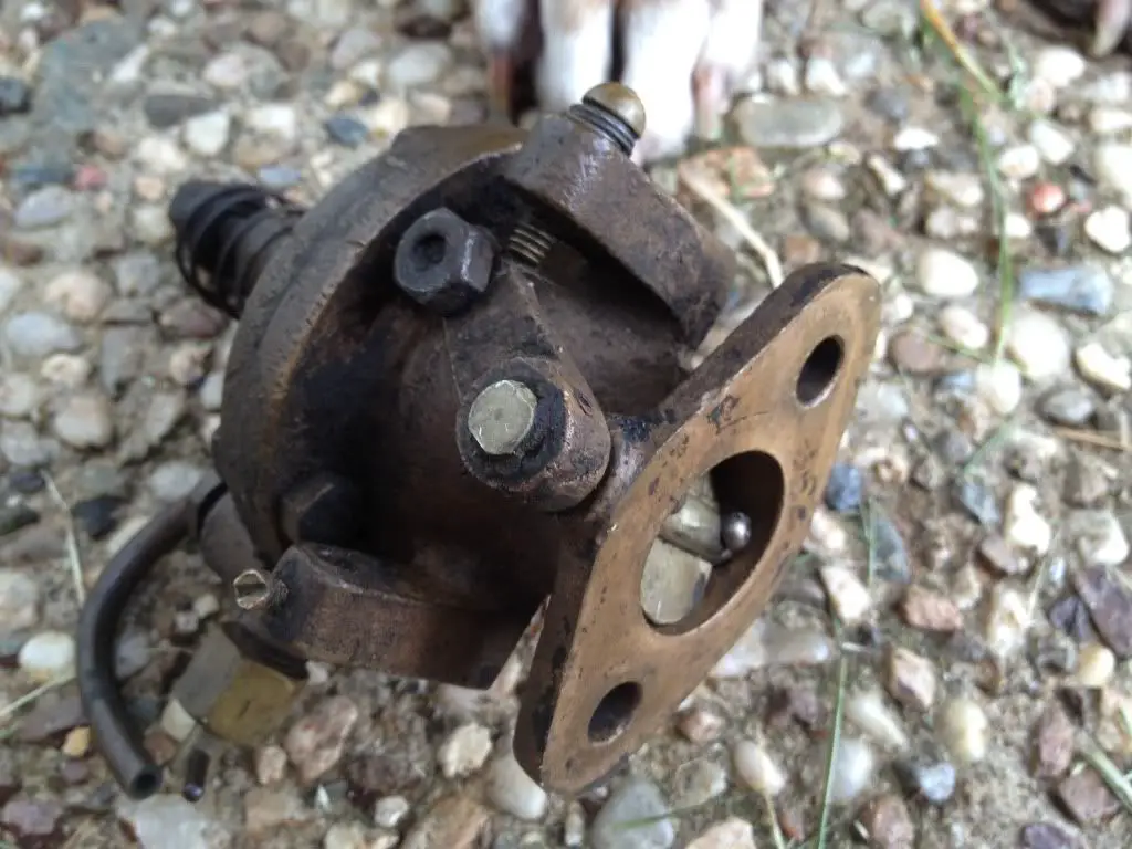

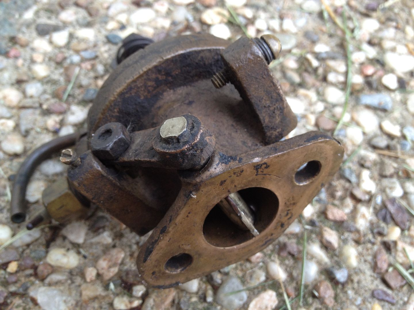

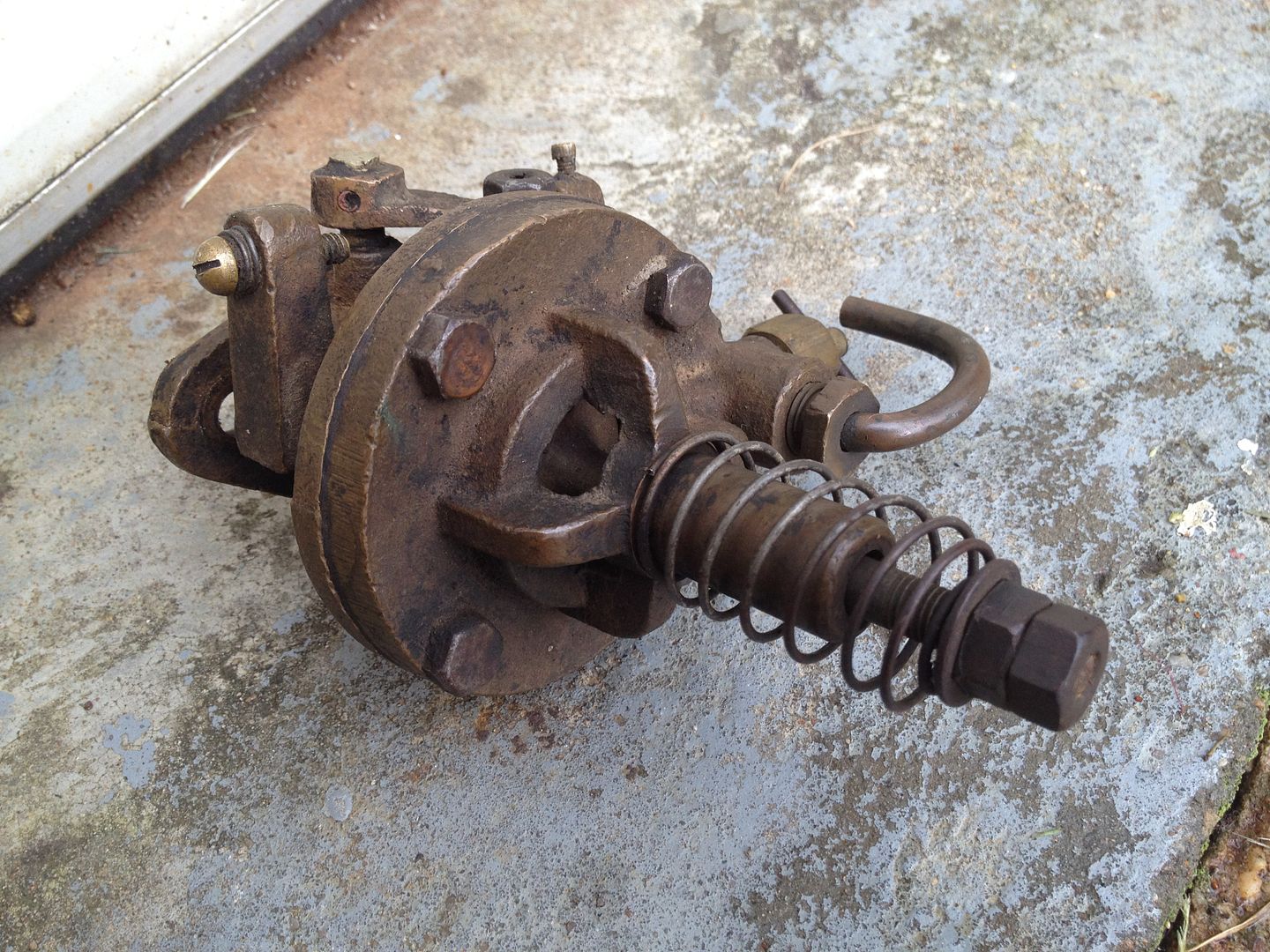

rusty what he has on the motor now is nothing more then a fixed metering block for a fixed speed
Im not sure about that, i had a feeling it had a butterfly valve, so i pulled it off the motor to check, sure enough it does.... Does this mean it would be usable because IMO this carb looks very cool and seems to be made of a copper/brass or similar material that would probably polish up very nicely

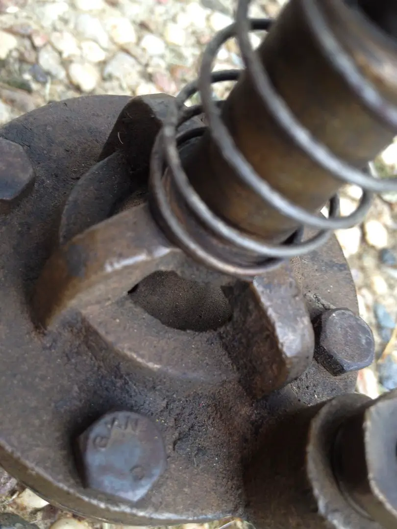

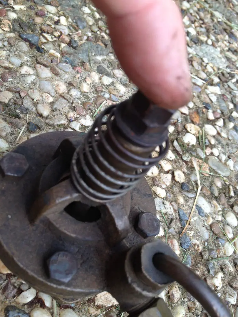

Because im admittedly a novice when it comes to engines im not sure what this spring thingy/valve does. When compressed it opens up inside (below the spring), i took a pic but not sure how well you can see it. Anyone know its purpose? And how that is actuated? Vacuum pressure perhaps? Any advice would be appreciated
