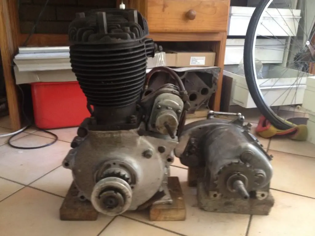

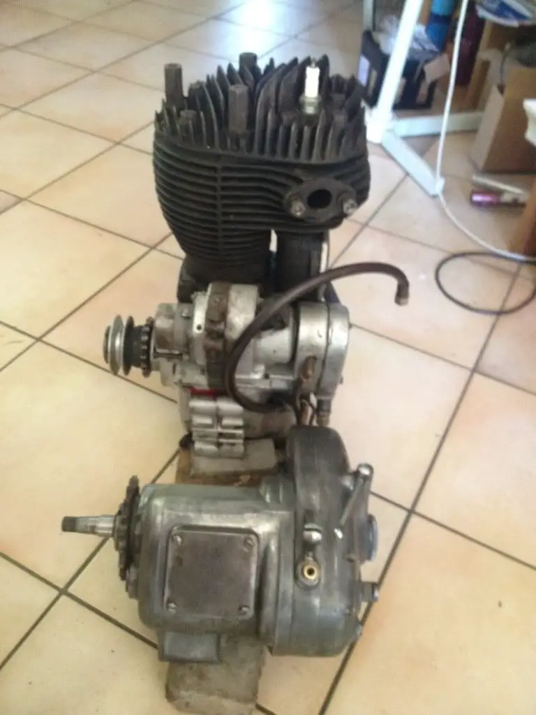

Yeah the box fits behind the seatstay, and yeah, i need to tighten up the downtube to hug the motor, will most likely do a faux round crankcase.
Ive actually got a 5.5HP genuine Honda that i was going to use for this build, but everyones got them now, and i like to try and do things a little different. So the Victa and gearbox should be a perfect fit and is actually vintage, unlike the Honda

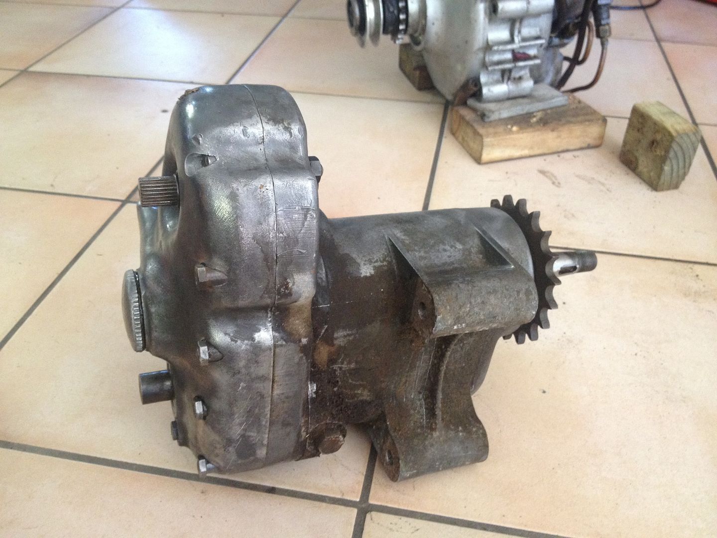

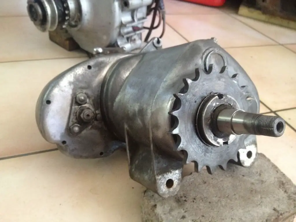

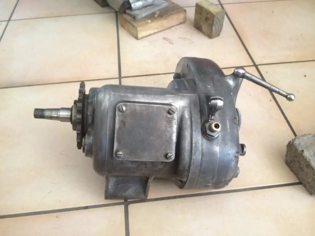

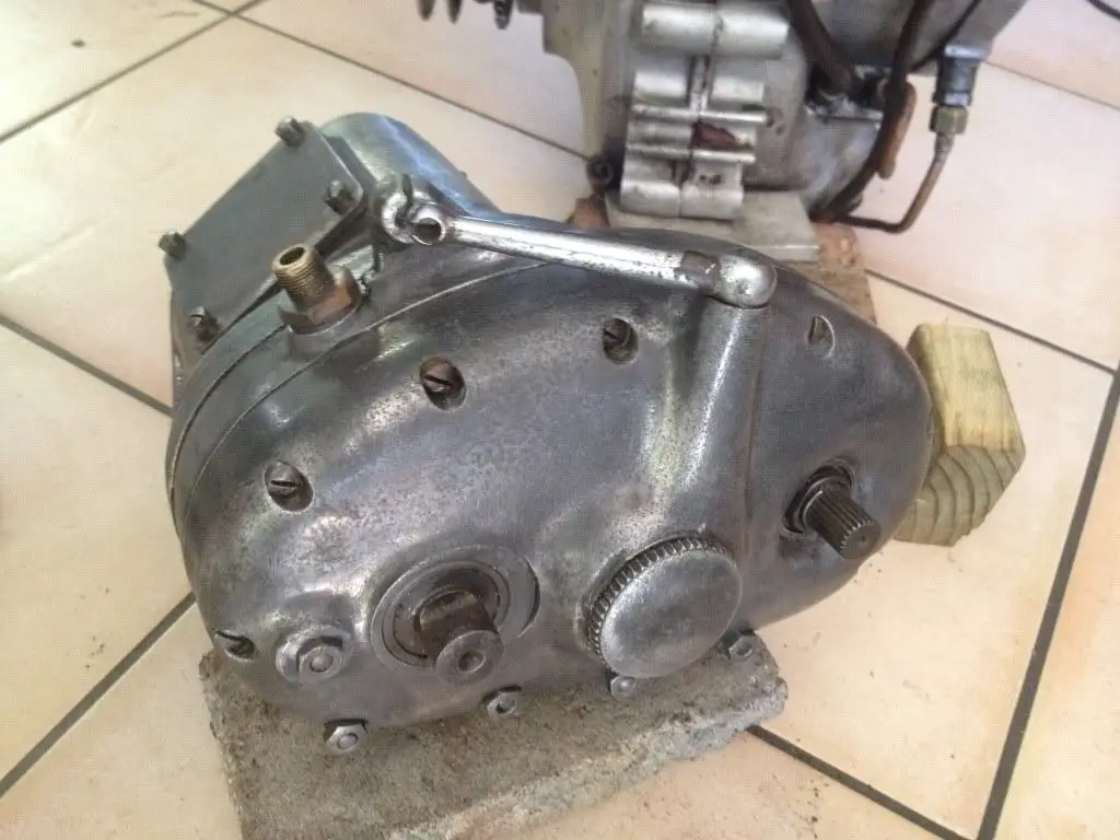

My gearbox turned up today, ill take it with me to the swap meet next weekend to see if anyone has a clutch for it or knows where id find one.
I did notice the sprocket on the engine is around 7.15mm wide and about a 14mm pitch, while the secondary sprocket on the gearbox is around 6.2mm with about a 17mm pitch, im sure that doesnt matter as im guessing i may need to replace the engine sprocket because it was used as a stationary engine and may have had a sprocket to suit that apllication.

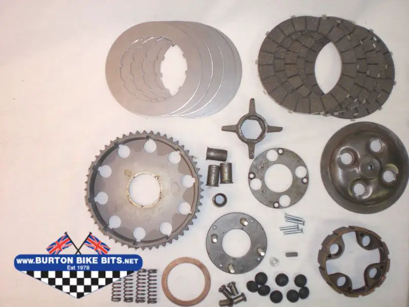

exploded clutch assembly
and I stated the size of the case was not that important on the trans... but try and put those bsa shafts in a case the size of the 1st trans you bought and see how far you get.

Yes i realise which is the shifter and which is the kickstart but thanks anyway.
I take it i can get clutches from Burtonbikebits if i cant find a local source so thank you for the headsup.
We all decided long ago that i wouldnt use the original box, thats been paired up to my Victa 160cc..... and for the record no-one said we would try and put THAT clutch on the OTHER smaller gearbox that was on EBay. We were questioning whether i could get away with a smaller clutch on a smaller box. But i now have this box so thats no longer an issue thank you.
