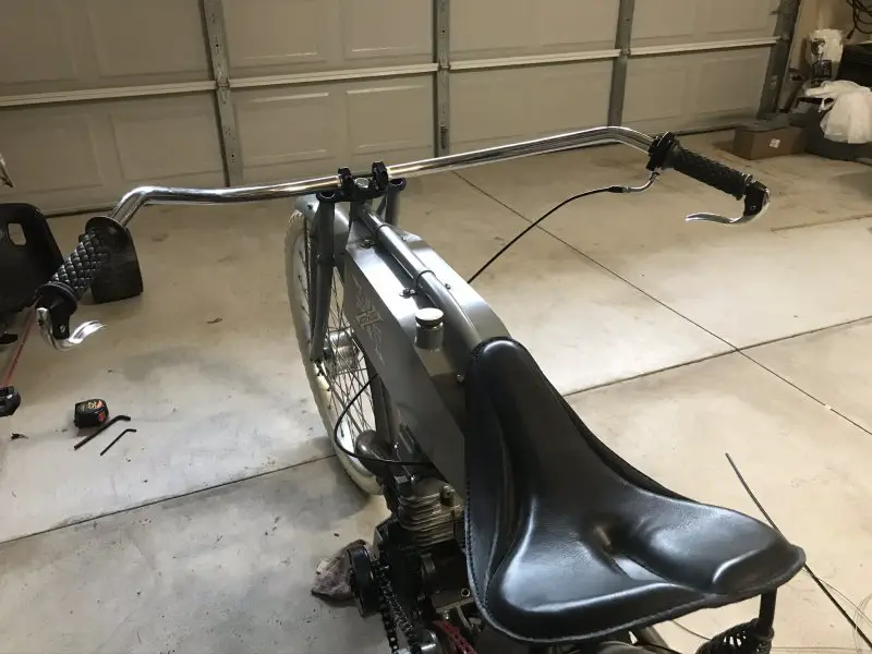

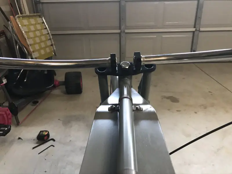

I’m back On the Worksman drums ...I can’t let them go....! Cleaned and sanded hubs again . Running modern inverted levers with heavy duty cables will be my final attempt..ya right. I want to ride,!,!
so I found a local welder for my small jobs. Had him weld on 2 wrench flat collars and move pin on front drum to opposite side.

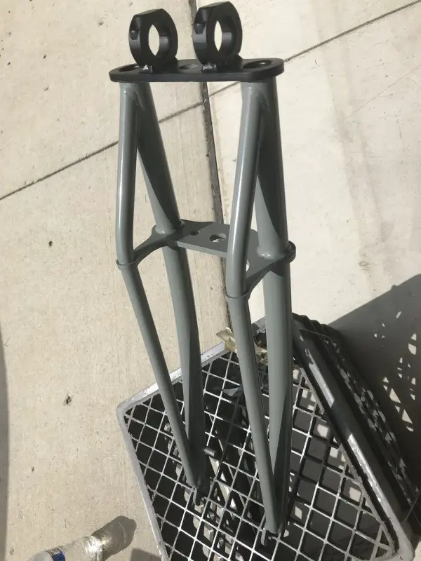

Just repainted forks and installed them along with my 7/8“ handlebars. The wingspans of this setup is 36” . Hoping I will eventually remove shims and go back to my original 1” bars .
