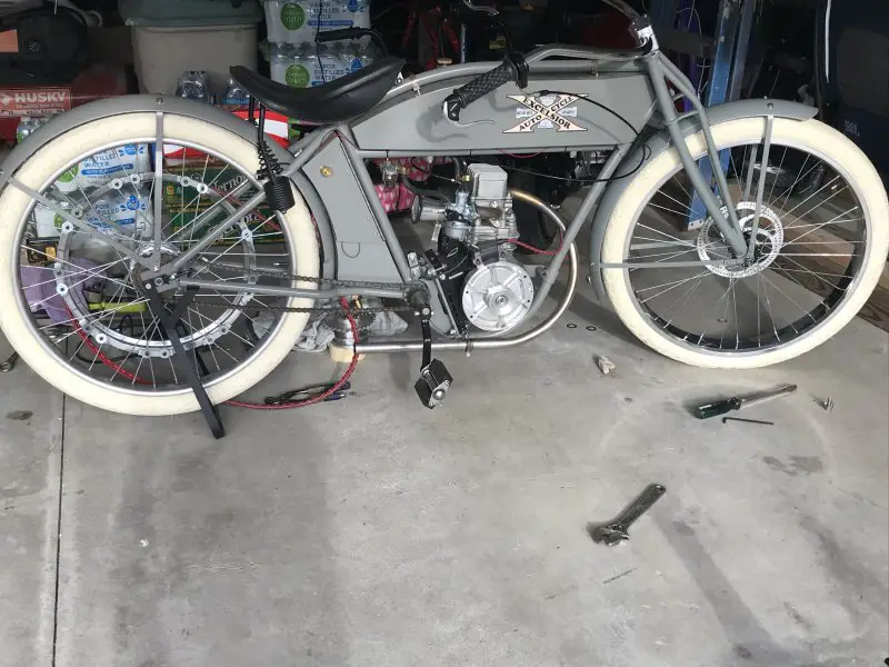

Well parts arrived for disc brake / wheel conversion. Rotors look horrible so....
Not going to do it !
Got some thinking to do. I am accepting all ideas for alternative drum brakes.. I may go back to 90mm Sturmey drums front and rear. As they work better than Worksman but look not so vintage.

Man that bike looks great. Yea the rotors do look horrible. I’m used to the drum look myself now having a 110mm drum on the front. It’s a strong brake, came off a ‘69 Yamaha dirt bike. Pads are at least a quarter inch wider than the sturmeh archer ones. Sadly you can’t really find the drums with brake plates complete on eBay. If I had to do this again I’d go to a motorcycle junkyard and cut a drum out of an old wheel.

I admire you for sticking with the look and I agree the Sturmey has decent stopping power especially when when run on both front and rear. I don't think the rotors look bad on your bike, but no way do they look classic. It would be quite difficult to make your X look anything but eX-cellent, but a guys got to suit himself or why go to the trouble of building these things.
You're a mature rider so I think you know how to ride well within the brakes limitations.

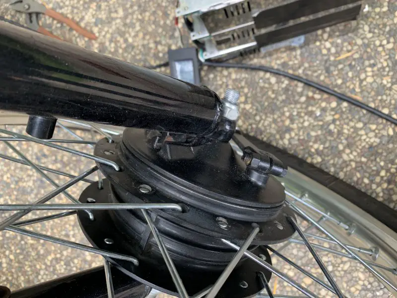

You could probably buy the entire wheel cheaper. Old drums usually have old rims, spokes, and tires attached to them which are cheaper to ship than spend time on. I bought a moto wheel for the spokes once. Around $37 shipped... got a 125mm drum with a broken brake plate and no shoes.. threw it out.
You just need to weld in a tab on your fork for the reaction slot on the hub. Moped drum forks already have this tab.
Also going this route you are moving up to a solid thru axle which is so much easier to deal with. Wheel removal is so easy. Remove axle and wheel comes right out. No pesky brake reaction arms to deal with.

Hey guys I have a great line on complete wheels $10 but have to wait to go get them as we are still restricted till May 28th. I want to be able to measure the hub to see what’s workable.
Thanks Velo I have those P clamps in my bookmarks!
Gotcha on the tab Tony ... I had some K10 forks before with the tab your talking about. I do like the slide thru axles.. and have used them on a worksman front wheels before.
