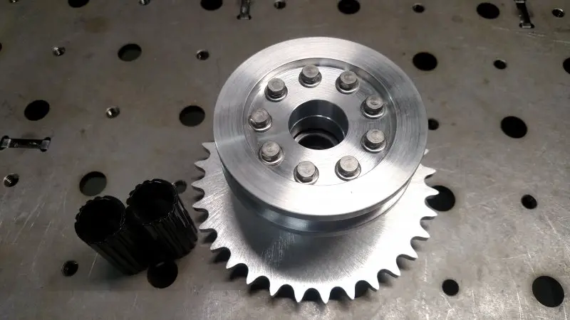

Nope..But yesterday I went through pictures of there events! my bike is kinda down. Waiting for a new reduction. I’m switching from a belt clutch to sprocket. That belt just slipped so chain and sprockets will stop that. Final drive will still be belt and sheave. I will be there next year!

Yep back in post #49 i indicted 2 3/4" may slip, with that power. Bigger pulleys on jack shaft would take care of it, or a third pulley idler to give the secondary drive pulley more belt warp. Yes chain will definitely take care of slipping, love this bike..........Curt
Curt I remember you mentioning that in a post but forgot it was on this thread. Belt wrap/surface area is so important to belts functioning properly, yet pully larger pully size is sometimes difficult to fit and also retain the proper drive ratios. I'm thinking a 4" might not slip but what that results in drive wise moto needs to calculate. Don't know which would be easier to switch, but with the beautiful primary cover in place no difference to onlookers.

Yep, would be a must to change the 6" to bigger pulley also, but chain i think would be easier, just remember to do teeth count and not size..........Curt

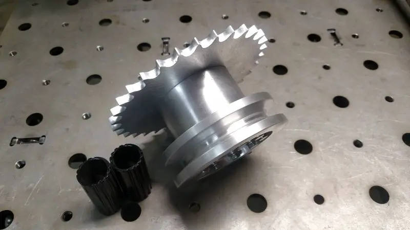

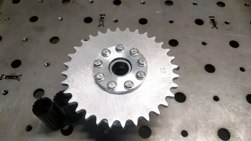

Yes I do remember the post ..Since then I upgraded to a 3 3/4” and slipping to rear sheave stopped . But that’s when the clutch belt started slipping ..I think it was slipping along with the rear belt..lol My new reduction will have removable sprocket and a removable pulley. So I can switch gearing at both ends (ouch) !
I like your plan for the solution especially with simple parts interchange. Quite often my drive ratios so carefully thought out needed two or three sprocket changes to get just right for all around riding enjoyment and joy in use is what I'm about. Substance over style on bikes that are actually ridden and not just garage art. Your bike is art but is built to ride & that's when you know you've done well!

Thinking if one wanted to stay with belt serpentine or cog timing belt would be the answer, serpentine is the same as having 5 or 6 belts, depending on 5 or 6 grove choice. That's what Mr.B ended up using, instead of wide flat leather..........Curt
Yes Sir..next I will be looking into using a Ax belt or cogged if needed. Hoping this will do it. I have a heavy duty tensioner which may also come off the shelf if need.

So Bikes been down waiting for new reduction..it’s coming. Switching from all belt to chain to belt. Looks like I’m going to get in a Halloween ride and a occasional ride during the arctic months..yes!
