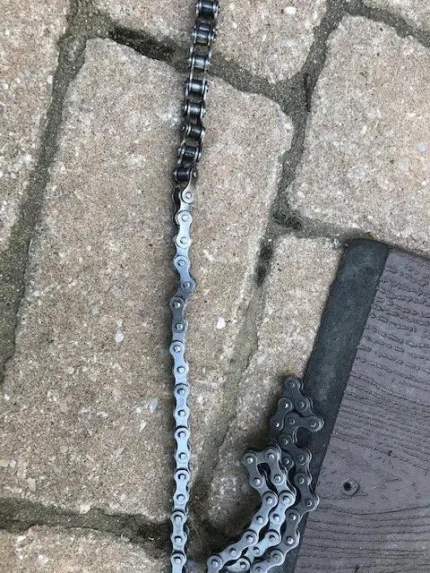

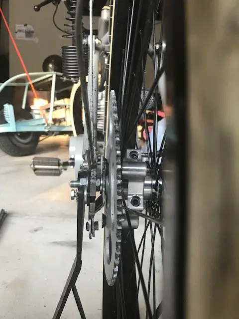

Well ...If I were to put a stock 212 on it I would probably be set. But Noooooo I had to mill and port the head, 28 degree timing ,cam 22(?) lb springs bl bla blah . Its to much. It was to much for the belts and apparently to much for a the #41 chain . Bike engages at 2900 rpms so rode around today keeping it cool. All was smooth until I goosed it ....twisted chain and sprocket .

Just how true is your chain line Keith? More photos may be useful for diagnosis. Catastrophic chain failure is not an accident. Your belt drive had a lot of alignment forgiveness. As you know, chain not so much.
That is why my Flyer has not hit the road yet. You know I did similar mods to a 79cc. Your 212cc has to be close to if not more than 22hp. My second engine caused me to readjust primary drive chain line again. Different out put shaft? Likely.
Second magnified look at drive sprocket shows 3/8--16 FHCS backed out alot, and is the drive sprocket bent?
Was that what caused the chain twist?
Lotta chit going on.
Tom the one thing I overlooked was High engine rpm at all the time.. I mean your up to 6000 grand going 15mph lol . It engages at 2900.
The failure was the chain. I look back and remember removing a pin and thinking wow that was easy. No kidding it’s junk .It’s a #41 Not made in American. I’ve been riding it for 2 days.Took it out today drove about 1/2 mile away from home.Took a wide turn and gave it some good throttle as I came out of the turn I hammered it. Chain bent itself and the sprocket. I did the walk of shame......lol
As for alignment lazer lever and straight edge straight.Chain had perfect slack I checked before I left for the ride.
420 diamond brand may be in your future. Were the flat head sprocket bolts loose before the photo was taken?
We are all on the leading edge. No manual. Goes for my SF80 build too. We are there where have gone before.
My front drive from clutch is a #420 and it’s fine. You may be right. Ihave to pull back the cash $$ for know so that means I’m putting belt back on . Tom you get the belt again!, lol just from the js back. The sprocket bolts are tight. This sprocket bolt holes are not counter sunk so that’s the look.
