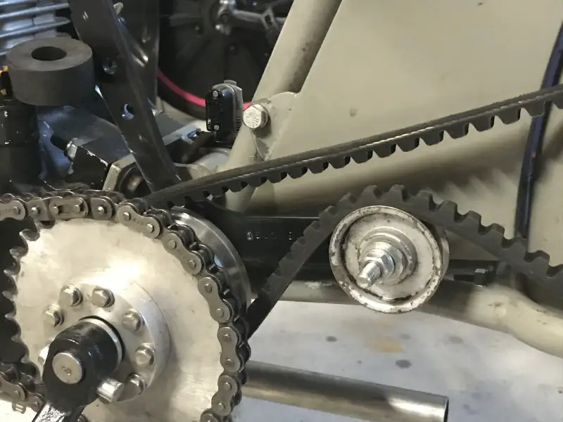

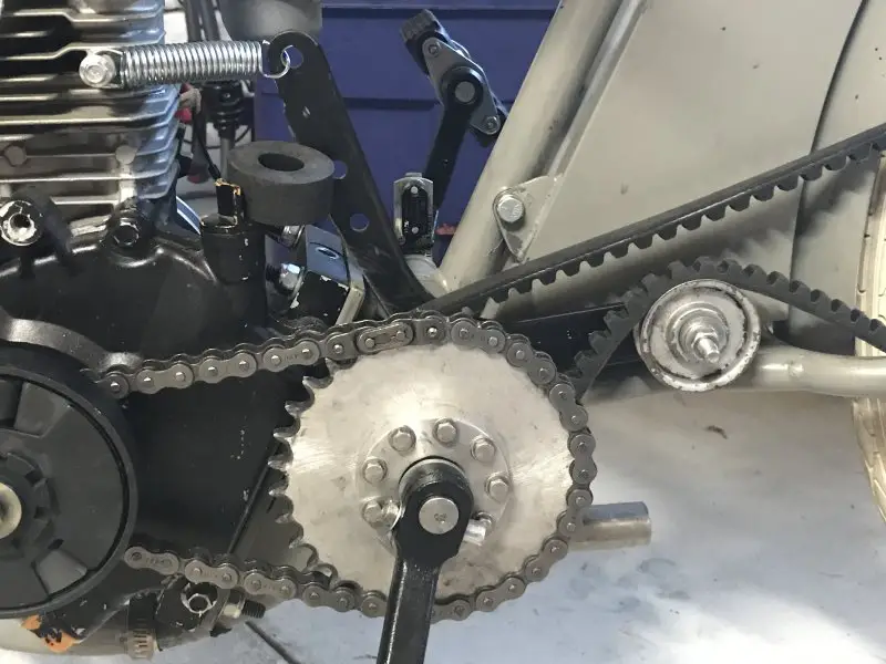

So I have a bunch of ax belts with ax75 being the largest . Well not large enough need a ax77. My tensioner is going to have to sit in the same area as most 2 stroke idlers . Is this ok on a belt drive? I know I want a pulley under belt with pressure going upward close to front pulley but ...I’m sliding back toward rear sheave.?
I have a nice tensioner but it’s not compatible with this set up. So ended up using a garage door pull cord bracket. Need to attach to bolt on motor mount and trim off some of the length of the top but it’s gong to work! 3rd picture just didn’t cut it! Lol

The belt tensioner photos lead me to believe you've found the solution & it's non-intrusive to the vintage look and many bolt on tensioners are not.

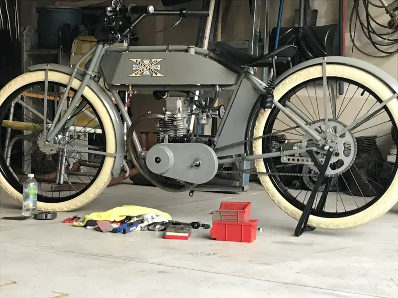

Well guess who’s almost street ready. Yeppers..switching to all chain from belt was a job. What made it difficult was the bike and jackshaft were all custom built for pullies and belts. So first came the wheels. Front drum Worksman ,rear coaster brake riding on 65mm double walled. Next Hilliard heavy duty clutch which will be getting black springs this week .(Thanks Tony01) Then the hard part, using my Js from the pully set up and adapting sprockets to it and keeping descent gearing. Drilled the bolt pattern in a 19T sprocket to match jackshaft, which was also tricky. JS inside is 19t which is as small as I can go which leaves me with a 54T rear. Surprisingly it all fit inside my trans. Cover. Had to cut into fender for chain clearance,coaster brake arm cut and re drill for clearance and I removed one ear of two on coaster brake side only. That rear area is so tight...well........it’s just right!
