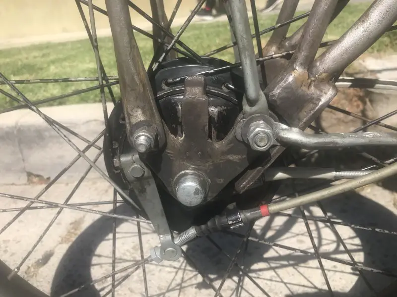

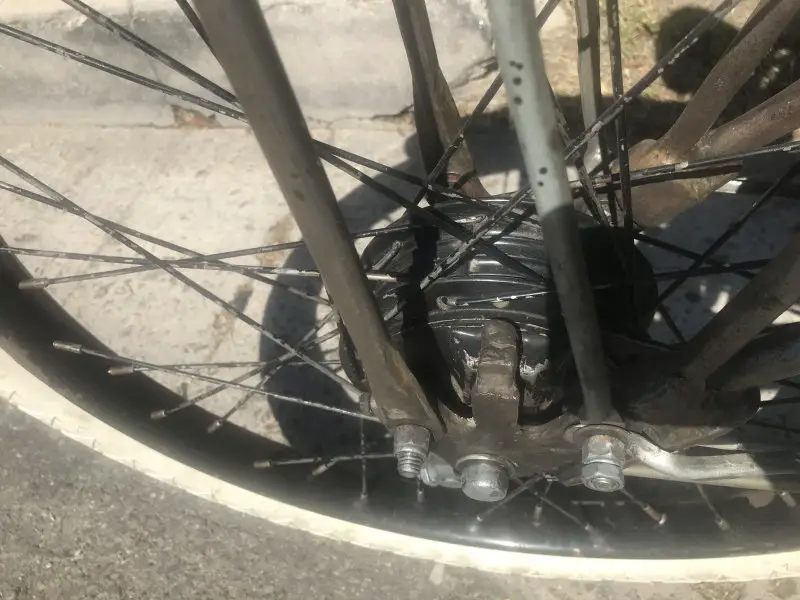

I have been through a lot of the Worksman hubs. Very tough but not the best performers. They are essentially an Atom design. Picked up a real nice set of original wheels off a Lawwill Pro Cruiser which is a vintage mountain bike made by Mert Lawwill the flat track guy. Anyway, the wheels had a perfect set of original Atom hubs the have the exact same drum body as the Worksman, but use a different backing plate and work VERY well. I have long suspected the problem with lack of performance in the Worksman version is the rather long and flexible lever arm the connects to the brake cable. Cable stretch is also an issue so use fatter motorcycle cables and bicycle cables. Better cables and maybe a true atom backing plate or beefed up Worksman lever arm should help. Finally, regardless of looks I much prefer the disc brakes now. Like anything new on your bike you just have to get used to looking at it.
Good info thanks Pat. I will look at the plate and see what I can do there. I just want to ride..ya know!

You have built another beautiful bike! You should be proud. Sorry I’m coming to this late, but in regards to brakes for these higher powered machines, I can not recommend more highly the use of a small motorcycle front hub. I learned this a long time ago from the guys at BigBoy Cycles. They had a bike at the race track and they were using a Honda C110 front drum brake. I bought one about 5 years ago and have never looked back.
Using my stock spokes with a worksman rim, I laced in the hub as you would a regular bicycle hub. Geometrically the spokes work even though the hub is much larger. I did have to fabricate a lobe to keep the hub plate stationary, but other than that, use a motorcycle brake cable and this brake stops me quickly even when I’m rushing up to a traffic light at 45mph and it suddenly turns yellow. The front brake is so effective that I still use a coaster brake in the back (vintage Morrow Hub).
Looks like you’re already going disc brake, but just thought I would share.

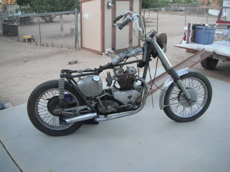

My eyeballs were bigger than my wallet when I brought that T110 home for $500. Here's what it looked like ...
Would you believe I was so excited I couldn't sleep that night? There must be something wrong with me! :)
But here's what it could look like.
Maybe I'm OK after all.
So far the long forks are gone, I've got a set of 35mm Betors to replace them, and next up is making a new steering stem to adapt the Betors to the Triumph headstock on my lathe, but I haven't touched it in forever. Maybe I'll hit the lottery ....
