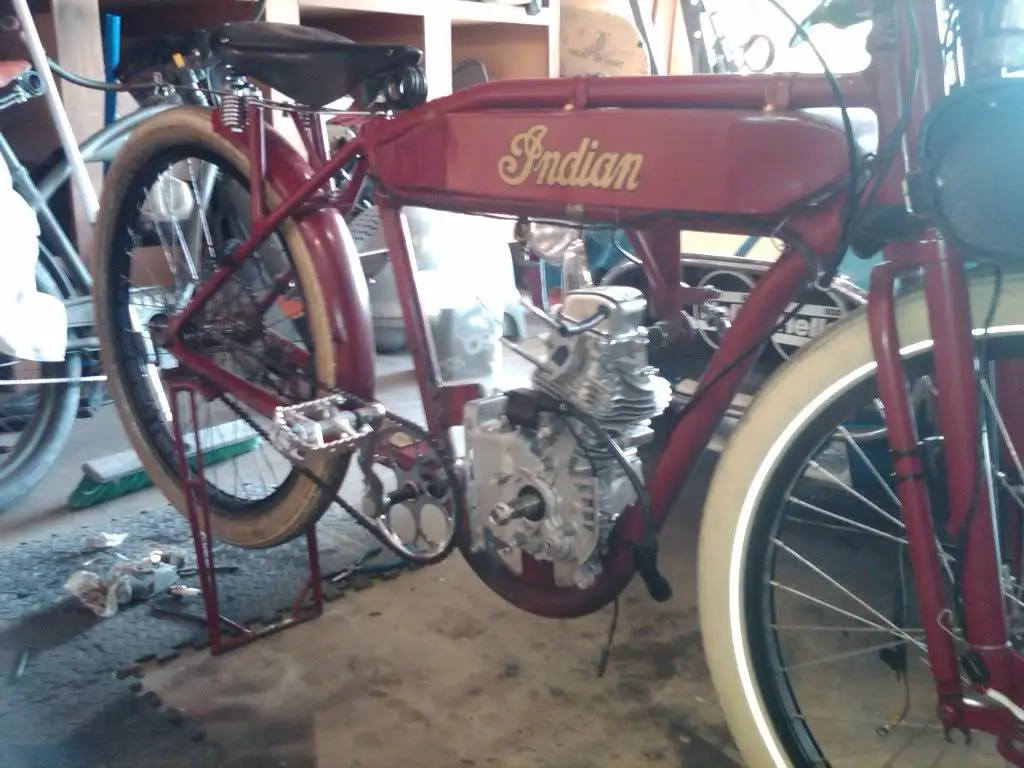

I was going to go for a nice ride around the neighborhood and one of the China Girl's engine studs stripped from the block. So I took this as a sign to move forward with Project big engine NOW! So I removed the old power plant (with extreme prejudice) and cut off the front engine mount and the mount I had for the fake engine plates I made for the China Girl engine. BTW, if anyone wants my fake engine plates I will give them to you, you just have to agree to use them for your own bike, no re-selling, OK. I sat the new engine with the head, crank, and cases attached. I am still waiting for my new rod so the engine is not complete inside. As you can see the GX200 engine fits well. The rear engine mount from the China Girl is at almost the perfect angle the GX needs to be so I can build off of it.

That engine really looks like it belongs there. I would really love those old side covers, but I have nothing to do with them, so no :( Anyway, keep us informed :) Peace

Raffle Raffle ,lol ................and that does look like it belongs

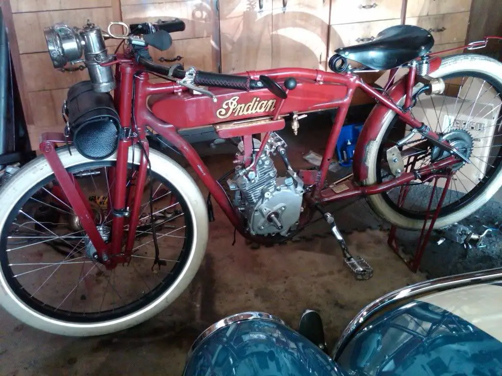

An Indian replica in the foreground, and a Cobra behind it. And you live in sunny California. I'm tempted to come live at your house.

Thats looking awesome. What are you planning to about your former hand shifter? Because wont your bike now have an auto clutch. Are you going to remove it or use it for something else, like choke or something?

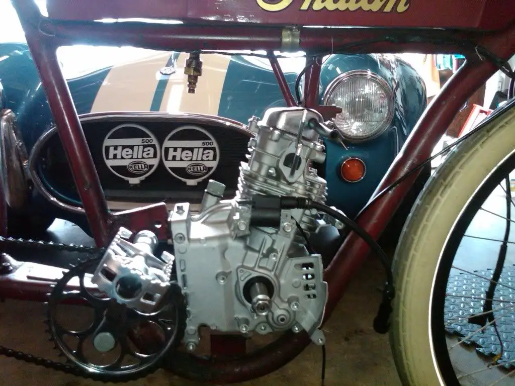

Just a thought or question. Do you think if you tilted the motor back (if possible for clearance) a little so that the barrell was vertical this would look better, more authentic? As the original single cylinder Indians were. And this may also help with the oil...... just wondering.

Your project looks really good. I think the engine angle is just right.
