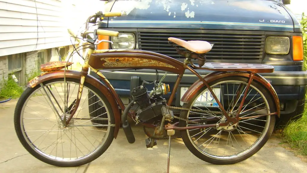

Not sure why this post is in this section but I have a few tanks to share...

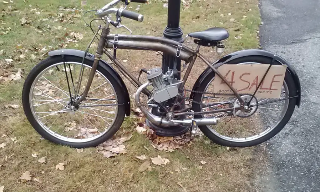

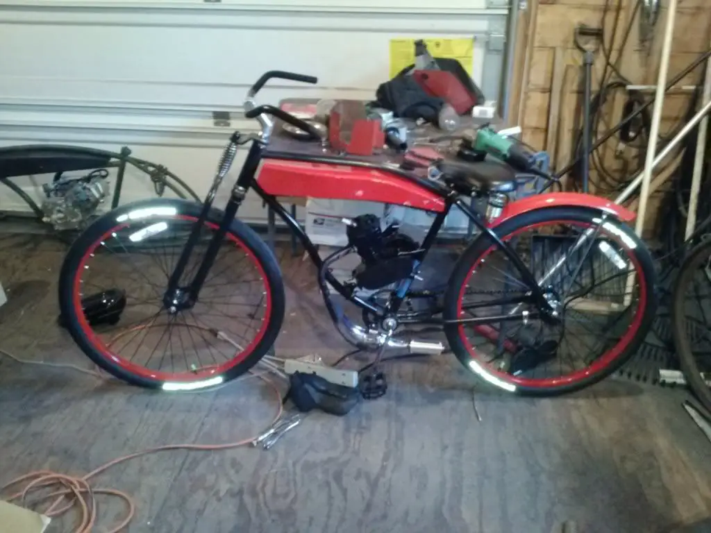

A few tanks I've made....
I've done some tanks using the top tube of the bike frame as well......anything but a peanut tank thank you!
