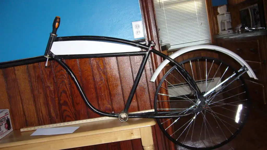

I just picked up this frame on eBay to get things rolling.
This will be a long process but I'm really looking forward to the end result.
I'll post as the parts trickle in. I'm currently keeping my fingers crossed on a nice restored sprung leather seat. Also looking at some vintage solid L shape seat posts to give it the correct stance.
Cant weight to get started on the frame once it arrives.

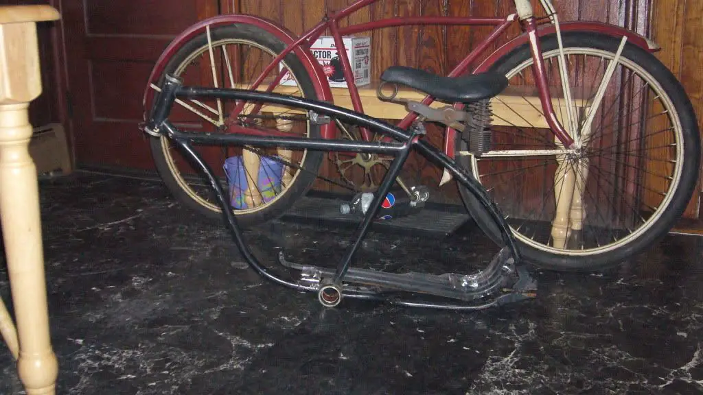

Picked up a 1936 Westfield Seminole rider on Craigs list yesterday.
I'm stealing the mesenger seat the rest is going on eBay in a few days unless someone in the RI. airea wants it .

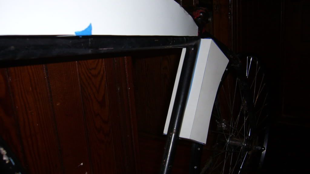

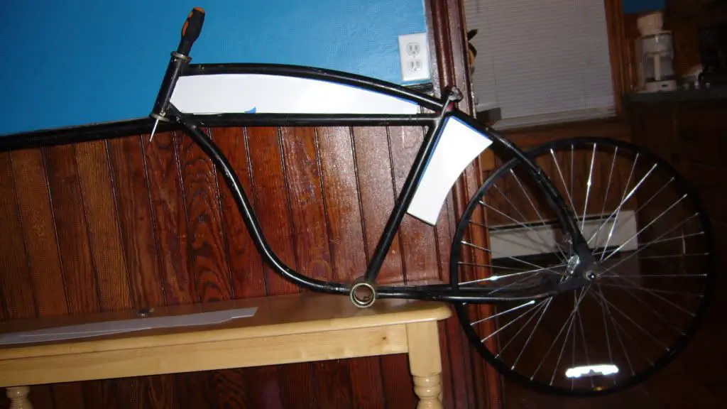

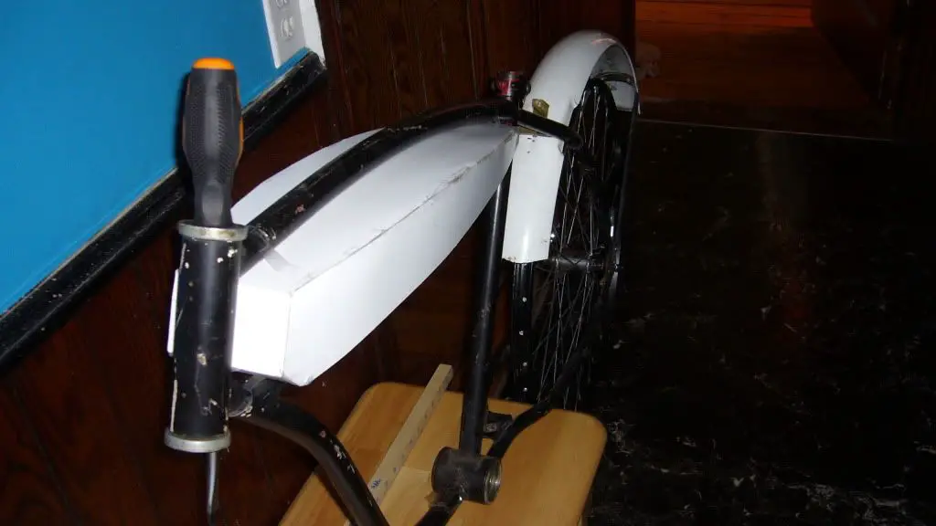

Well today I came up with my first design. Next step is to break it down into a pattern that can transfer onto some 1/16 inch steel then bring it to a welding shop .
I made the widest part of the tank just big enough to clear the stock fuel fill on the peanut tank that comes with the kit. Of course I'll cut it down a bit for a better look.
Nice curve to the sides of the tank. Takes awhile to even get to that point, doesn't it? Wait till you try to curve the sides and tack it together. Total pain. Nice build!

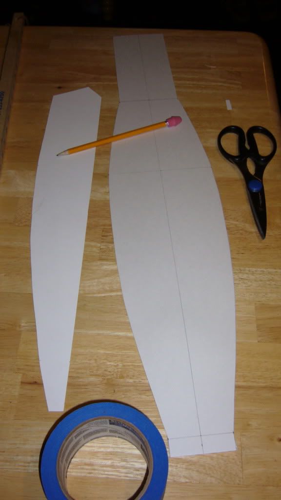

Hear is the tank pattern ready to be cleaned up and sent to the cutter.
And this is my new mock up for the oil tank.

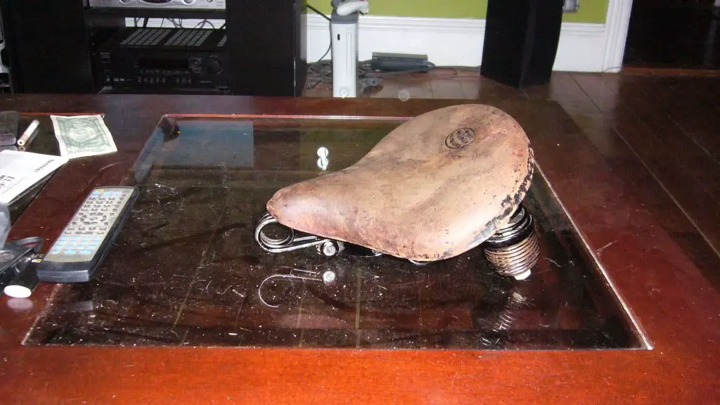

My new old seat came in the mail today. I picked it up on eBay. eBay - New & used electronics, cars, apparel, collectibles, sporting goods & more at low prices The finish was not saveable, but I wanted a natural leather seat anyway. I sanded it down with some 200 grit paper.Then i gave it 2 coats of mink oil then hit it with a buffer wheel on the grinder. I left some old black on the edges to give it an aged look. Not really needed with the 1926 patent mark in the leather.

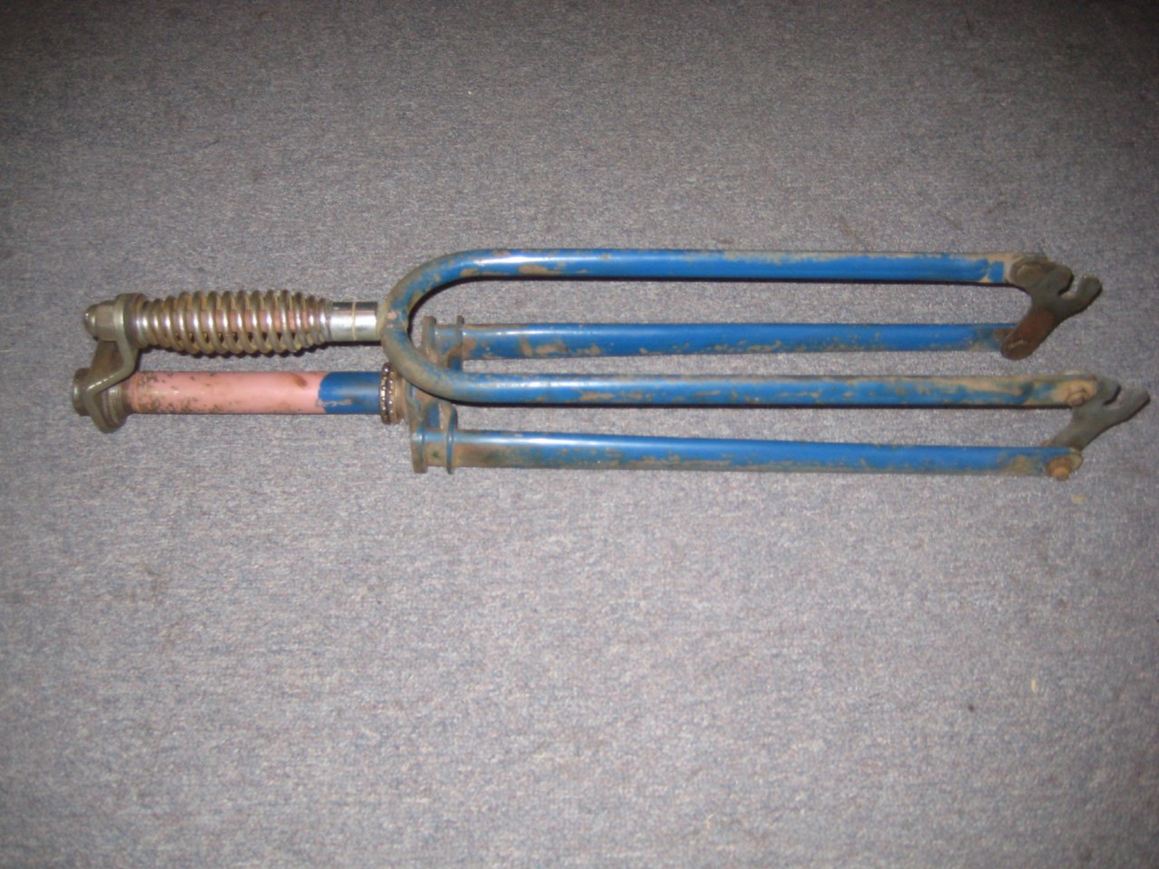

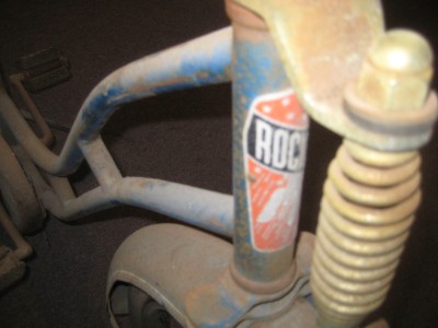

I also picked up a set of forks today
I went with the single spring style just to be a bit different. It actually cost me $2 less than the repro would have. Now I'm just weighting for the Pirates to restock.
Also I droped my tank paterns off to be cut out. I'm having 2 sets made. One i'm going to try to weld myself, and the other to send to the welding shop if i botch it.
