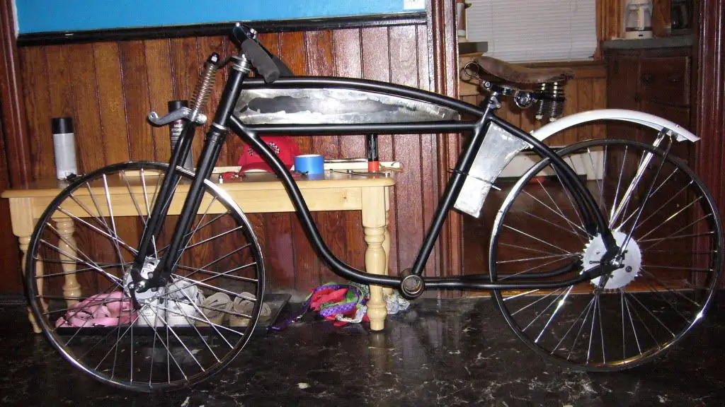

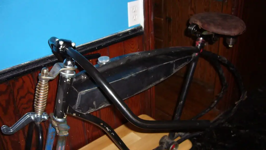

Nice curve to the sides of the tank. Takes awhile to even get to that point, doesn't it? Wait till you try to curve the sides and tack it together. Total pain. Nice build!

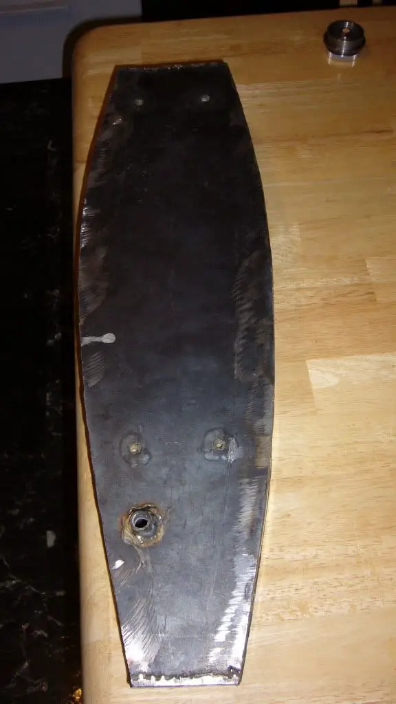

Yes i did . I have a pinhole wear I welded the stud mounts from the inside. I just ordered a tank liner kit to take care of it.sweet tank ,did you presure test it yet? i like how you cut your handel bars

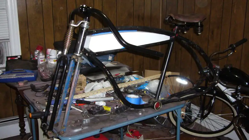

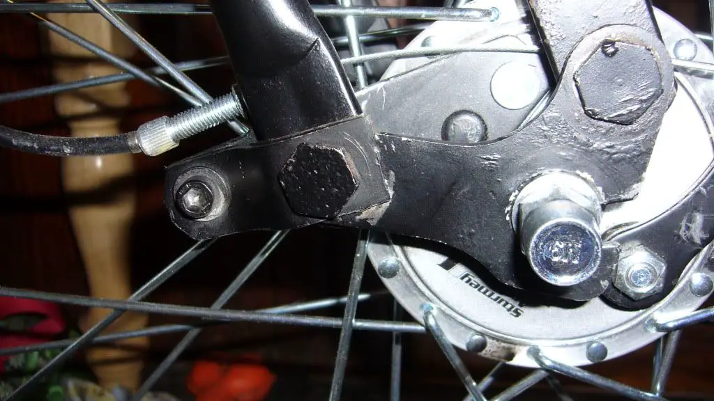

Ok I need a bit of help. I cant figure out how to mount my front drum brake on my monarch front end. when the spring compress the brake arm moves 2 inches back and forth so their seems to be no way to connect it to the forks. Any help would be appreciated.
I finally solved the drum brake problem. I noticed that the brace for the drum moved perfectly in line with the rear pivot point of the springer so i made a bracket that lined them both up.now i start on my next problem. The frame is much longer in the front loop than most bikes. The picture shows the bike with 3 rear mounts. this will never clear the crank. looks like I'll have to weld some mounts unfortunately. I've ben trying not to cut or weld on any of the vintage parts, but it looks like i don't have a choice.![]()
