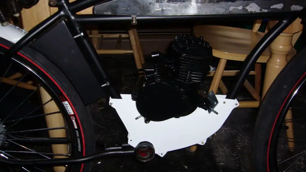

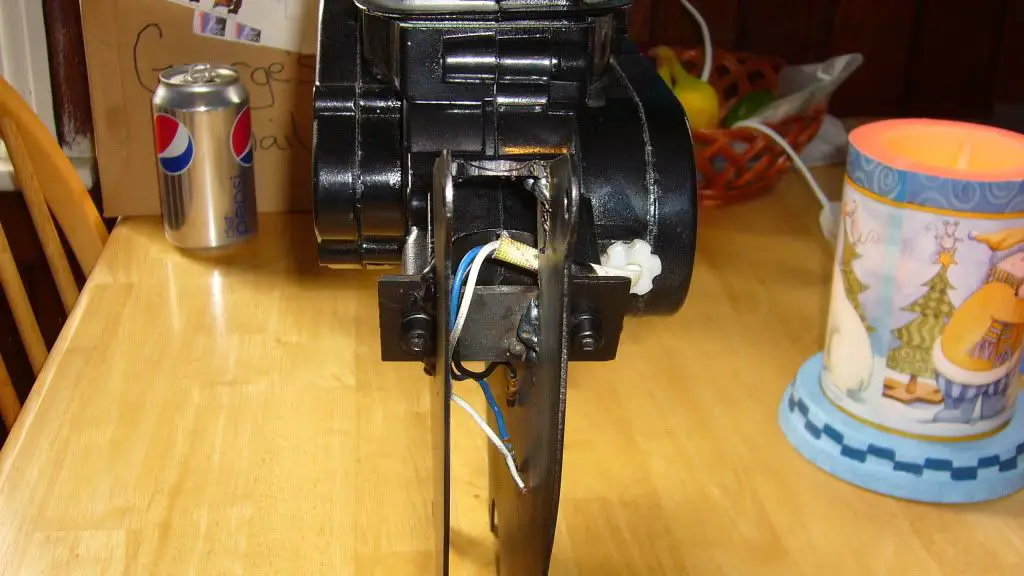

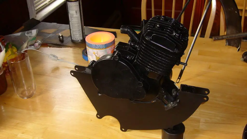

This is my first attempt at an engine mount. it will bolt around the frame and will have slotted mounting plates to adjust chain alignment. Between this and the manic sprocket adapter I should be able to eliminate the tensioner all together. Thanks to the built in chain tension bolts in the frame.

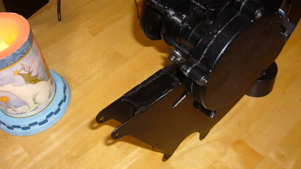

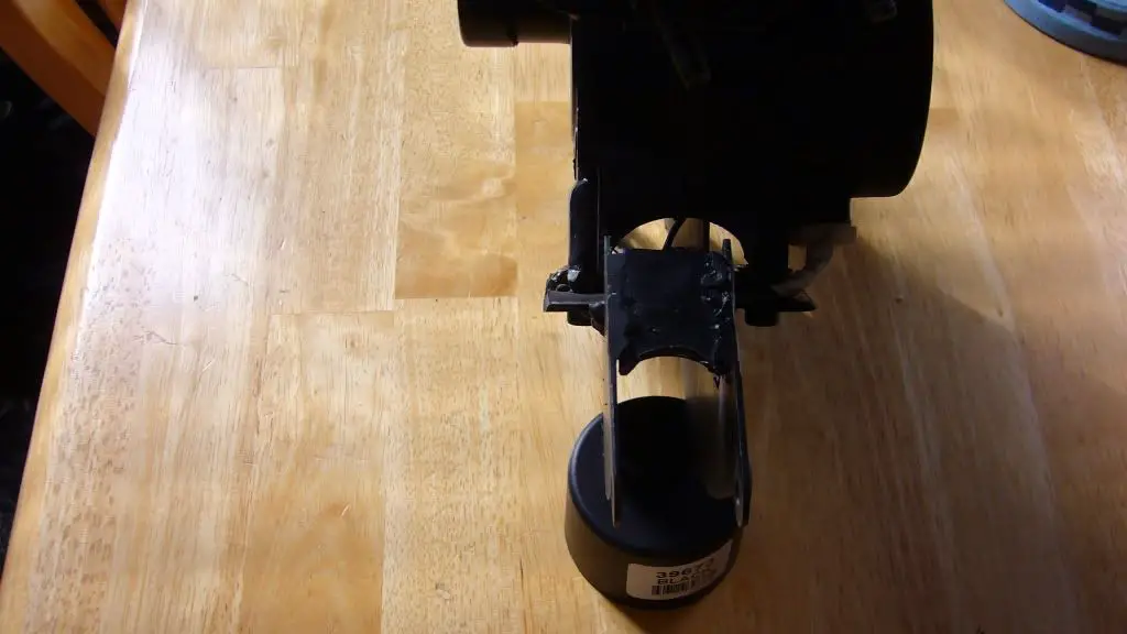

Finally got my engine mounts back from the cutter. I hope I'll have time to weld them next week.
I also noticed that I'll have to make a notch in the oil tank to clear the chain.

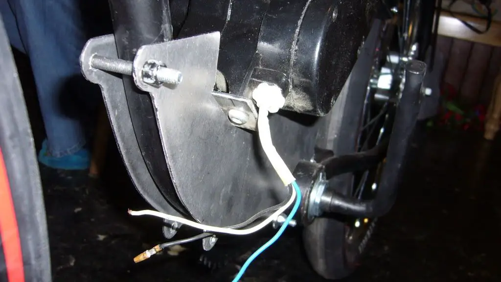

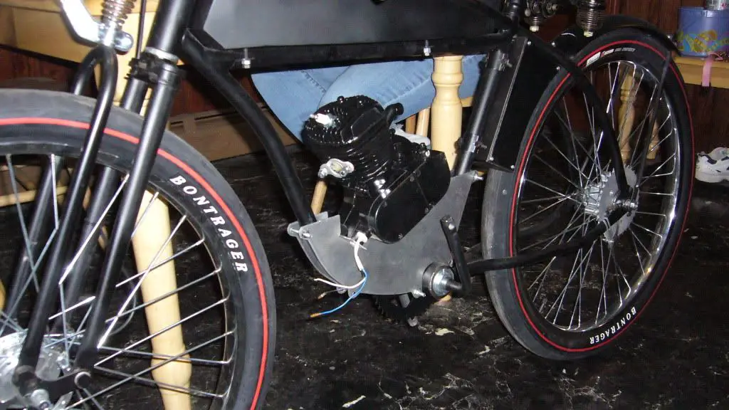

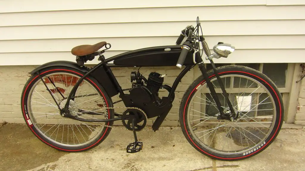

Well it got warm enough to dig my way to the shed and do some welding.
So my engine mount is finished . The whole mount and engine can be removed by removing 5 bolts. the whole engine assembly can be pulled from the bike with a hole 1/8 of an inch clearance without the carb on.
I hope to have it together by the end of the week. I'm weighting for a new longer spark plug wire to reach the electrics that I'm mounting in the rear tank.
And yes I know. Ugly welds.

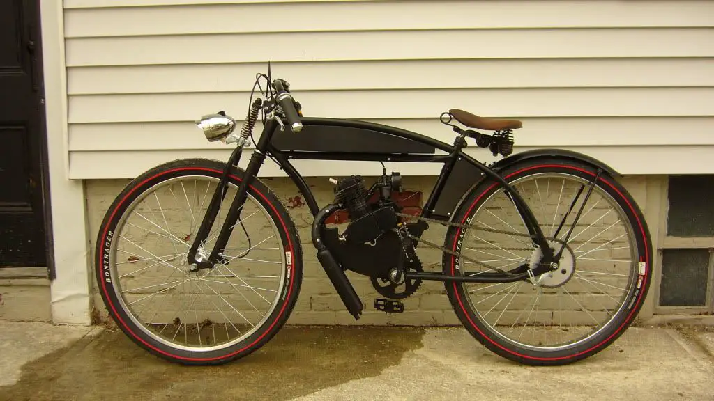

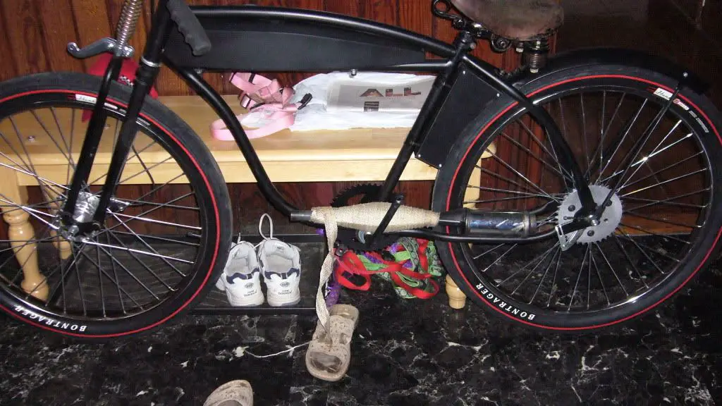

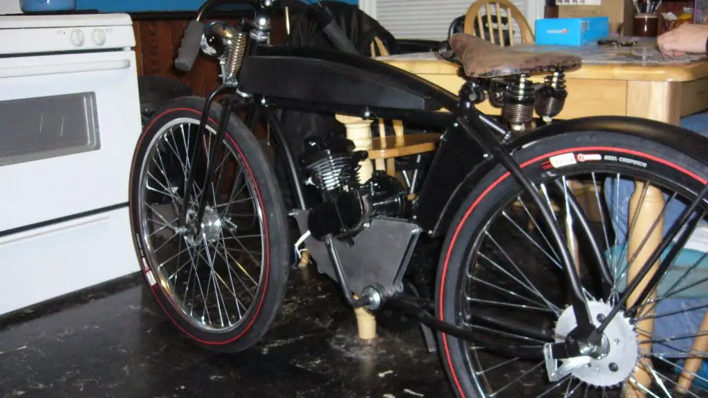

Ok, I couldn't help myself.
It's all together except for the electrics and the tuned pipe.
Hear is how it looks after a mile ride with the clutch in to check the chain alignment . It was spot on.
