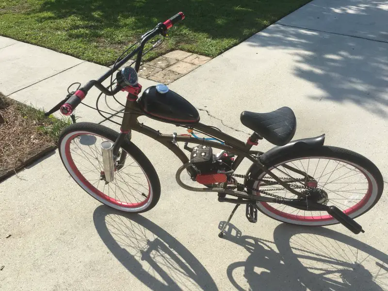

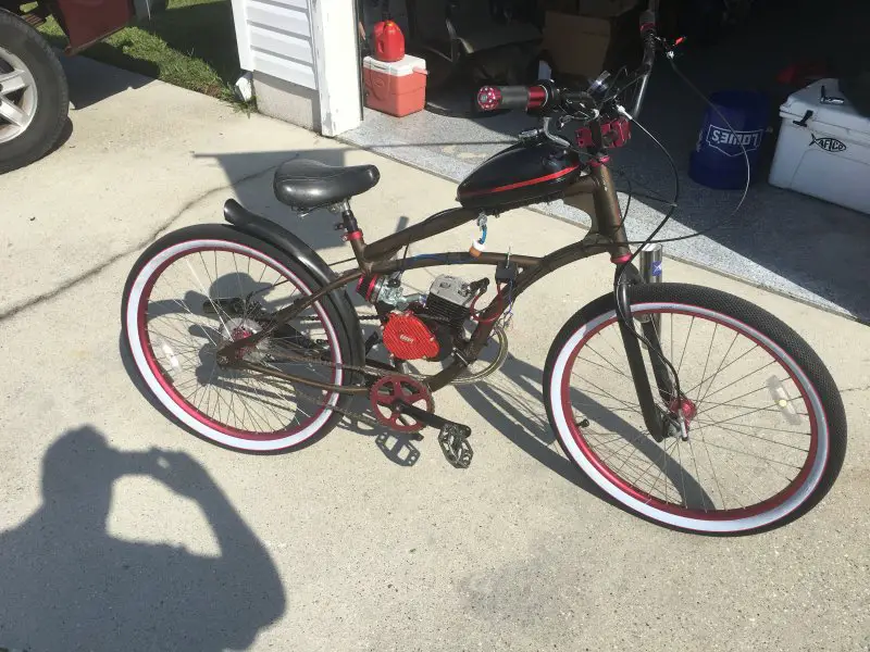

I’m new to this just built my first bike and it was so much fun building it I want to do another. I’m 45 (old guy) 6’4” and almost 300 pounds (big fat old guy) but a kid at heart like most of you. My question is can you port out the yd100. I hear the motor has good torque And me being a big big guy it might be the one for me. O ya my first build pic everybody likes pics.
