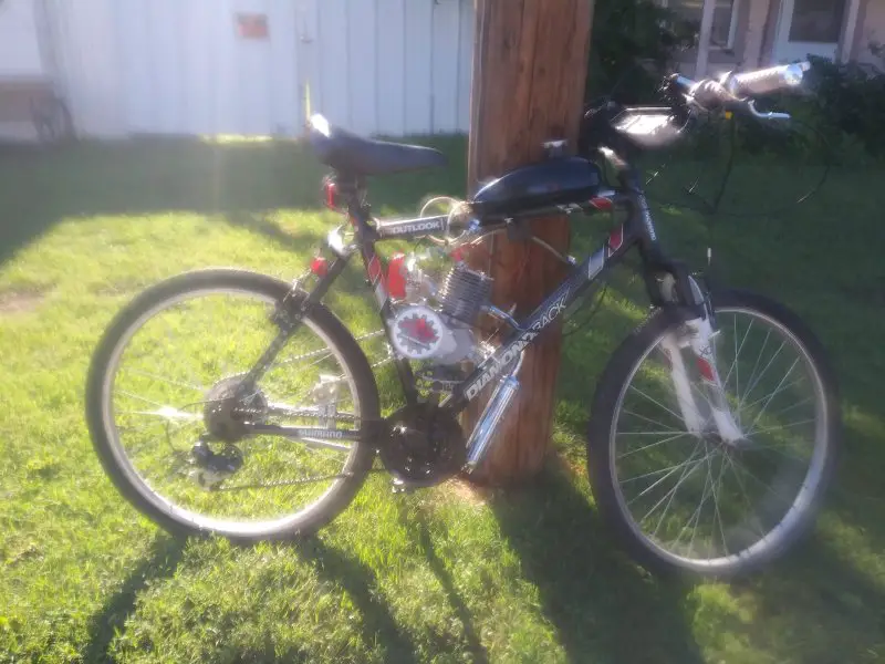

I had 80's but got this, it is as advertised. Much more power, and it is a torque monster, even with a 36t sprocket. I made my own pipe and it greatly improved performance. Everyone who sees it want's one and after break in with synthetic oil, a clip adjustment on carb, and new pipe, hit 51mph on a flat ground, after going down a hill. Fast as you want to go, trust me!
A few pics. The tunable pipe. These run poorly on a stock engine due to low back pressure. The muffler supplies that and the adjustable stinger varies the range.
