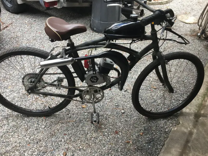

As expected this thing loves the little pipe. Likes the stinger almost completely in. The Zeda with the big Stihl carb ran best with it nearly out. Pulls hard til it 4strokes at the very top. Meaning instead of a smaller jet it needs more load, like a higher ratio. I've run the crap out of the poor thing. If it survives its a good engine. Fairly impressed so far.
Will have to haul it down to our causeway to tune it, too loud around neighbors. For another day, too much sporatic rain.
Nice to know the common CG exhausts fit. I was worried the flange height dimensions may be different.

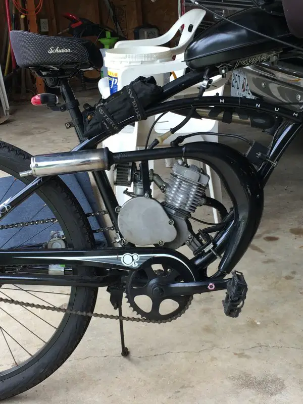

I cut down a stock muffler and tacked in on in a couple of different lengths till I settled on where it’s at, then I took the pipe off and welded it on.
Greg
That's a brilliant idea on the silencer!
Having a few of the mufflers laying around I took the shortest one cut the pipe and temporarily bolted it on. Its now decently quiet and as you said fattens the mid range with only a bit of loss of top end over the stinger. Will weld in place after I'm sure I'm through tuning it. Thanks!
I have to say the YD seems tough. I have thrashed it unmercifully and so far seems none the worse for it. Time will tell.
I cut mine at six inches, it was part of a broken muffler that I had been experimenting with, I welded a flat washer to the body and used a carbide rasp on my die grinder to open it up a little to slide over the stinger. I probably have two inches of stinger inside the muffler. It still sounds good, about like a stock YZ125 did when they were two strokes.
Thanks for the vid Greg!
Mine sounds Just about like that. I used a gutted stock 8" muffler.

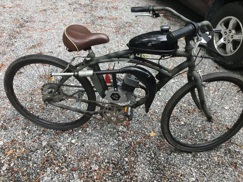

After riding the YD a good bit I have to say its a nice motor. It has run well from the beginning. Only had to raise the carb needle one notch to get decent running. Not much else, besides relieving the muffler. The pipe runs much better but its only on there because I already had it.
I installed a 40t sprocket. The 44 is just too low for this engine. Has the power to easily pull it and the cruise is way more relaxed. Another great thing is the reduction gears are virtually silent. Gonna put some miles on it now to see how it goes, but so far this has been the nicest CG I have delt with. BT 80 is next.
Been riding the YD a good bit, its getting broken in and is running great. I got suckered on the pre buy now they are $149. Mine was dropped shipped from Fast Bike Engines in Vegas. Last time I will buy from Bicycle Motor works!
Still I like the motor and 20 bucks isnt going to kill me. Its a good motor @ $169 even better @ 149. I'm sure the prices on the variations of this kit will come down as more sellers get them. Out of the box its a better motor than most CGs. I will leave it to the tuners to wring it out. I was looking for a pleasant daily rider and this one is it.
