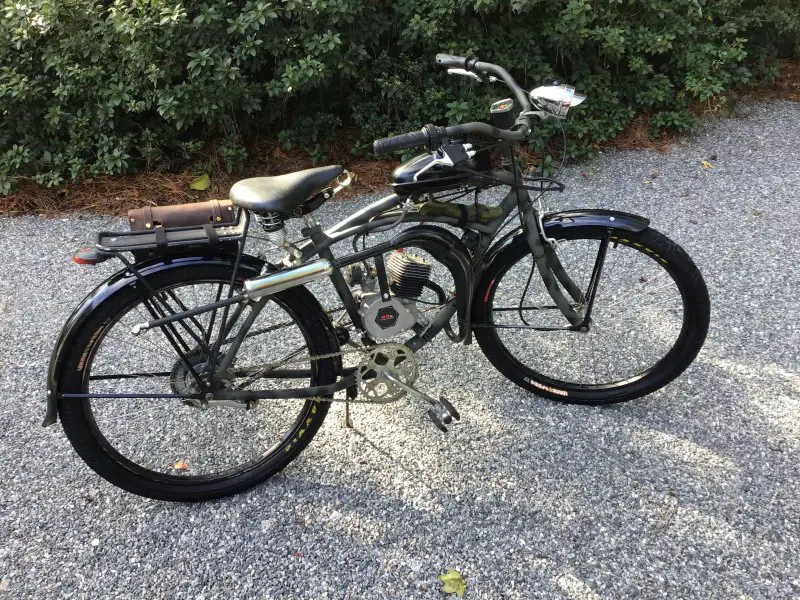

Here’s the YD and the pipe I run. It’s the $40 Zeda with a stock gutted muffler welded to it via Greg58s advice. This pipe does not run well as is needs back pressure of some sort. The muffler is a good way to go and is quiet too. Is very tolerant of the small stinger pipe which is there to get oil away from the bike, thing on the end is a deflector.
So I feel this ride is fully developed for a daily rider, pulls like a freight train from lugging along at 10 to a top of 38. Before the timing it hit a wall around 34. This is the most pleasant and useful bike to date. Now waiting on a Runwell PK to replace an older CG on another build. We will see how they are soon.

That pipe design works well on mine also, the large stinger purges too much from the cylinder with the jetting I’m running, the muffler add on helped greatly.
