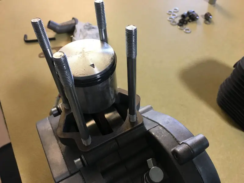

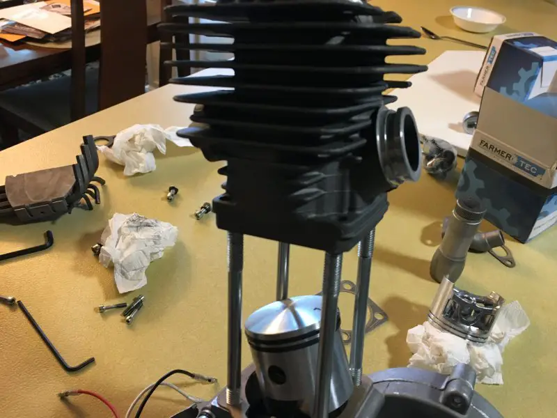

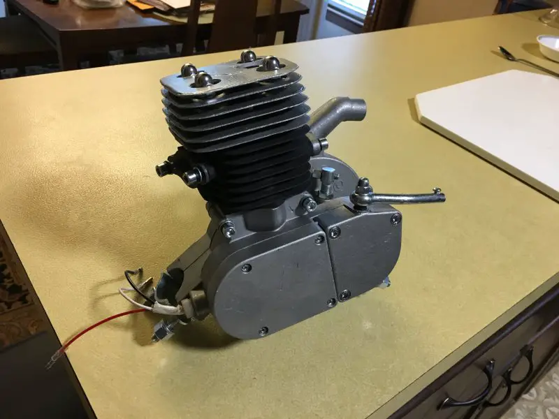

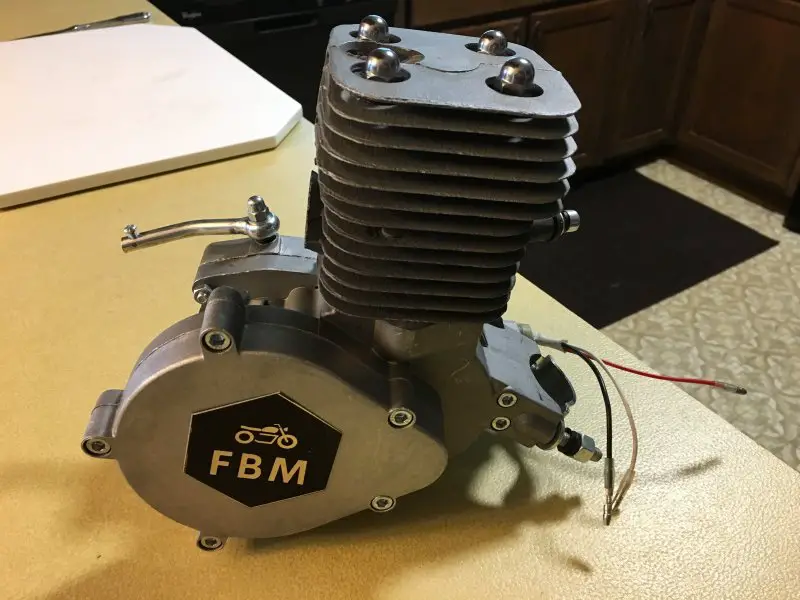

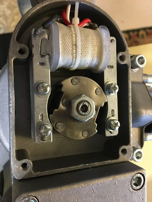

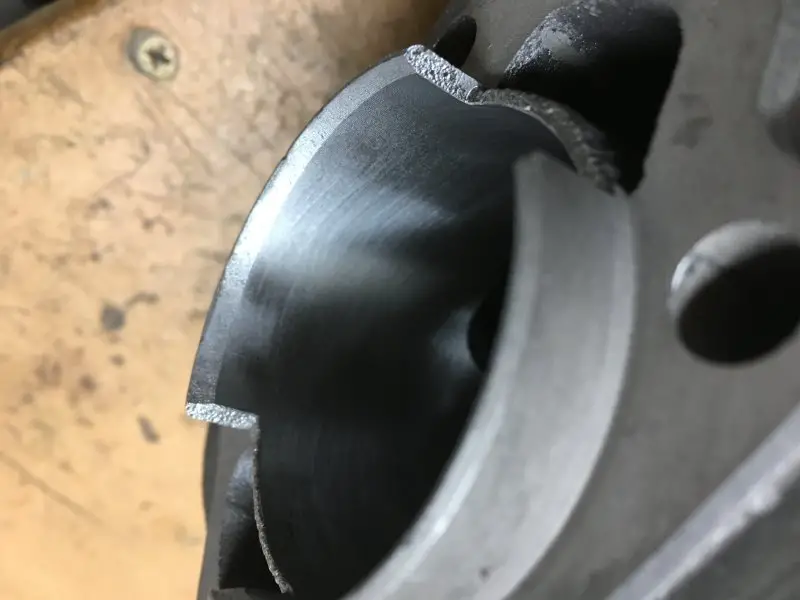

Got the YD today. Full kit ,seems good quality have seen worse. Pulled the jug sure enough was piston backwards. If they are all like this maybe thats the correct way. Turned it around any way. Cleaned a small bit of flashing from the ports greased the gears, not a wisp of grease as received. Port matched the gaskets spiffed up the cylinder with a bit of black paint and called it done. Cylinder doesn't appear chrome but it is hardened. Rod has large oil reliefs. Mag appears better than most, sposed to be hi perf. Plate on motor is FBM came from Fast Bike Motors. Hope its not F in Bad Motors!
What I did find was the stud spacing on the jug is larger almost to the point the Stihl jug could be fitted, also the 12mm wrist pin may fit with a proper size bushing food for thought. May get a chance to try it tommorrow.

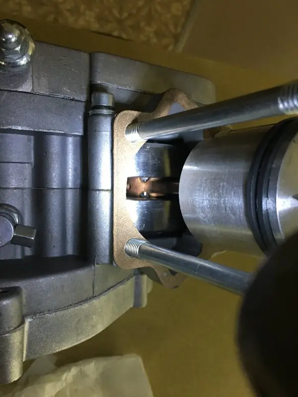

If the ring ends are on the outside of the exhaust port it may not make a difference, what I see looks good. Would be interesting to plasti-guage it to see what the squish is. That engine should have a lot of good power.
The ring ends were out side of the exhaust port but changed it anyway. Can't say on the piston skirt as I reassembled the engine before thinking about it, can't see down the intake and the gasket is glued, sorry.
The ports are rather small which means the engine is probably designed as a low end engine, something I was wanting. With porting and a better exhaust I'm sure there is power in there.

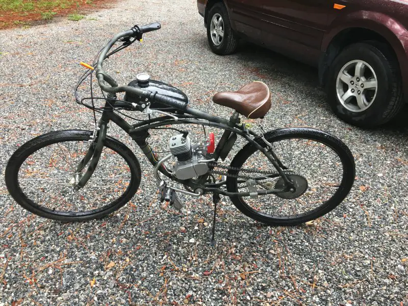

The engine in the link is another one still, I guess this is the trend. The pipe requires a lot of tuning. I have one on a zeda 66/80. In fact the YD is going on the zeda bike. I also have a 66cc engine with the single piece cylinder I have never used. The YD came along before I got to it. Will be swapping the engine this morning. If it quits raining may get a run soon.
I rode my bike last weekend after changing to the expansion chamber, it helped mid range the most. I like you am not after speed but a good ride. Your engine will probably be good as is.
Got everything swapped and got a few test rides in light rain, either dedicated or nuts.

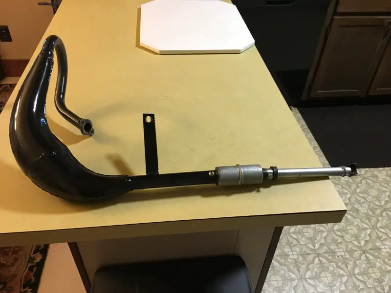

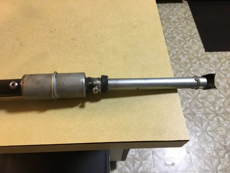

Had to raise the needle one notch. That helped but the exhaust was way restrictive. Couldn't hardly hear it. Cut the tube flush with the cap and that woke it up. It makes great power down low on up til it revs out. A 44t as I suspected is a bit low.
I'm a founding member of the ride it like you stole it break in club so I ran it really hard. Its really fun to slam it open. Fat power til it flattens out I'd say around 30. Gonna try the pipe from the Zeda next. After It has a bit more "break in" and tuning will change to a 40t sprocket.
A few pics. The tunable pipe. These run poorly on a stock engine due to low back pressure. The muffler supplies that and the adjustable stinger varies the range.
