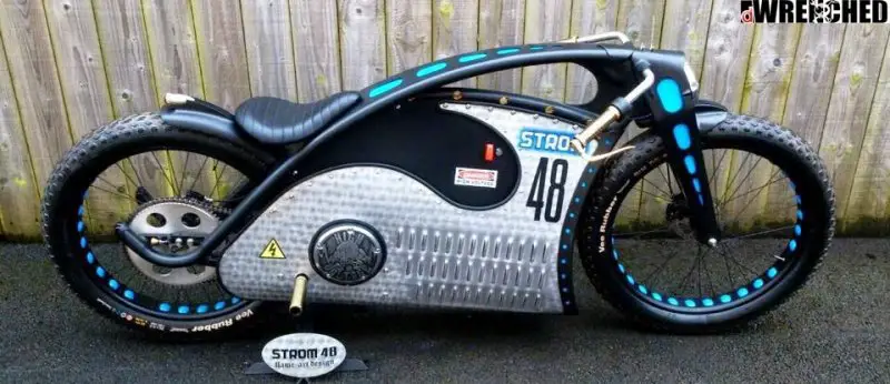

For inspiration, check out what this builder did to break up the expanse of side cladding on his e-ride.

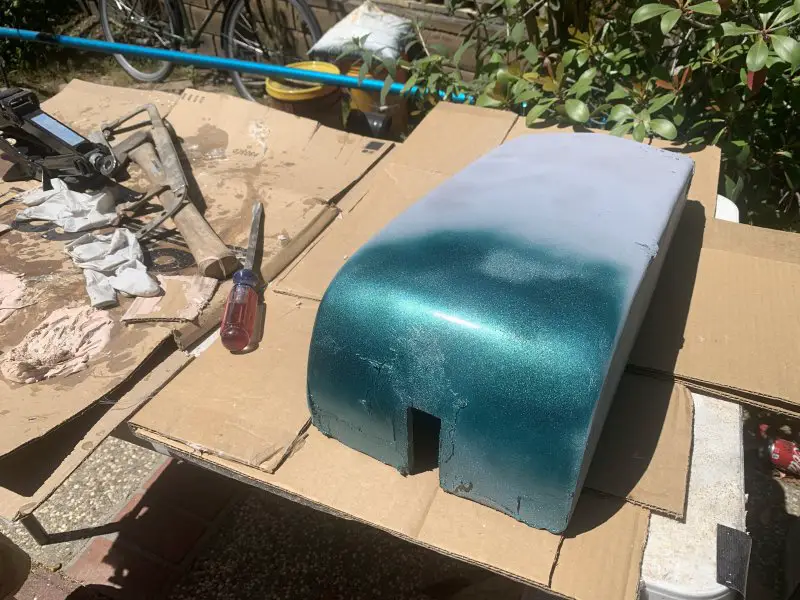

I know you're desperate to just get it done, and a single colour spray job is the quick way out, but my take on paint finish for your latest build would be to break up the large expanse of the side covers (and tank) with a simple but effective 2 or 3 tone livery. Easily masked and executed. Half an hour spent doodling should be enough to come up with a plan.
I'd be wary of going down the vinyl wrap route. Done that - and it's hard to get a top notch finish on anything other than perfectly prepped, glass-like surfaces.
Another take - and probably the quick and easy route to the finish line - would be to go down the military route with a matt paint/graphics scheme. Just for a change, how about navy grey/white rather than army olive drab?

The bike Pete posted is a stunning streamliner. Great piece of fabrication...lotta hours in that one. Looks to have an engraved motor housing.

Tony, once mastered and after a few practice runs on small test pieces, laying down vinyl wrap is quicker than you'd think. Use of a hot air gun (hair dryer will do at a push) is mandatory to help stretch the vinyl, particularly around compound curves. Air bubbles will inevitably occur whilst laying down the wrap but are easy to expel using a squeegee or even a pin prick. Biggest issue is that even the teeniest speck of surface imperfection or dirt under the wrap will show up as a bubble - and those can't be expelled the normal way. For us DIY amateurs at home airborne dust is the enemy during the laydown process. As I already mentioned, surface prep is the key.
Liking your metallic green & black paint choice. I know you said you're going with just black on the bike's side panels for now, so get 'er done and get riding. But when/if the time comes, a two tone green/black scheme on there will look spiffy. I hope the pic I posted for inspiration pointed you in the right direction. Colour splits don't have to be straight lines.

I’m done painting the bike and it does look like a rattle can job. But hey if it looks good from 10ft that is fine with me. Has to look good enough for a rider. Might wrap the box AND the tank in the future.

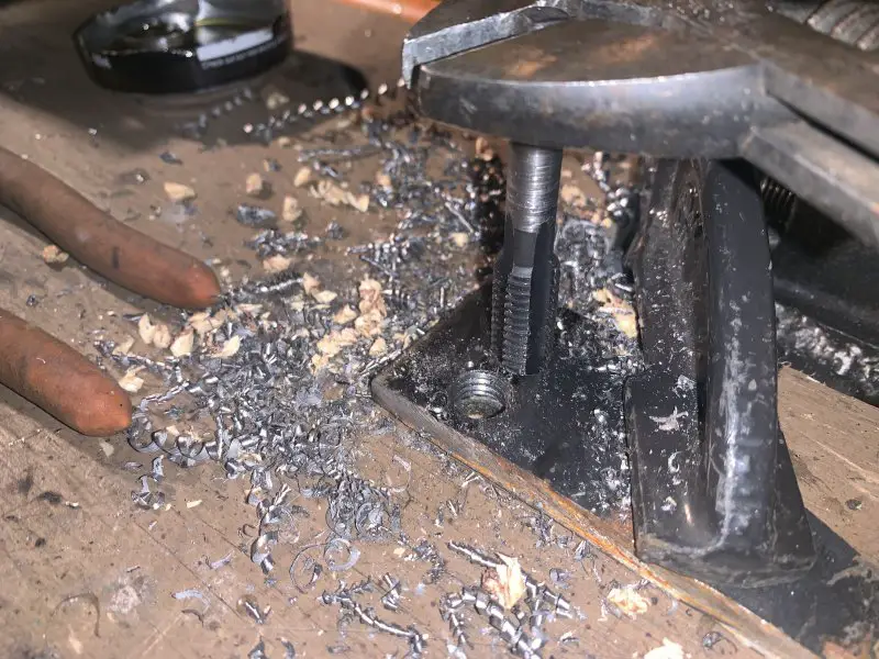

Working on the kickstand, drilled and tapped two 1/2-13 holes for the mount. Tried powertapping but couldn't get a good hold on it with the drill chuck (always used to power tap thru holes on the Bridgeport without a Procunier, turn it on slow and feed the quill slightly, then reverse direction and nurse it out). I’m aware I fully deserved to break the tap using an adjustable wrench on it...

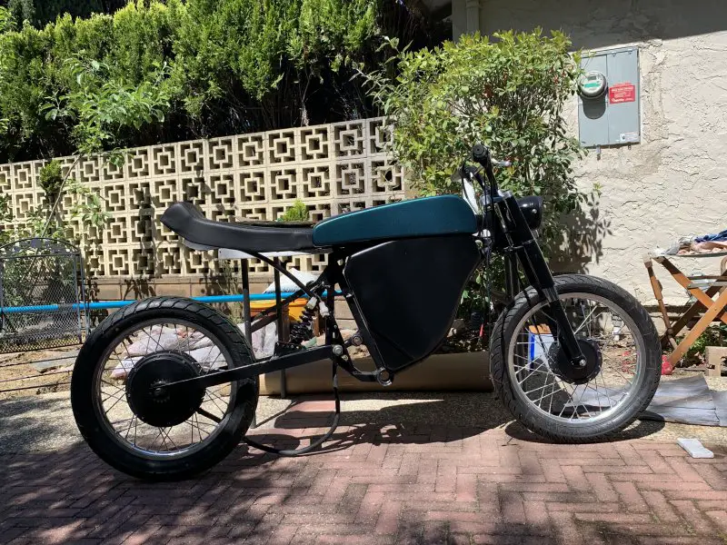

Welp it looks like I have only today to complete my bike with my tools at home. Got a new job so I can do some real world commuting tests. Gonna try and work fast to get ‘r done...

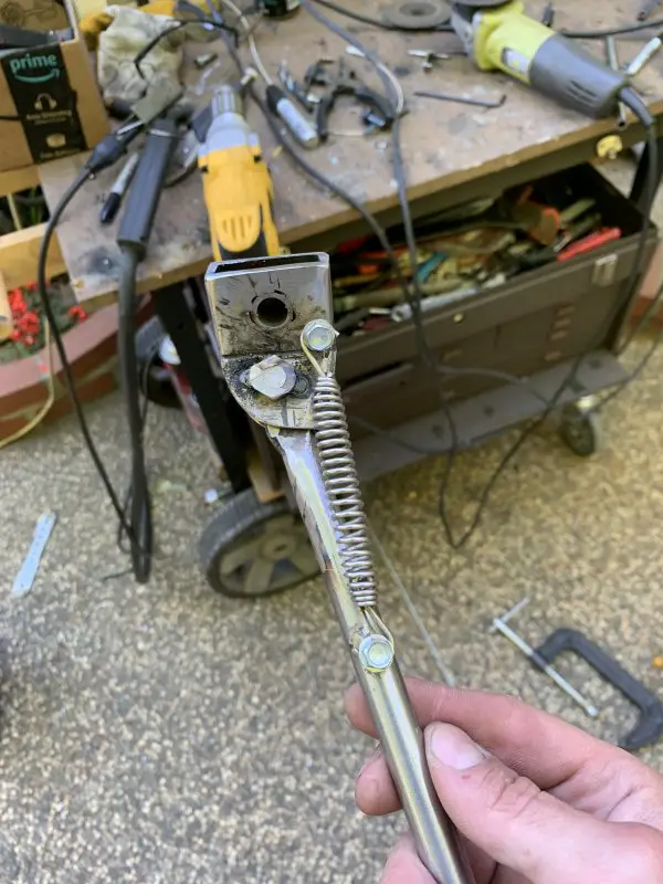

Edit. Yup got her done enough to ride. Half charge still in the battery from September. Fabbed up my kickstand. I used some chinesium in the upper part of the leg and it’s weak. Bout to break. Have to make a new leg. Have a 24mm Crapsman wrench waiting for its day to shine. Hooked everything up. No pedals no rear light no fake tank. Just the basics haha.

Yup I’m lucky. I put the pedals on. It was a job. Need to finish electrical. More later...

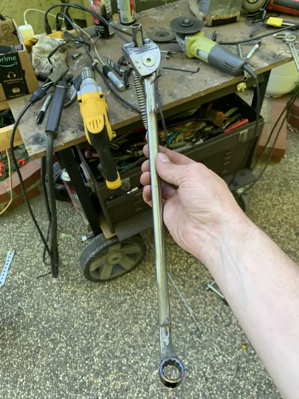

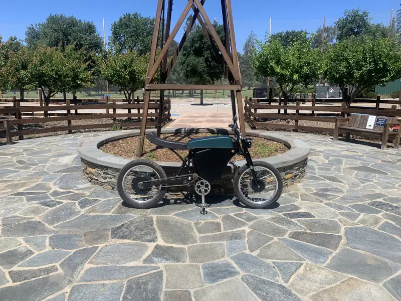

Made a new kickstand cause the other one was too weak. Also made a secondary chain tensioner with the spring anchoring on the kickstand. I’m setting up this bike to never fail.
Well I’ve tested it for a week of commuting. I find that going slow ie less than 45 is pretty easy and enjoyable. Wind resistance gets tough at higher speeds. Sorry I made you guys wait a week.
Using a throttle backwards for regen really is nice. Very natural just as my vendor said and keeps the handlebar cleaner. The mirror messes up the look but is needed for riding.
I got my electrical finished and the tank mounted. Used a moped switch for the lights. Takes up very little space. My ignition is just on/off on the bar so anybody can steal it unless I set power to zero through the app. Gonna mount a key switch soon. I am going to move the tank forward an inch as there is too much space between it and the top crown.
I’ll be bringing my big charger to work and have it live there so I could have to carry my small fast charger everywhere and risk it getting damaged with travel. Have to solder in some pots on the boards of each 24v 500w PSU that makes up my 3s fast charger.
I replaced the chinesium in the leg of my kickstand but the upper portion has cracked also being chinesium. No Ch in the frame, all of that is American steel new and old. Gotta make a new kickstand upper mount this weekend. Bike is heavy!
Overall rides great. Needs more range. I’ll be getting those LG Chem 120ah modules that can be split into two 60ah cells. $500 worth to end my range anxiety, probably going to be around $600 with shipping. Pretty good deal. Gas is cheap now but. It’s a really pe@ceful ride with what little traffic on the streets now. Haven’t been late to work yet. The one day I was almost late I topped out in the 70s and nobody saw me. But the days since then I keep it under 55. I ride it like I used to ride my 212 only I smoked a Porsche off one stoplight...

That bike definitely looks fit for purpose. The extended swing arm gives it an aggressive street presence.
One week of shake down riding and no real issues reported other than gripes you were already aware of. That's a win in anybody's book Tony.

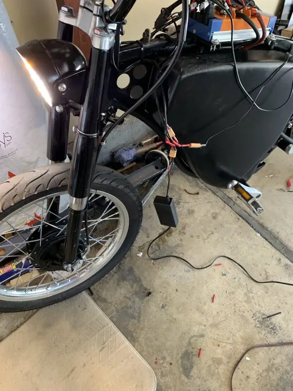

I was working on making a riding video last night and then my 12v 3a dc-dc converter for lights died on me. Fortunately I found this 15v 5a power supply that I probably used for one of my rc balance chargers, I’m gonna use it for lights. Test below.

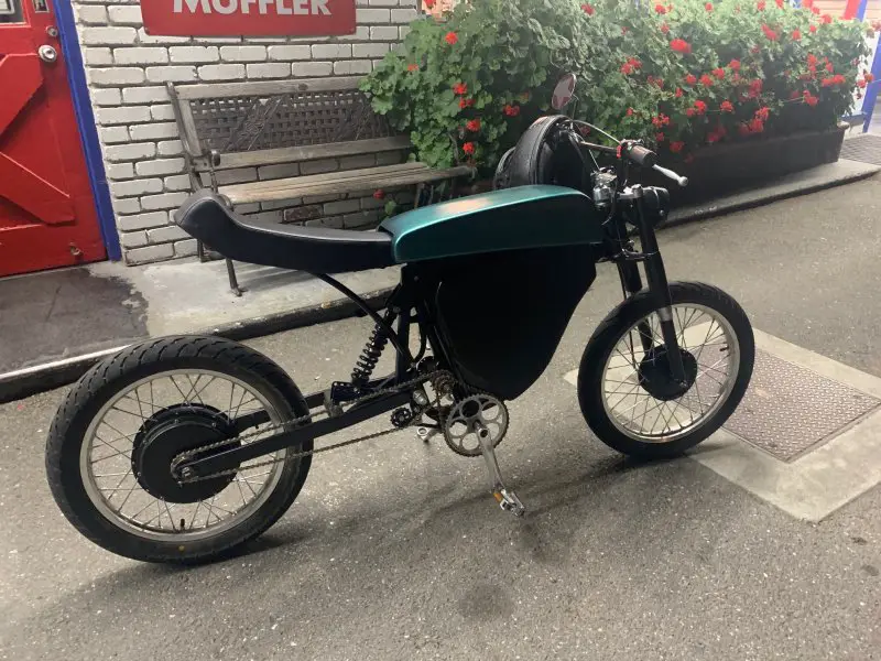

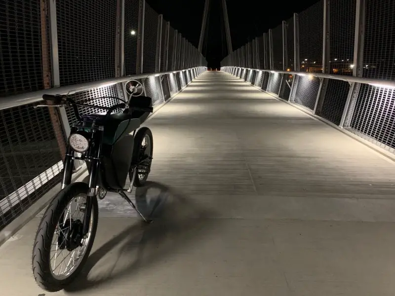

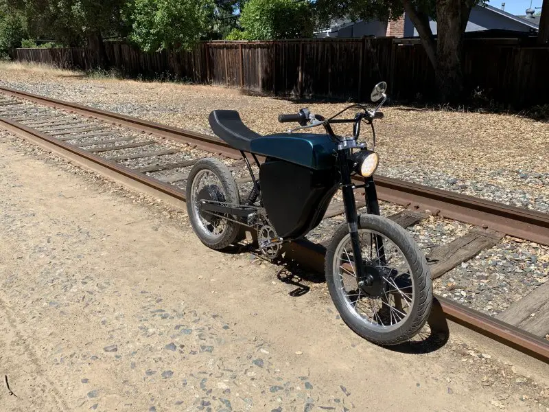

I’m still not super happy with the look. Tank is too high in the front by about an inch. The lower line needs to end where the original seat stays did.. a mistake in fabrication. Just gotta cut some more of the fake tank in the front slot.
eventually going to cnc cut a new tank/seat piece from foam, glass it again..

I think it looks great, but it's you that gets to decide and you already know how to do this stuff. I and many others have made many changes to suit ourselves, just an ongoing part of projects. In the meantime ride heck out of it and report the results from time to time (with photos) wear it out and rebuild!

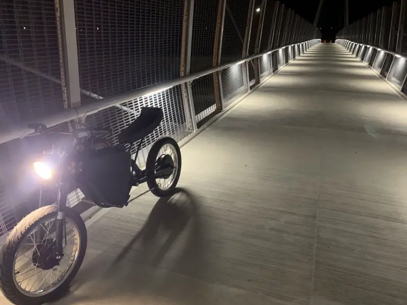

Daylight quarter angle with light on cuts the headlight glare for sure and looks good.
Yep Rick I remembered and switched that light on just for you. I’ll try to make another night photo. Far as the styling, I kind of knew it would be a tough one so I decided to get the rest of the bike close to the dimensions I wanted. I just went with the squarish tank to match the seat. Don’t like either one too much but, they work for now. Had a different idea for the seat but saw this one for a good deal from treats and made it happen. Project was already getting too complicated, had to keep it simple. This seat is solid and doubles as its own subframe. I want to go with a much thinner profile seat, and a 3D curved tank with a thin tail end. The tough part here was getting the tank to seat blend good with it being around four inches thick in that spot. I wanna drop that dimension under 2”. I’m still in the research phase about making a seat so the current configuration will have to do. Hand sculpting foam is extremely difficult to get symmetrical. I think I’ll be better off directly cutting the mold...
the ride I just did, I thought the camera was on and I was recording video for you guys, but it was not on.. you shoulda seen it, I ran over a rat on the bike path. The rat would react and run in one direction, but then I’d counter steer and it would react to that and run towards my centerline. I ended up hitting it dead on. I slowed down to make sure those guts didn’t fly up on me off the tire. Too bad my camera was off it was amazing.
