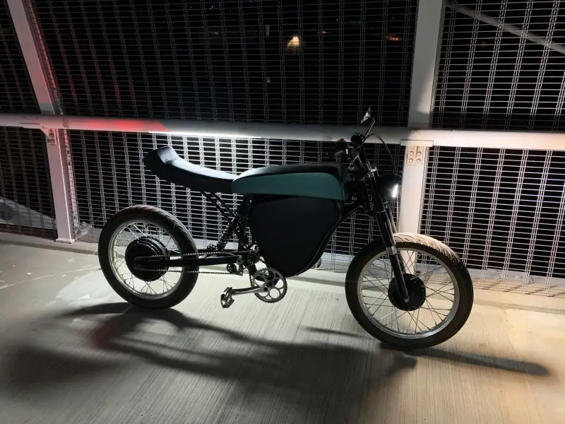

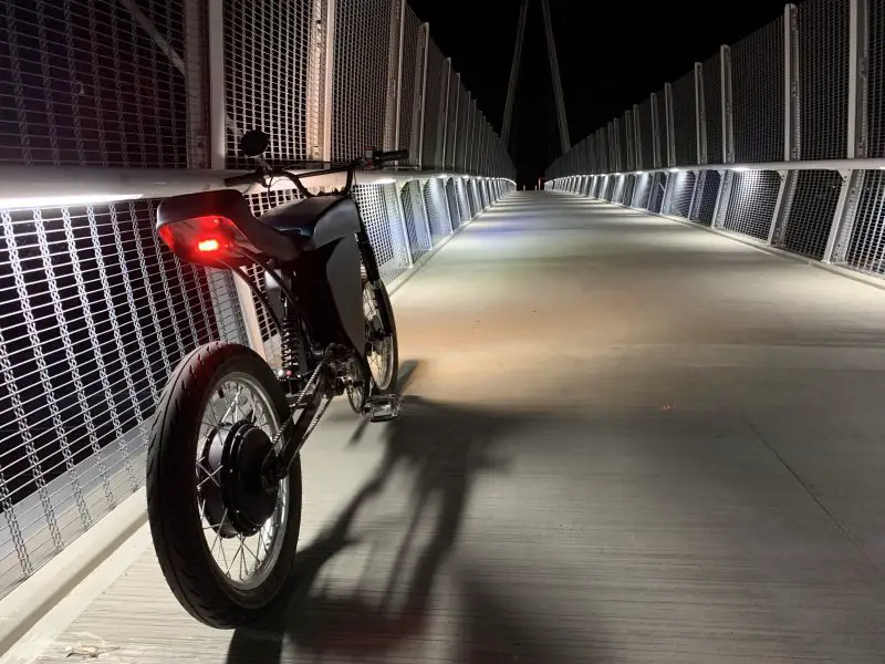

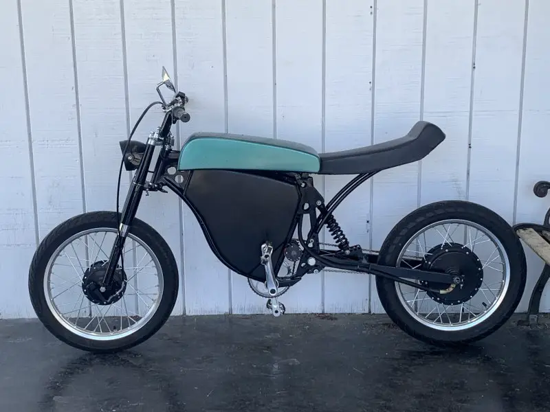

Couple more night pics. The idiots who might as well be the rioters and looters covered my favorite bridge with their slogans. Took it all down. You know the regular stuff., black this, police that, “silence is violence”. Silence is NOT violence. Rioters shutting down a local freeway the other day, stopping traffic and breaking commuters’ windows with crowbars, getting them out of their cars and beating them up, that is violence. Strange stuff going on.

Sheesh Tony. What with the Corona virus lock-down and now the BLM demo's/riots, things went from one extreme to the other in short order in the States. Stay safe.
This is another one of those occasions where I'm glad I live in a country where access to firearms isn't ever necessary or even an option.
How much suspension travel front and rear Tony?
Looking most excellent!
Rick C.
Rick it is 3.4 inches front, and around 4-5 inches rear. Can’t really know the actual rear travel without putting a camera on the back.

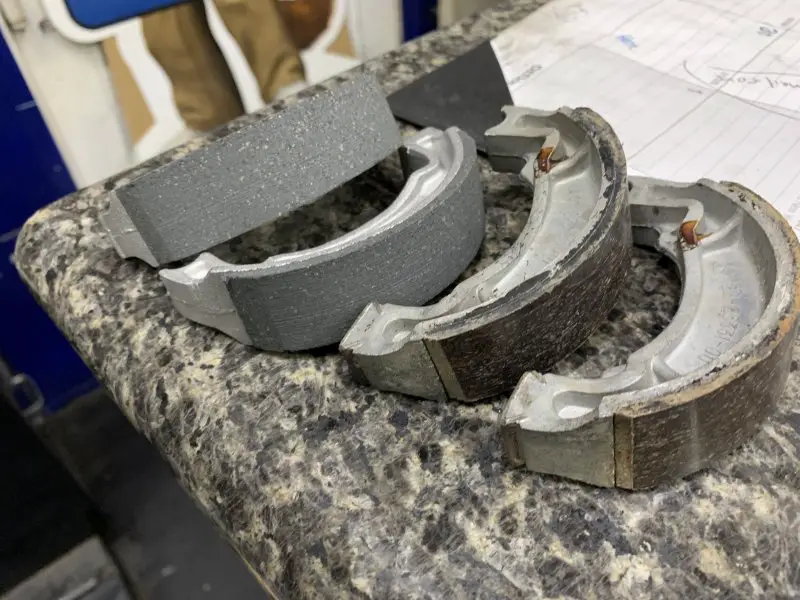

I put new brake shoes on the 51 year old front hub. I guess the old ones could have been original from 1969...

That's good travel & great wear on the brake Tony.

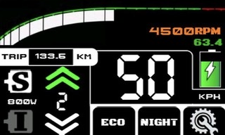

This firmware is designed for a custom built display I bought a month ago that my vendor has been working on. Touchscreen, pin login, full access without having to use my $900 phone in my left hand while testing the bike with the right. Cost $100... Gonna be here Monday... probably gonna have to machine a clamp shim for it, if it’s designed for a 7/8” bar. The middle section of my moto-x bar is around 15mm...

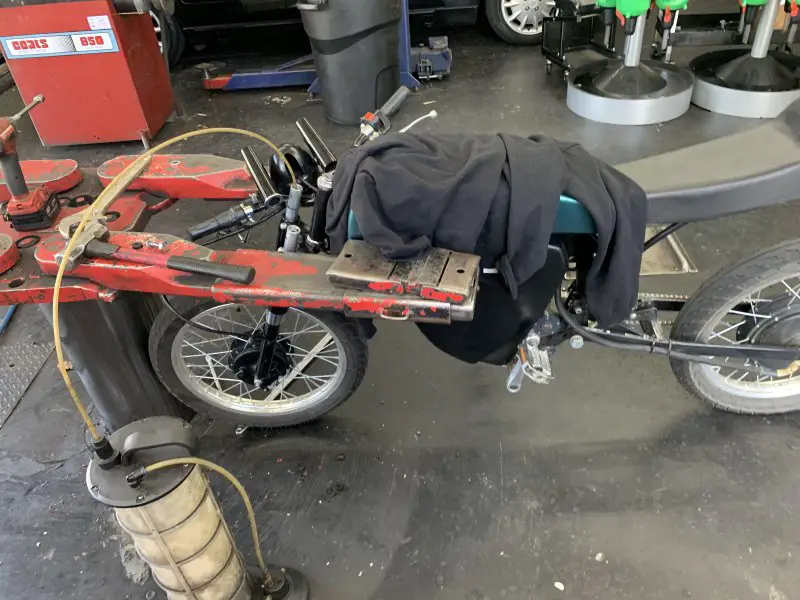

Replaced the fork oil with 20w. Was 10w. Huge difference in performance.

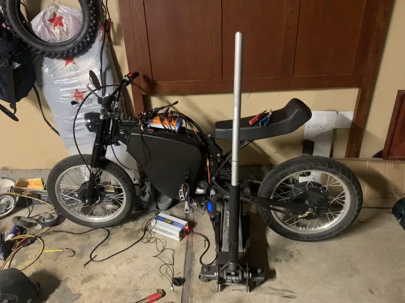

attempted to remove the spring preload rings. Stopped short of removing the legs. Decided to leave it for another time. Big job.

have some controller issues too. The display came and worked for a couple days but then I pulled over while on a ride to change some brake settings and the it changed some other setting, make the Bike not running. Had to get a tow. Getting fed up with my vendor, who only delivers lies and disappointment. He does seem to treat me better than the people that have paid him and are waiting 6 months or not even getting their stuff. Put my name on a waiting list for a high power controller from another vendor. Meantime I’m trying to get it worked out. Today set up an old android phone to let him try and set it up remotely. Failed. He is sending me another, says he will ship tomorrow but with him that usually means “go away I’m busy”. So I might have it in a week or two. There aren’t really very many options for quality controllers, but if I can get something similar, less power even, and not have to deal with my vendor, that would be great...

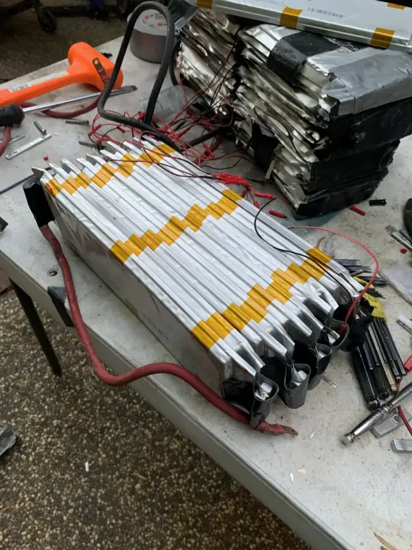

Getting it running again, new controller from new vendor, and I’ve begun building my new battery.
I’m punching a single hole in the short tabs of the cells, and cutting a few of my bus bars for the old cells in half. Just need a short 1.5” bus bar with one hole. This build will go fast...
The first 10s1p brick is done. All the cells are right at 3.48/3.49. Not even bothering with balance leads right now. Pack this size will take a while to go out.
