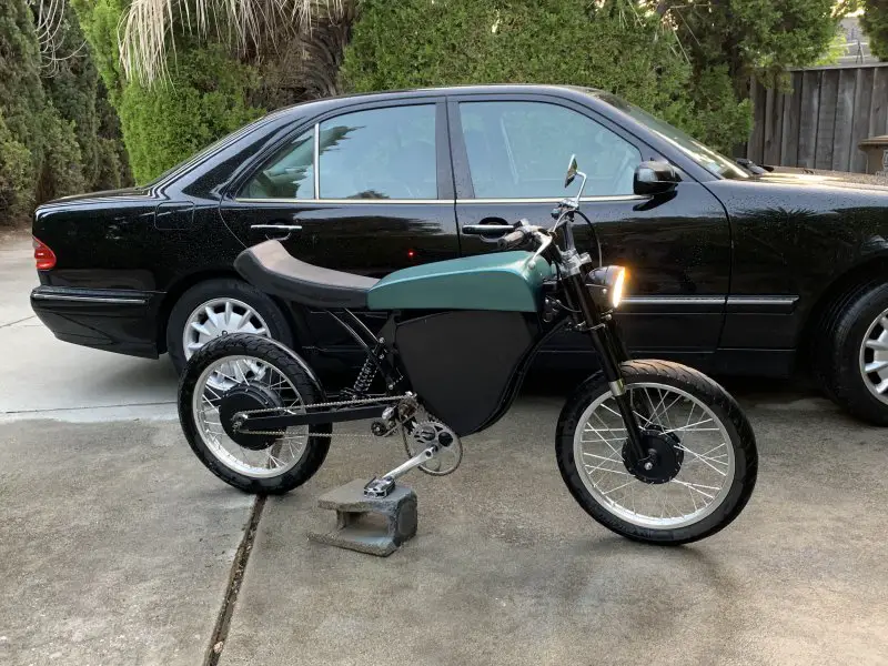

World’s fastest Schwinn cruiser

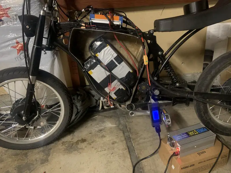

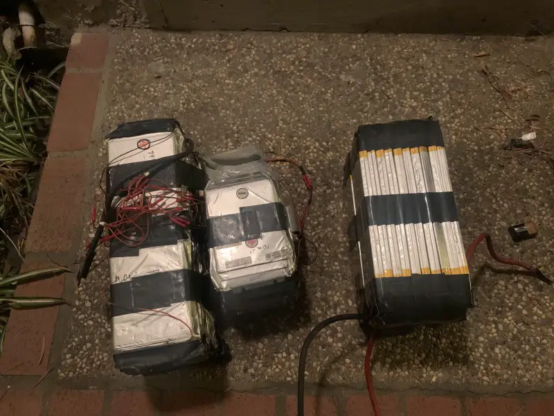

New battery is in, it sure is a lot more compact and almost 2.5x the capacity. Old 1.9kwh left, new 4.4kwh right. Lots of space in the box now, filled in with foam. Space for an onboard charger! Have to wait for funds to come back up a bit, not sure if I really need it but it sure would be cool to plug in to a car charging station..
