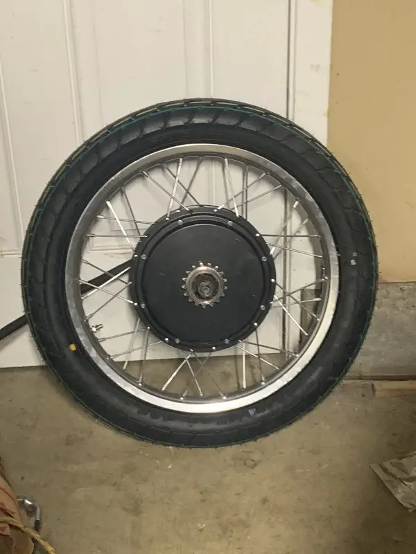

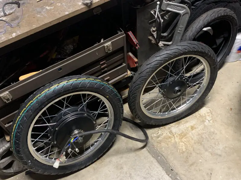

90 tire came in two days ago. Day and a half shipping, and only 3 months old. Amazing service!
Mounted it up on the rear, still need to air it up at the shop, but just look at that, what a difference. Gotta see about that 70 front tire. I might keep it, if it looks good spinning. I’m not convinced on that bead though. I’d rather put the well seating 80 on there for peace of mind.

Is that on the 1.4" rim? I am looking at similar wheels and tires but was thinking they wouldn't seat with such a small width. 17*2.15s are hard to find or too expensive
So the rim strip I got from the motorcycle tire vendor was too wide and was getting in the way of the bead seating well. I replaced it with duct tape. Regardless, I weighed out the 70/90-17 and 80/90-17 and weights are 5.4lb and 6.25lb respectively. For all performance purposes the 70 was the smart choice however I value the bigger tire look a lot, so I put the 80 on the front. It is still a lot smaller than the 90 rear. I have been working on other parts of the bike but did not stop to take pictures. There are dozens of little odds and ends that need to be tied up, just going one by one. We have at least a week of rain so doing the stuff I can do indoors.

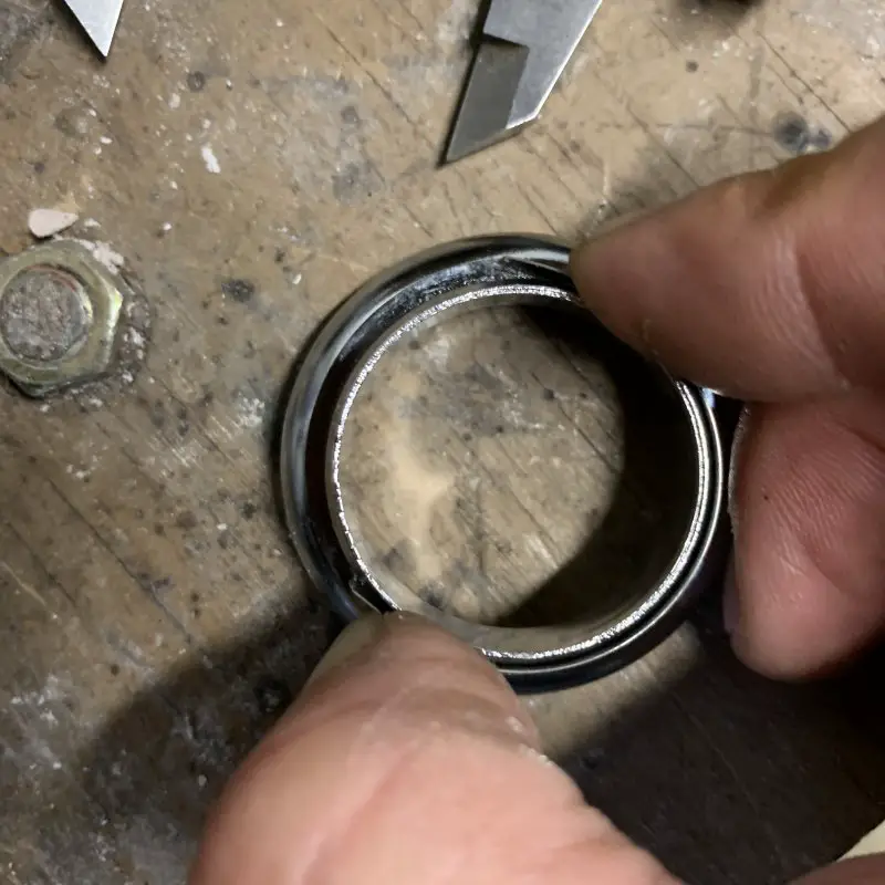

Pressed in my headset cups and mounted the front end. The head tube bores were stretched a bit. Head tube measured between 1.283” and 1.305” depending whether it was getting measured side to side or front to back. So average diameter about 10 thou bigger per side than my cups. I found some stainless exhaust wrap ties that measure .009” by about 5/16 wide. Perfect fit.

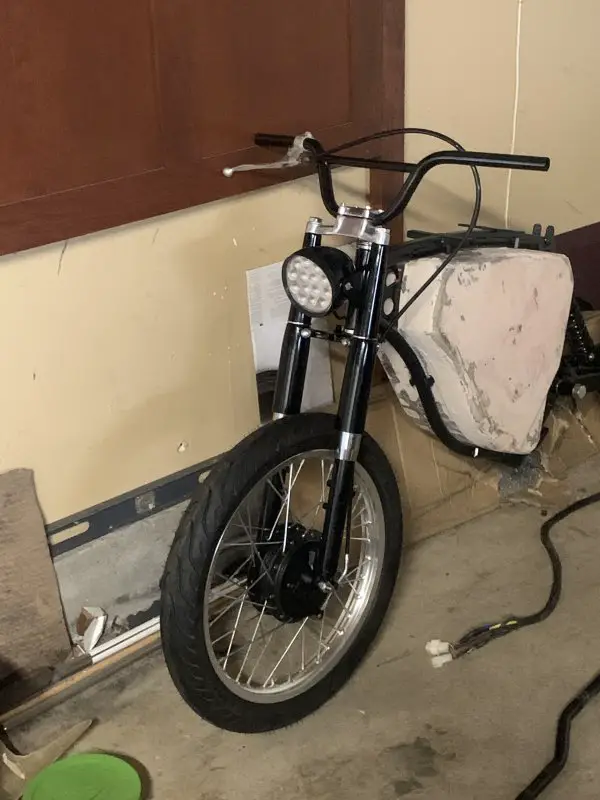

Got started on the new shape for the fake tank. So far it’s just a cardboard shape. I need to transfer the shape to foam then do the work.
I may not have to shorten the swing arm. Although I can take out 1.5” without rubbing. I will see how it rides and looks. The cut would be easy. I found an online metals vendor with perfect size material to sleeve and plug weld my 1.5x.5 swingarm tubes. It would cost me $20 shipped for two pieces of .375x1.375 steel stock and probably two hours of fab and paint.
Also figured out how I will mount the headlight. Will try and finish as much as I can tomorrow.

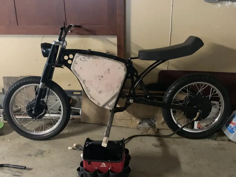

Big tires... big improvement.

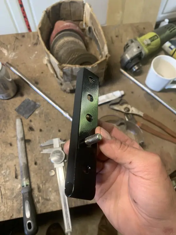

Thanks Rick. I ended up finding the other seatstay. This is really fortunate as I really needed that half inch tube for spacers and kickstand. Grinding off around 5 per side of the threaded tube ends allows them to be a perfect press and plug weld in the seat stays. Got almost everything prepped, need to make lower mounts and stick it all together.
Also will be moving the seat back about an inch and two. It will be adjustable. It’ll fix the look and help with legroom.

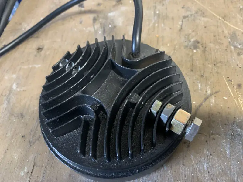

Headlight got two 5/16” holes through the fins on each side. Nuts and spacers epoxied in on both sides, bucket goes on tomorrow. Regular side mount setup. Lot of work for a light, but this one is worth it. 84 watts and $20 for a 2-pack.

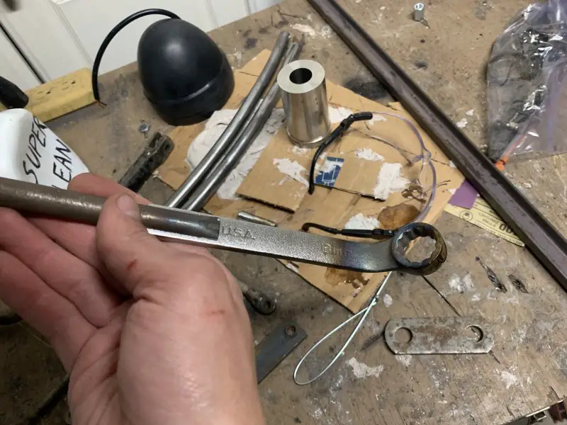

Got started on my wrench kickstand. Don’t think I’ve ever used this quality USA made wrench.. 18mm what a shocker.
Tony I save and collect tube in various and sundry sizes I.D. & O.D. for the occasional slip fit connections and still at times have to use the lathe to get a proper fit up but with a variety of sizes to choose from machining isn't required as often.
I like the look of the light housing.
Some sizes aren't often required in metric or fractional tools, but they are available when needed. Mechanically it seems you're getting close to the finish, but know the details take time to do right.

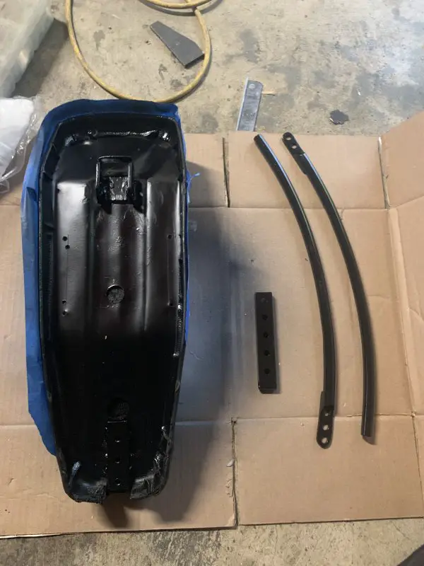

Worked on it some more. Just more prep. Yessss all the little stuff does take time. I’m working on half a dozen little things at once. Finished the headlight bucket. Has to look old school. Drilled and tapped all front seat mount holes as needed, almost done with the new part which is the front seat mount adjuster. Bolts to the seat with a 5” adjustment range. Prepped the new (original) seat stays a bit as well. These will be lengthened slightly. I need to be comfy.
Seat parts all done and painted. Finished the front mount. Headlight done and mounted up. Kickstand done on the low side. Gotta fab the kickstand mount before cutting to length... beginning work on the tank.

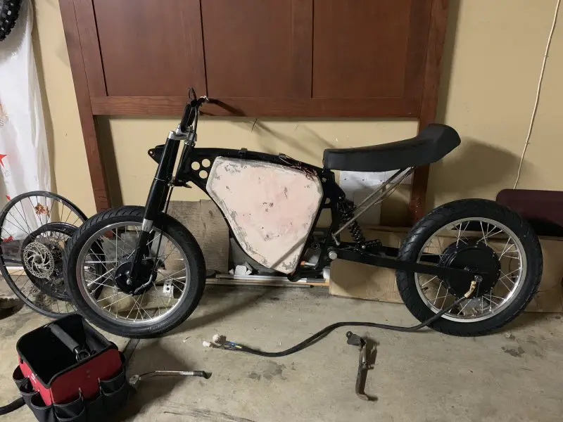

Yep I can just chill and wait for time to pass and battery tech to improve and trickle down to the hobbyist. No need to travel around the world. My world spans less than 100 miles. I have been looking at batteries. It isn’t worth adding or upgrading right now.
I want to ride this thing now more than ever. Traffic at its record lows...

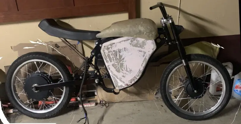

Seat at the furthest adjustment back. Feels good. Might bring it back an inch or two. No swingarm shortening required heh
