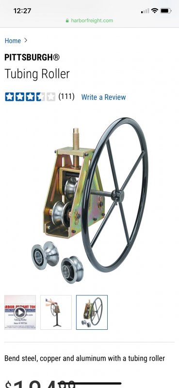

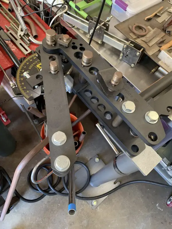

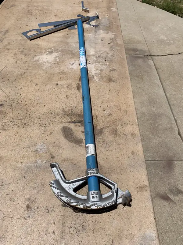

I assume you bend your own tubing. could I get a picture of what kind of bender you're using?

Thanks for your interest, I used the harbor freight tubing roller and a electrical conduit bender, have a new JD2 bender that I use Now instead of the conduit bender. The conduit bender Works pretty darn good tho. Used .065 mild steel for the frame.

Thanks so much for the resonance. I was hoping you had done that work without a $3000 bender. I was planning on getting one of the harbor freight benders anyway, or building one. I have a lathe and a mill, although it needs a super clean up. I just got it used. So I plan to start a bike soon.
