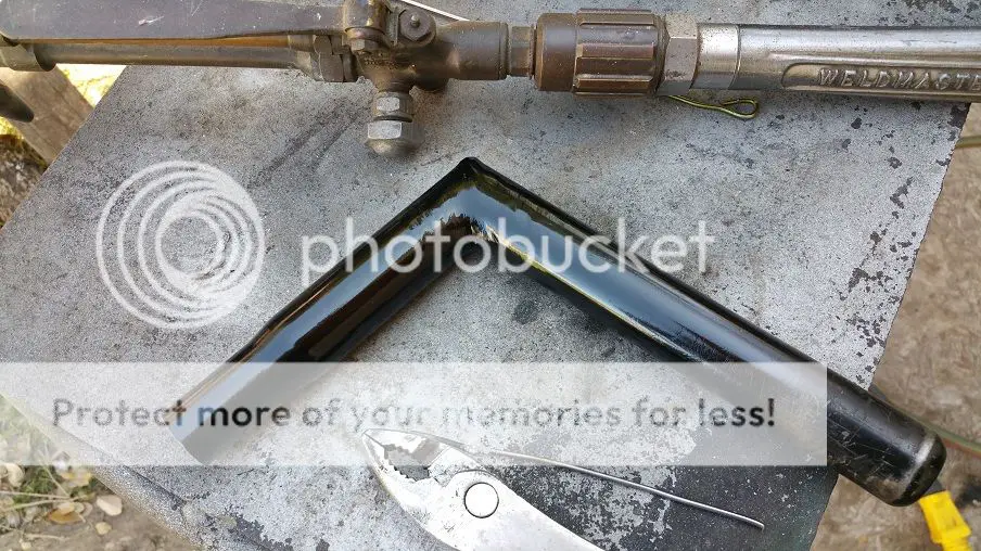

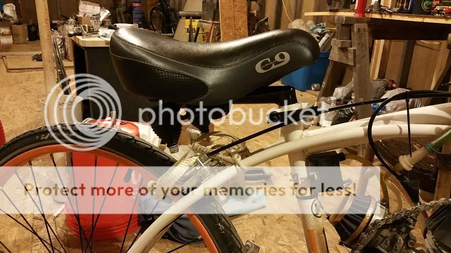

One of the things I got done today was I made up a laid back seat post out of the stock post on the Huffy Karaoke bike, been planning to do this for a long while since these frames are a tad short.
This make it feel so much better, set the seat back 4 1/2" and was able to lean the ape hanger bars back some for more comfort also, now when I get my new engine built for the Huffy its gonna be a real dream to ride.
I cut a large V in the post Shaft, bent it to where I wanted it, and then with a clothes hanger wire that I removed all the coating from, I used white Forney flux and my acetylene torch and mild steel brazed it all up and then slightly ground over the welded area just enough to smooth it out some.
Been a while since I did any torch welding with a clothes hanger so I enjoyed the process.

Good job on that seat post map... When I did mine up last summer I did it pretty much the same way but used a miter chop saw to cut the post at a 45 and welded it back together with the TIg welder, but I could feel it flexing when I was riding so I took it back off, stripped off the paint and welded in a brace that runs from the seat mount to about an inch down the post which made it feel a lot more rigid. I just made my brace out of 1" angle iron and so far it's held up to any abuse I've thrown it's way.

I been painting primer coat on the trim of my workshop today and then after slinging that paint brush in the 90+ Texas heat today Ive gone into the shop with a couple fans blowing and done a little work on "Taffy" as you suggested I call this bike.....lol!
Im thinking thats gonna be her name, yellow frame, black forks, hrome wheels, red balloon cruiser tires.....
Taffy works for this one....

welds dont have to be pretty to be good and strong, they just need to be done right with good penetration so the parts are fused together well.
Seen many shallow weak welds that looked real nice but failed when they got under pressure.
Thanks Dave, yeah I may need to brace this one also, I cant notice any flex when I sit on it but I may cut out two small triangular shapes and weld them on each side of the bend.
I used my 4 1/2" grinder with a 1/16" Dewalt cut-off disc and just cut through enough so that I could bend short section over until I had the angle I wanted and the I sewed it all up real good with the hanged rod, mine was cut completely in two so Im thinking by doing it the way I did it has retained a good bit of it strength, I really dont think it will ever fail on me, I may add the braces just for insurance factor.....lol
