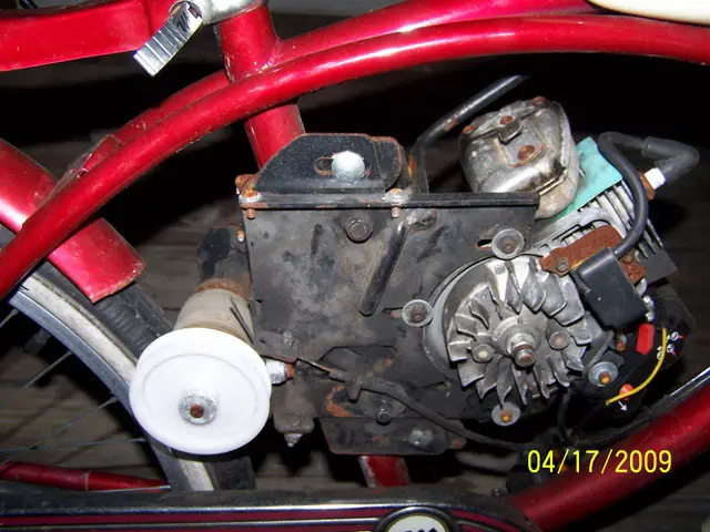

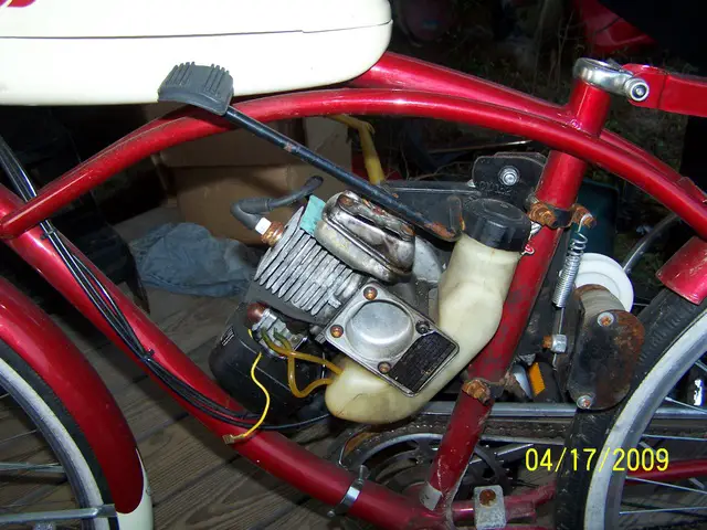

So far my weed wacker friction drives have used springs to pull the motor/roller down onto the tire.
On this new design, I rigged a lever that locks the roller up off the tire or down into the tire. Worked perfect first time! Just the right amount of force to not slip. I wasn't looking forward to hopping on and off the bike to fine-tune things with freezing fingers.
I've got pictures, but since it was a prototype (from plywood), you would probably consider it pretty cheesy looking.
OK, you talked me into it.
I already had this spare Mac motor mounted to a plate. The plywood "lever" is bolted to the motor plate at one end and there is a rod (bolt) that slides in the other end. When the rod is under the bike frame's top tube, the drive roller is held up off the tire. With the rod on top of the top tube, the roller is pressed down onto the tire. This worked good for my test, but when I do a real build, I'll figure out a better way to lock the friction drive on and off.
I could have cut the plywood into more of a handle shape but I didn't want to waste wood or time on a quick test. Plus I didn't want it to look like a product from an adult novelty store. I stole that joke from Cannonball2!
It ran really smooth. Since it's locked into place, the motor can't "bounce" at all with road or tire imperfections. Of course, spring-loaded frictions drives don't bounce much when they're designed right, but the springless design has advantages.
