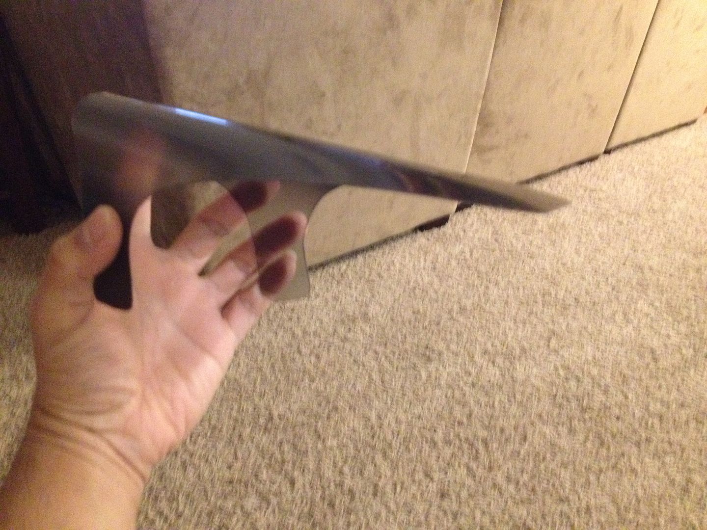

Made me a fender based of Mucky nutz. I used some privacy screen for an LCD monitor I had laying around. Still need to punch some holes in it to mount it.
