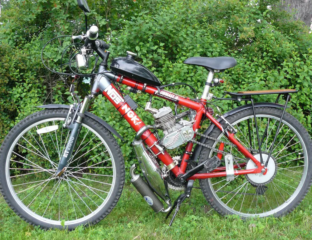

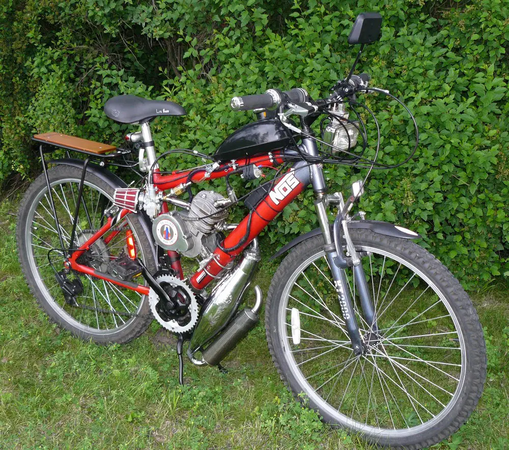

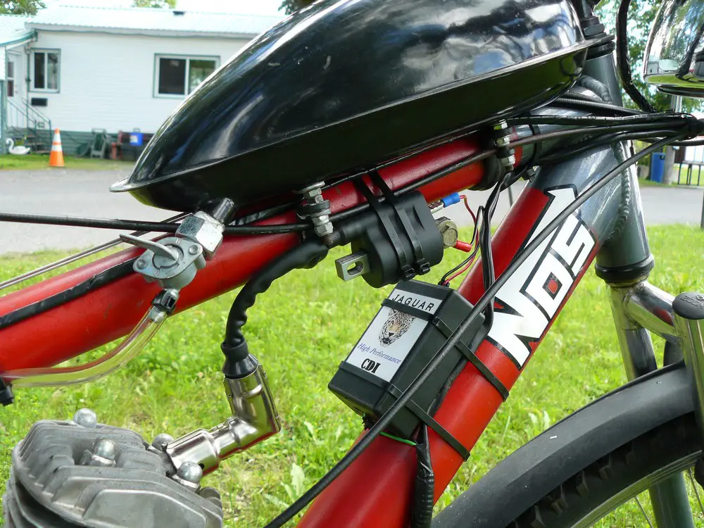

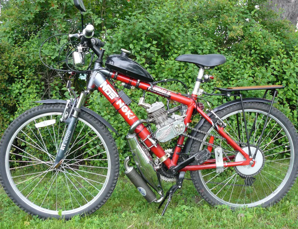

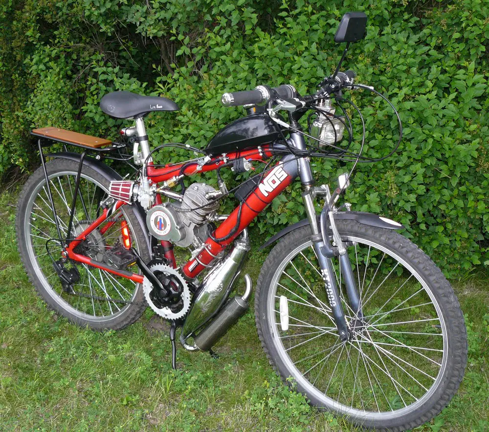

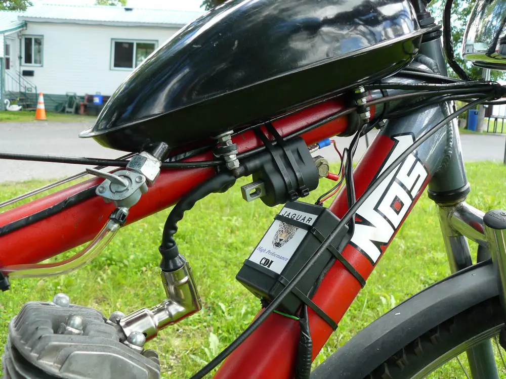

install a new jaguar kit and customized a leovince pipe

Re: what did you do to your motor bike today?
Pipe and bike overall looks really nice, can you actually tell any difference in how it runs with the Jaguar Ignition?
Some swear by it and others say it more snake oil than anything else, just curious if you notice a change in the way the engine runs.
By the way, be careful hopping up on curbs with that exhaust so low.....LOL! looks nice though for sure.
Happy Safe Riding always, Map.wee.
