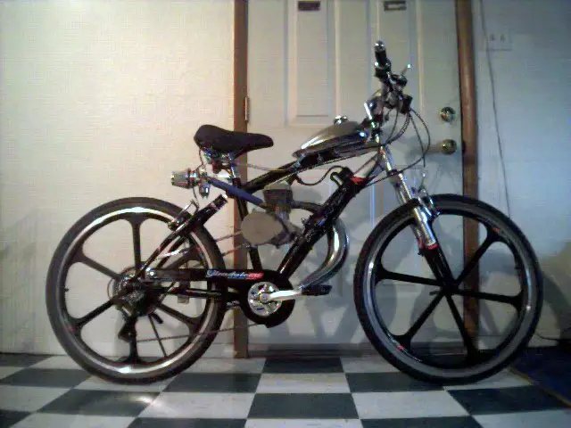

Someone crammed a HT engine and mag wheels into one of those!
http://motorbicycling.com/attachment.php?attachmentid=16988&d=1260128662
http://motorbicycling.com/showthread.php?t=8591&page=2

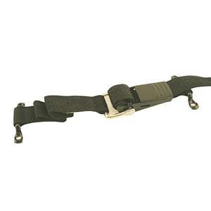

I have a couple ideas. Something like this, with METAL buckles! [url]http://www.armysurpluswarehouse.com/media/catalog/product/cache/1/image/b342046084682e8169617c955c259559/g/a/gasstrapfemale_1.jpg[/url]
[url]http://www.armysurpluswarehouse.com/rivet-style-gas-can-strap.html[/url]
[IMG]http://i00.i.aliimg.com/wsphoto/v0/449871082/NEW-Car-Seat-Belt-Seat-Belt-Extension-Extender-1-25MM-WIDE-BUCKLE-free-ship.jpg http://i00.i.aliimg.com/wsphoto/v0/...ion-Extender-1-25MM-WIDE-BUCKLE-free-ship.jpg
(extender shown, just plan to use old GMC belt, stitched together to make loop.
or an old seatbelt from a car ought to work. I bet I can get those from a junkyard here for cheap. I plan to weave it around the joints on the rack, and use a loop to tie the can down and cinch, and one to pull it back against the rack's ledge at the fork crown. I guess they can just sit in the cargo bucket when I don't need it. Lots of cool stuff in there. It holds a lot of burritos too!

its called a ""cam buckle lashing strap""
