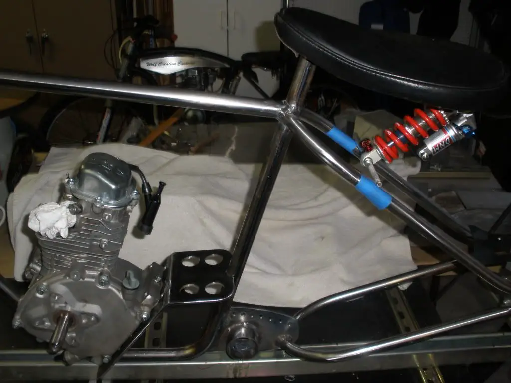

MBR: The frames will come with a gas tank & motor plate for the HF 6.5 or 212. I am sure the smaller motors will also fit. It will be setup to use the CVT or jack-shaft.
I tightened up the seat tube by 2 inches today; the original plan was to not use a lay-back seat post. After some thought it would be wise to add the seat-post to the customers taste.

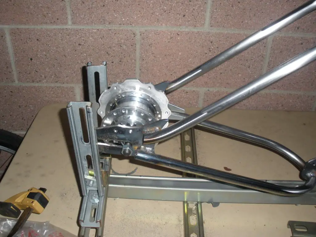

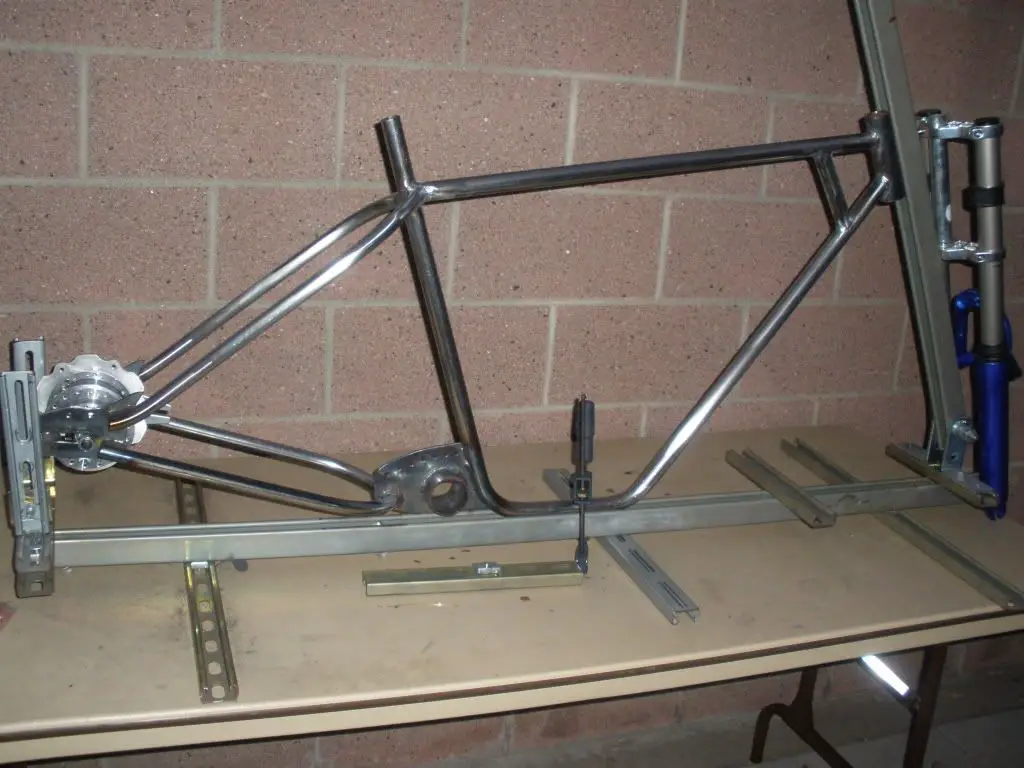

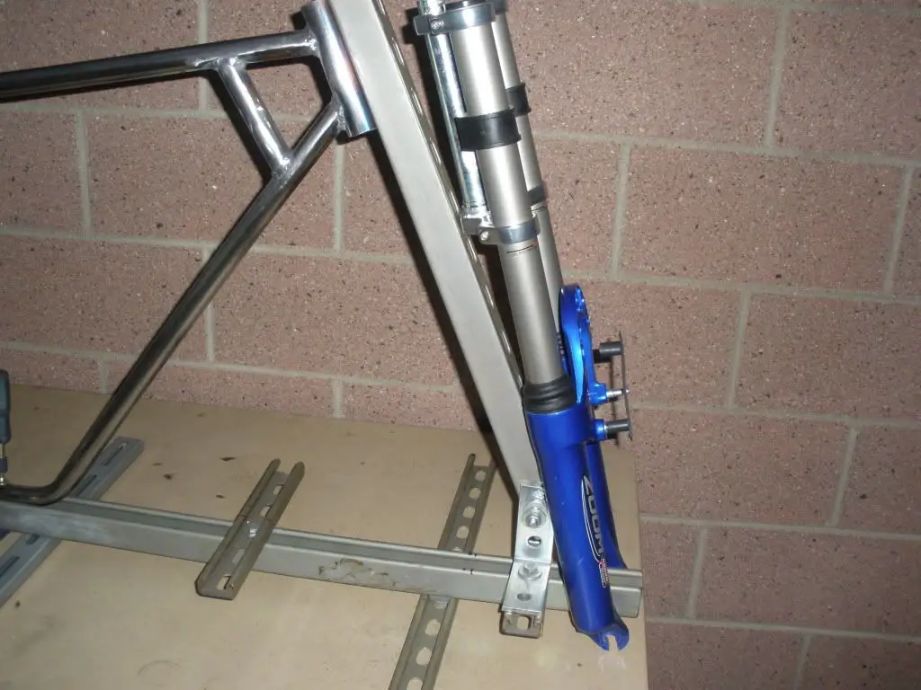

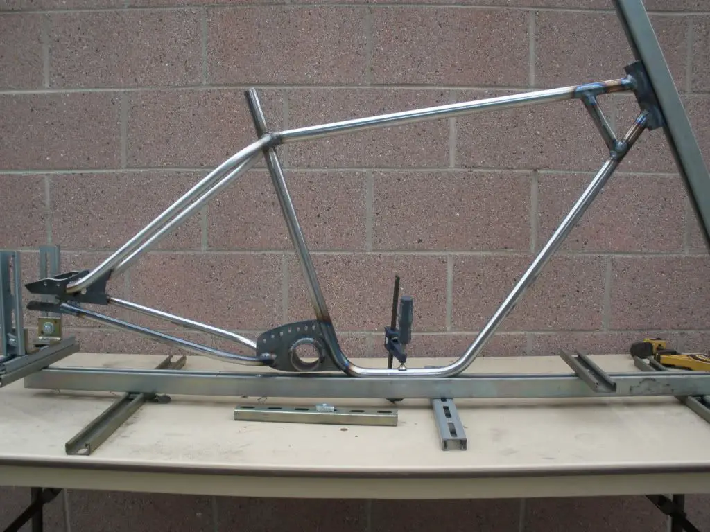

I completed the frame today...well completed with-out the motor mount that is. I still need to add a few gussets. It turned out nice...that el-cheap-o jig works real well.laff
I was planning to get the motor mount in this week end but the tig welder took another chit...Miller whats up....

stunningly stellar build. I love the way your cheap but highly effective jig makes sweet crank mountings like your style with 1/4" plate. Almost makes you think that the way that that was done you could make that be incorporated with a other rear structure for a shock. Love the build and that crank mounting. I've got a old frame I'm working on and just waiting on parts I'll deffinately be posting pics of my frame since I have that as my 2nd build.

Give me a break Dennis...big thanks for the lathe...it’s a challenge but I like it...the shocks are sweet too...not sure if it will work on the seat.

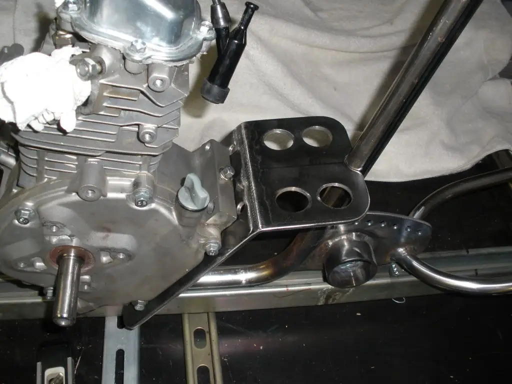

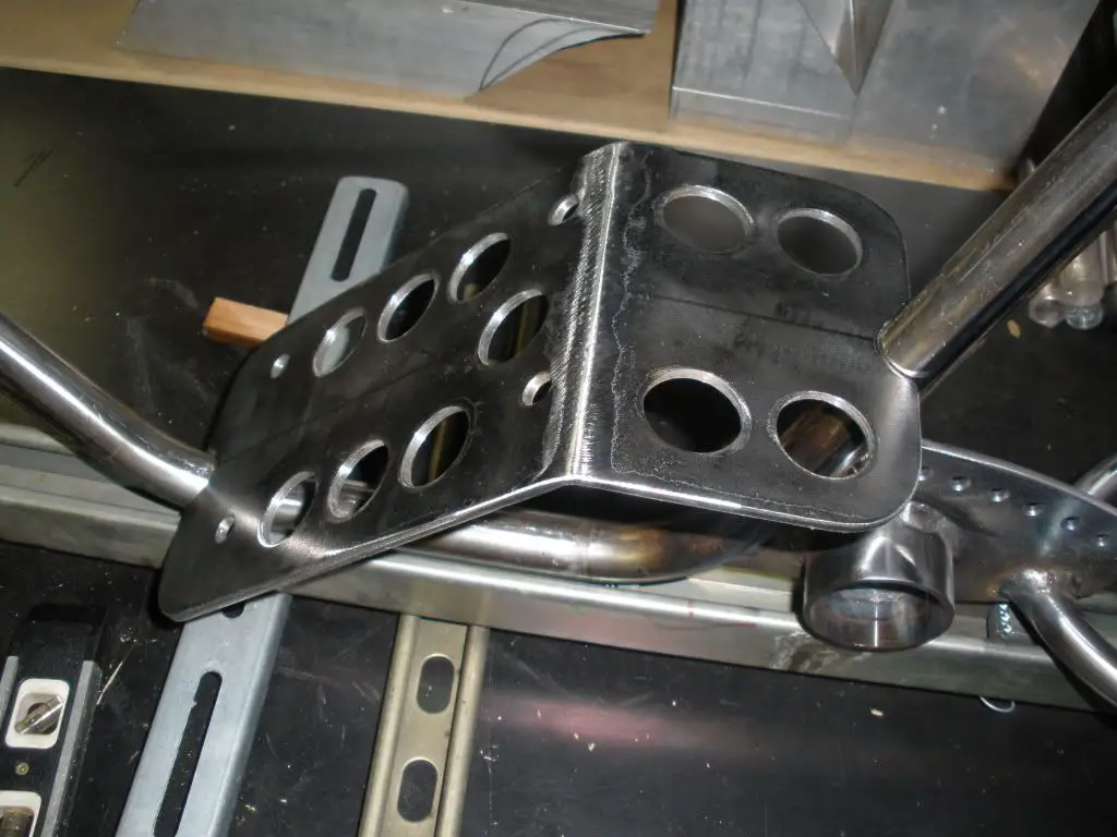

I made the main motor mount plate, it was heavy since it was made of 3/16 so I put it on a diet and drilled a lot of 1 1/8 holes. The motor sits low and forward. Under the plate will be my drive system.
