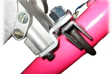

heres that mount. i roll a tube that the id is the same as the od of the downtube cut it in two weld the mount tab to it then clamp it to the frame with industrial nut clamps not the cheesy regular hose clamps. solid!!

down tube is 1.65 inches
seat tube is 1.4 inches
going to buy this adapter for the down tube because it fits 1.5 to 2 inch down tubes
ordering my engine tonight.
i'm going to lowes and buying some steel pipe
i will back the adapter with half a steel pipe so it wont bend my frame.

Definitely reenforce that SBP front mount with some steel tubing between the clamp and the bike frame. That style clamp is known to pinch and eventually shear aluminum frame tubing. Don't get me wrong, it's a very strong mount, it just needs to be massaged a bit to work decently with aluminum frames.

I recommend a section of thick wall tubing, not EMT conduit as it is too soft, that will fit nearly perfectly to the frame when cut lengthwise wise. You are making a clam shell type of adapter here.

Ya i know what your talking about
Like a pipe cut down the middle
Then you just lay the pipe over the frame.
So when the small U bolt is clamping it has more surface area so the aluminum does not crush from alot of pressure in 1 spot.
Makes alot of sense and I dont see many people doing it on aluminum frames but I will be.

I very much recommend Gearnut's suggestion w/any U bolt clamp on any bike, steel or aluminum - here's some I made for a shift kit's three rearmost clamps ("pads" later tack welded to the clamps), they've worked very well;
As for motorized aluminum bikes, as with anything I believe it depends on the bike's quality more than the material, specifically the welds and how well the motor has been installed.
While by no means a "top shelf" bike, my first build was a $200 Chinese Schwinn Aluminum Comp, purchased very much because it's beautiful welds & gusseting. While all the peripherals (crankset, shifters, derailleurs etc) have been somewhat annoying due to their low quality & constant maintenance & the single wall aluminum rims so soft as to be hazardous - the frame itself has put up with my abuses for well over seven thousand miles now;
I believe aluminum bikes make for fine motor candidates, the above only a problem as the motor didn't fit within the frame (prolly not an issue w/yers) - so long as care is taken to install the engine properly (no movement), refraining from drilling any additional holes in the frame and doing your best to minimize chafe (partic drive chain)...
That dang Schwinn o'mine jus' won't quit lol & the lessened weight makes for a nice, lively MB.

edit: missed the question of how I made the pads, sorry... they're jus' chunks of "black iron" pipe (typical thick walled mild steel) wthe same ID as my frame's OD, cut in half & ground down a hair to fit, then tack welded to the clamp;
