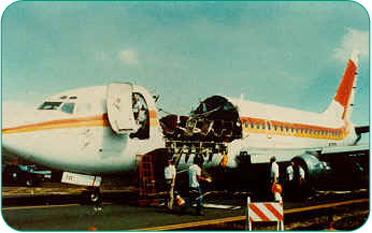

    Yeah just like the recent grounding of the 737 Quantus fleet from stress fractures behind the cockpit causing explosive decompression. LOL....
    http://www.ausbt.com.au/tags/explosive-decompression
    And this happened not too far back from stress fractures:
    [​IMG]
    AND THIS to Southwest Airlines 737:
    [​IMG]
    Not to mention the DeHaviland Comet which was the first jet airliner to be in service and grounded because of stress fractures that cause 2 of them to crash. BTW these incidents taught us about stress fractures that occur more readily in pressurized fuselages at high altitude and rewrote the book on aluminum tensile strength and its inherent weaknesses.
    The fact remains that aluminum is a good metal if used and maintained properly. But it also means that if you are going to use it in motorized bikes especially in a high stress area like a frame you darn well better understand its weakness and how to mount engines and other periphery in safe manners. Not listening to others with more experience is a recipe for failure and injury.
